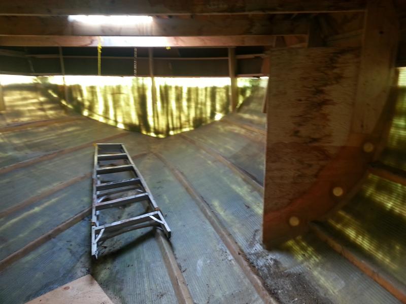

I am thinking taking on a project that it could be way to much to handle for me. So I thought this is the best place to start a conversation.
The first question would be did any of you build a Bruce Roberts 53 sailboat or does anyone has a rough idea how much it would cost to finish? Hull it is ready and is being given to me.

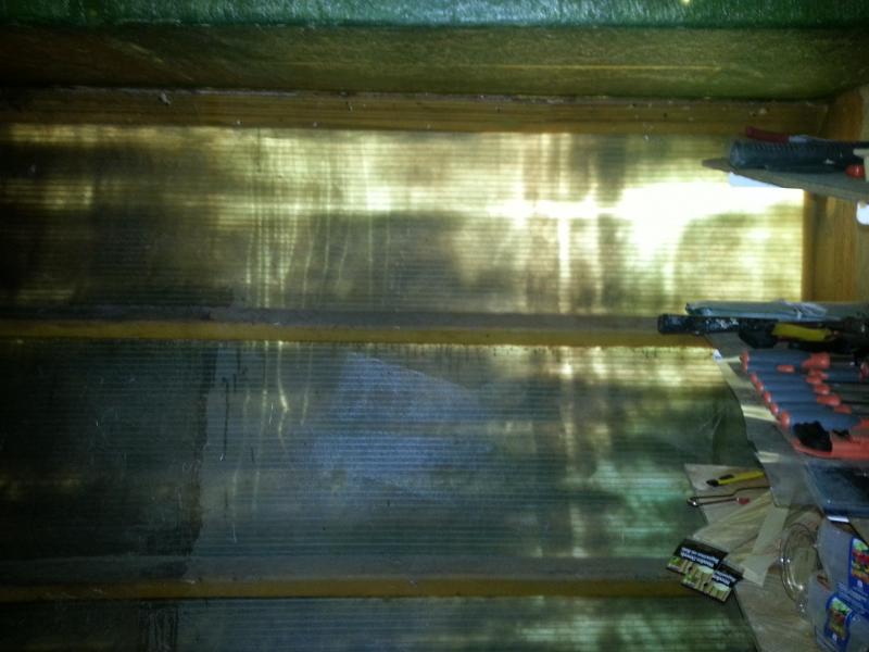

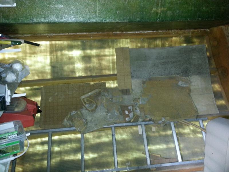

Second question would be is this a normal for a fiberglass hull? In the photos provided you could see through the light (Hull it is out on the sun) although it still needs the gell coat.

My guess a 53' boat would cost around 150,000 to 250,000 to build even if you do most of the work. Yes you may be able to do it for less but not likely in the end.
Light will pass thru raw fiberglass so what you see in the pictures is normal

With no gelcoat on it would easily show sunlight through it. My worry would be if the condition of the glass is still good and how old is it and has it been exposed to sunlight for extended time. Chief
8,155
How did this hull get created without gelcoat, which I've understood is the first layer in the mold? I suppose there are different ways to build just about anything but this makes me wonder how it was done.
13,064
"one-offs" are usually not built in a female mold. But it is curious. Usually you plank it with plywood then glass over. Glen-L sells this stuff that is reinforced fiberglass that you lay down like planks of wood. Maybe that is what was used.

Female molds usually have gel coat first, then glass. Male molds usually have gel applied but would not require a gel coat. Sounds like a male mold hull that should have had the gel coat applied when first done. Chief

1500 - 2500 hours labor, and about $200K USD in materials and equipment. That assumes you have the place, the tools, and the know how. There is a vast difference in boat carpentry and the "other" kinds of carpentry.
Your pics don't show it, but you may well be missing some structure (engine pads/runners, strut tube, etc, etc) that would be critical to the boat. ie, raw glass, in and of itself, is not very strong. I would be careful moving or turning, until you get some sort of strength members in place, either externally or internally.
And if you are lucky you may have a $100K boat when you are finished. Then there will be the getting insurance issue, and if you are serious about taking this on, you might want to check with some insurance brokers, beforehand.
