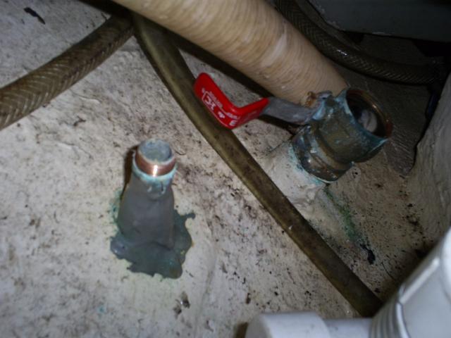

The JB welded "through hull" was a glassed in threaded pipe. It was done by the factory like that, it has no mushroom head.(the factory didn't JBweld it, but they glassed in a pipe) They put it in at an angle to the hull. I cut it out with a grinder/sander to prepare to install a real through hull. However since the hole is angled it seems easier to just glass this hole up and redrill a hole straight through the hull. There is another through hull that was done the same way;it is the sink drain. I think that one needs to be moved to make it easier to get to and away from the muffler so I will have more room for the backing plate.
It looks like I will be able to use the holes from the other 3 through hulls, raw water feed, marine AC, head pump out. But these two holes will need to be glassed in or plugged up.
What is the best way to fill in the holes? Do I need to feather out the outside and then fill it in with layers of cloth or can I just fill in the hole somehow?

Holy carp!! I would not feel even a littil bit comfortable with what I saw in your picture.

Got a picture of the outside of this thru-hull.
I am thinking why glass it over and create a worry point if it can be corrected by redrilling a real thruhull and sealing it or even using an oversized thru-hull and reducing it to your needs. The existing internal glassing can be ground parallel to the hull.
The hull is probably no thicker than 1/2" there. redrilling would be easy fill around and up sizing with a reducer would be less of a threat to me than a patched hole an another one drilled elsewhere.
I would sure rather use that hole than add a new one!

Landau, The through hull that is at an angle is a 1/2" pipe. I am installing a 3/4" through hull. I will try to drill that through first to see if I can go through the same hole. But the one for the sink drain is in a bad location because I can't get enough room for a backing plate with out ripping out the muffler pad that is glassed in. That one will have to be filled. I have vinyl ester to do the repairs. I have no doubts that it will suffice.
