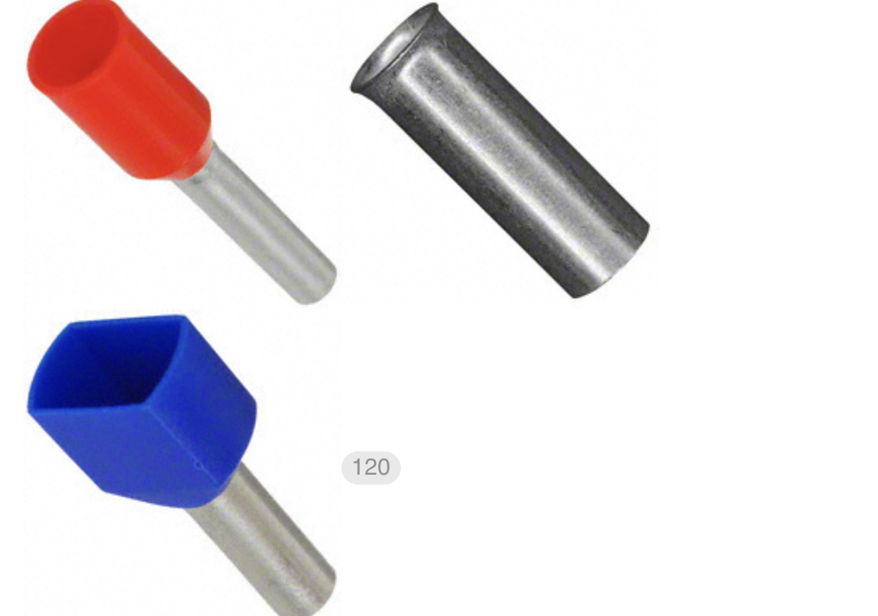

Ferrules are crimped wire ends (like ring terminals) that have a rod shaped end.

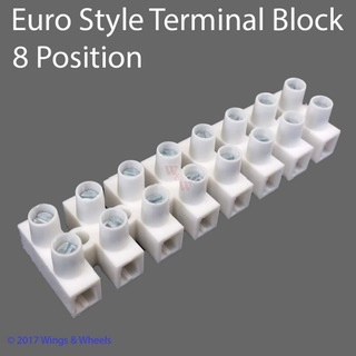

euro terminal strips are the ones you insert the bare wire (or ferrule) in the side and screw down from top to clamp the wire n place. ABYC requires this type of connection to use a plate to transfer clamping force, and not thescrew end directly on the wire.

Assuming the ferrules are properly sized for both the wire and the insulation and properly crimped on the wire, they do a good job of transferring bending strain to the insulated portion of the wire. If you've got some throwback style strip that screws directly to the wire without the clamping plate, they help protect the wire itself too.

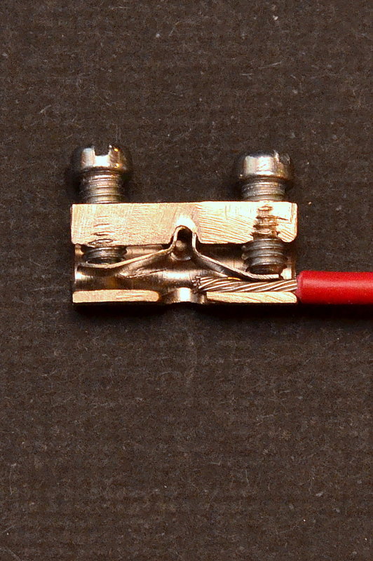

Good quality Euro strips are supposed to have a "pressure plate" that contacts the wire. A Euro strip with only screws (no pressure-plate) is disallowed under the ABYC standards. You also want to find a Eurostrip that uses nickel plated set screws and blocks (see below). Zinc plating holds up horribly in the marine environment and this is how most cheap Eurostrips are made...
Ferrules can help but do be very careful buying them as many are made of cheap aluminum and the crimping tools are often horrible quality. If not getting high quality tinned copper ferrules, and you don't have a high quality ferrule crimper, you're better off just using a well made Eurostrip that is built to a marrine standard using nickel plating and that has a pressure plate.
This is what a good quality Eurostrip looks like when cut in half. Note the screw does not directly impinge on the finely stranded wire.
