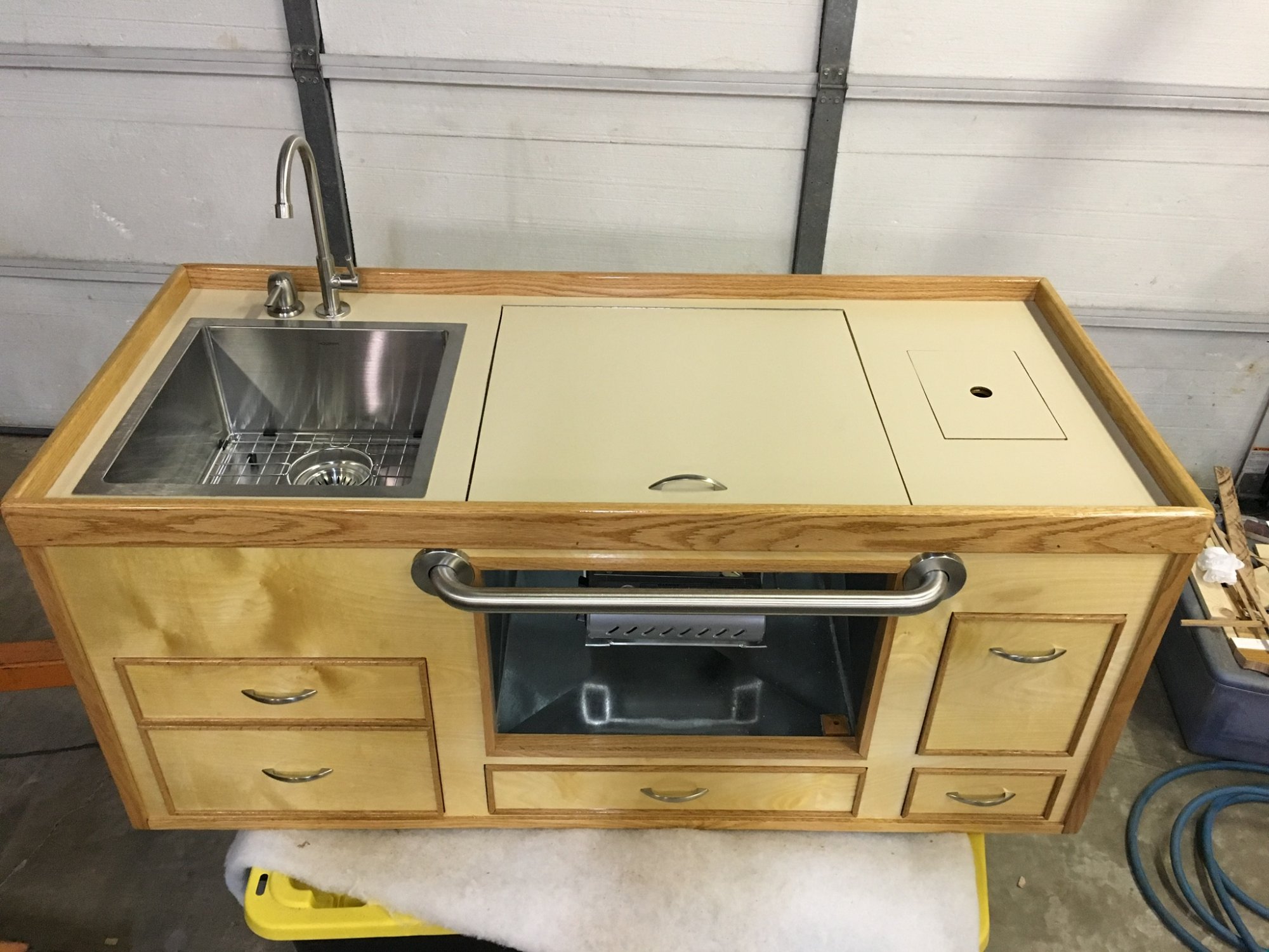

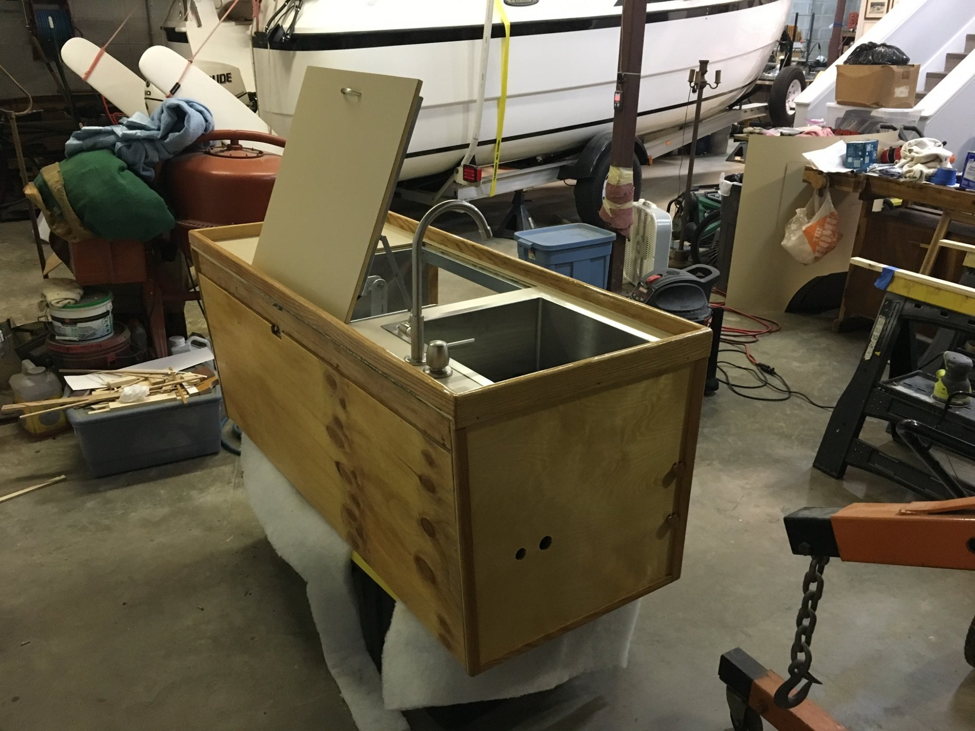

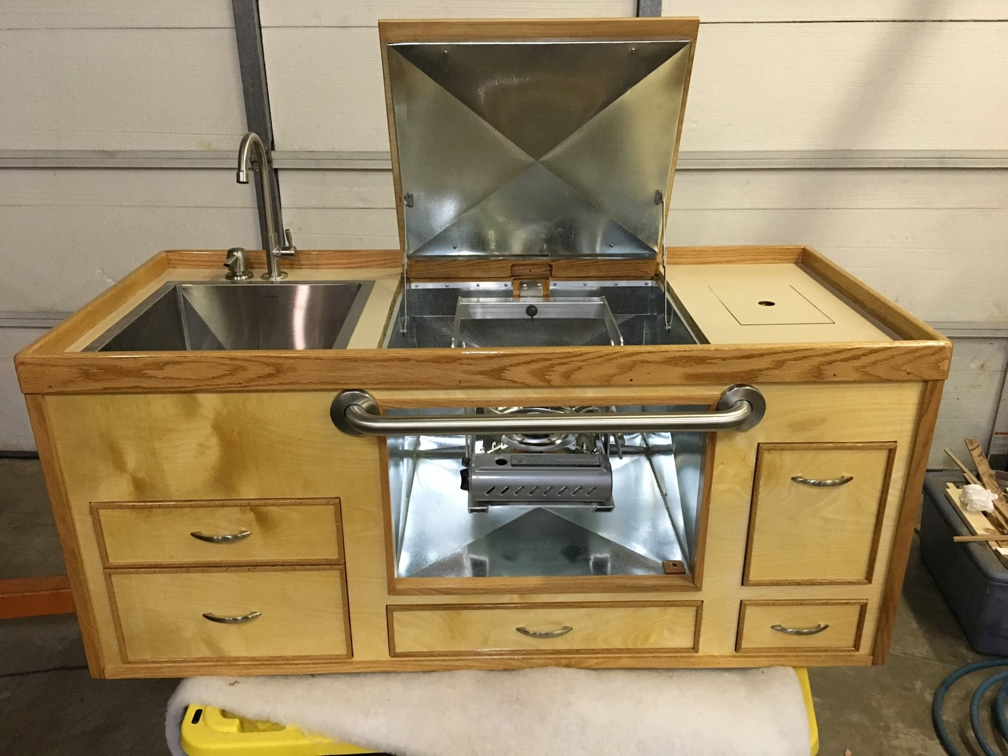

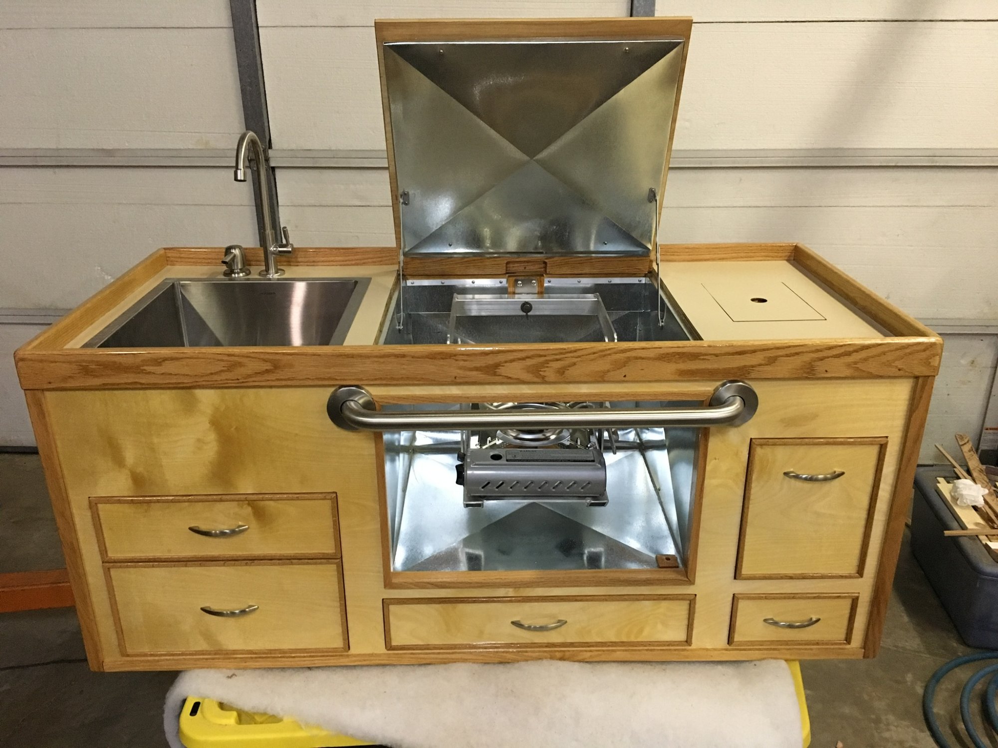

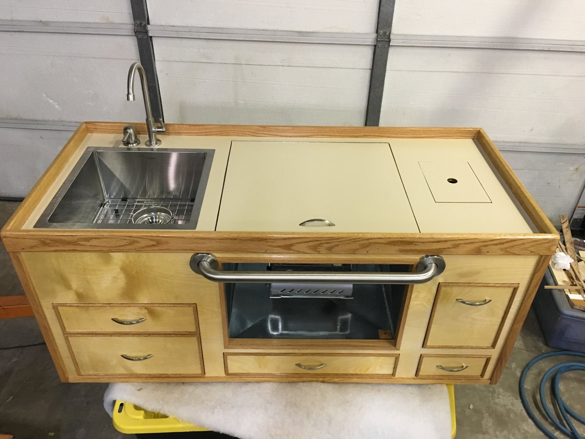

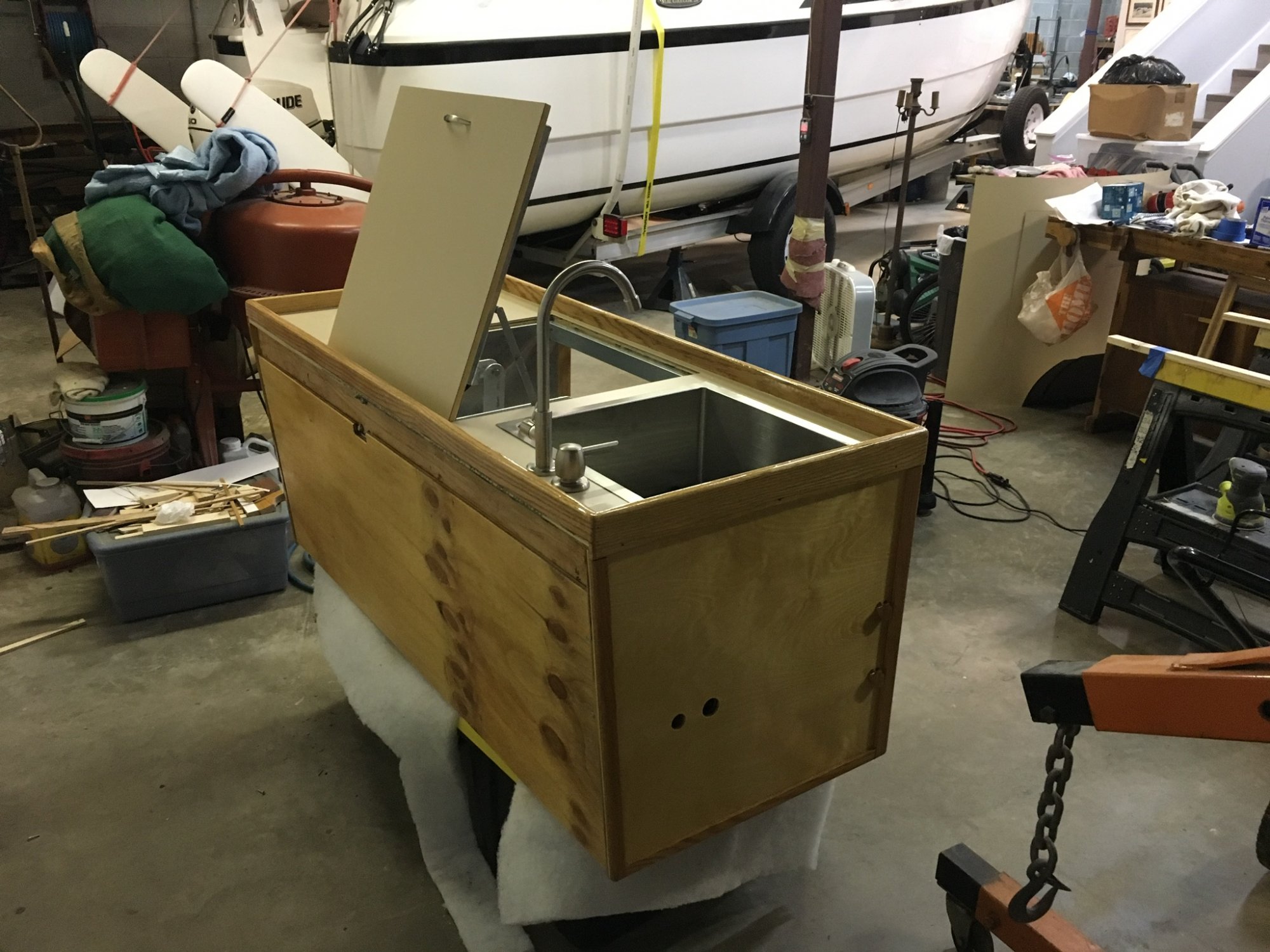

The galley on mine did not come with the optional flush mount Origo.  So I just finished building a slightly improved galley for mine.  Hoping to do some extended camping in mine, so trying to make it a little nicer inside.
View attachment 186394View attachment 186395View attachment 186396
