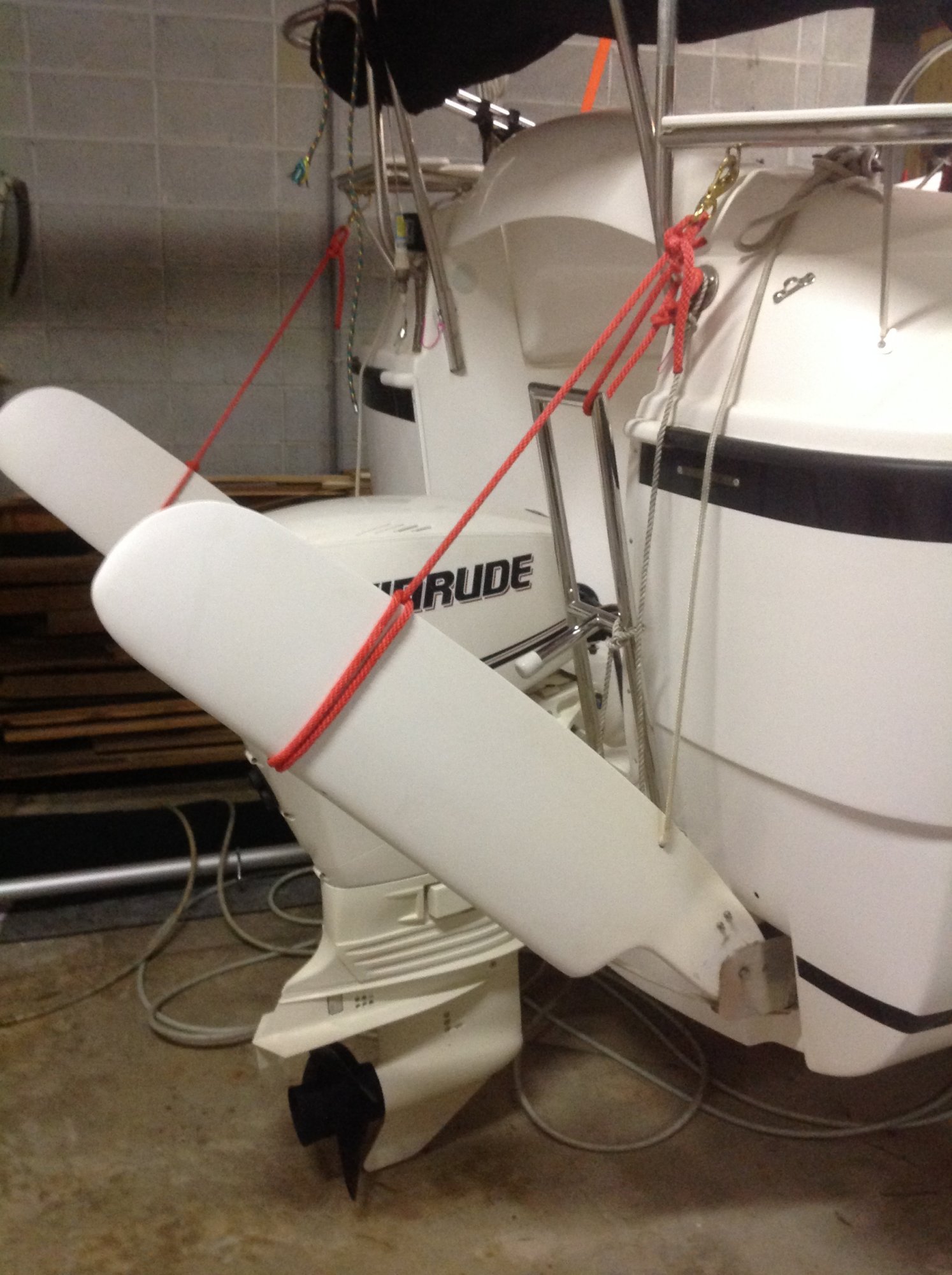

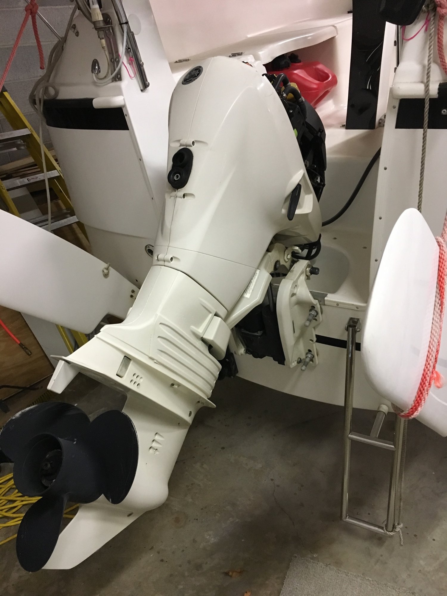

So probably 350-400 lbs of motor and a big hole in $10K ! I can see why you would choose 60hp! :)
YOWZAH! The other issue is powerhead size. Swim ladder is on the stern and the M helm seat is over the powerhead. So, swim access can be an issue with a big powerhead. A big powerhead won't tilt all the way up with the stock helm seat down. So, you can be left dragging the foot, or removing the helm seat. With my sailing skills, I certainly don't need to drag half an outboard behind the boat.
Full disclosure: the 60 was on the boat when I bought it. The claims that a 50hp will do 20 mph are overstated in my opinion, but I didn't know that when I was shopping. Just dumb luck that the boat I found had a 60. I wouldn't go much bigger on a repower though. It's plenty fast for the way I use it. I am disappointed that BRP quit making them, though. I hope parts and tech support will be around for awhile.
