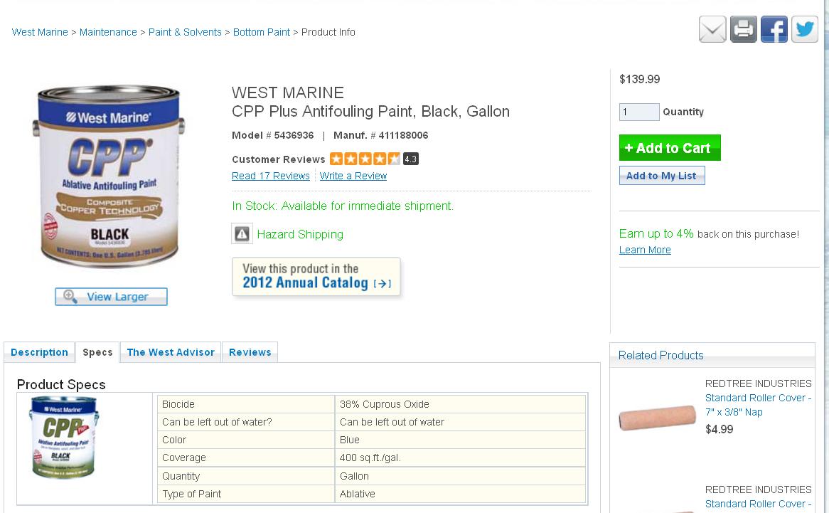

I'm impressed that you're getting seven years from West Marine paint which I'm assuming is:
I 'm into my fourth year after applying two coats back in 2012. I was fully prepared to bottom paint this year and I still had complete coverage and only some algae. Previously, I had faithfully applied blue Micron CSC every two years when showing the first signs of wear through (showing the innermost black coat). I decided to use the CPP when CSC was up to $220.00/ gal. but with these results, it's CPP at any cost. Let's see if I can beat your seven years. This isn't the case everywhere but here in the PSW (your PNW), it works.

I can only say that CPP seems to be a harder ablative (lasts longer) and keeps the growth at bay as long as it's present. You're in our back yard so you should get similar results to Terry and myself.

Thanks Terry & Ralph. West Marine CPP it is. I'm not sure I'm up for applying the paint. Maybe when I'm retired and have a bit more time.

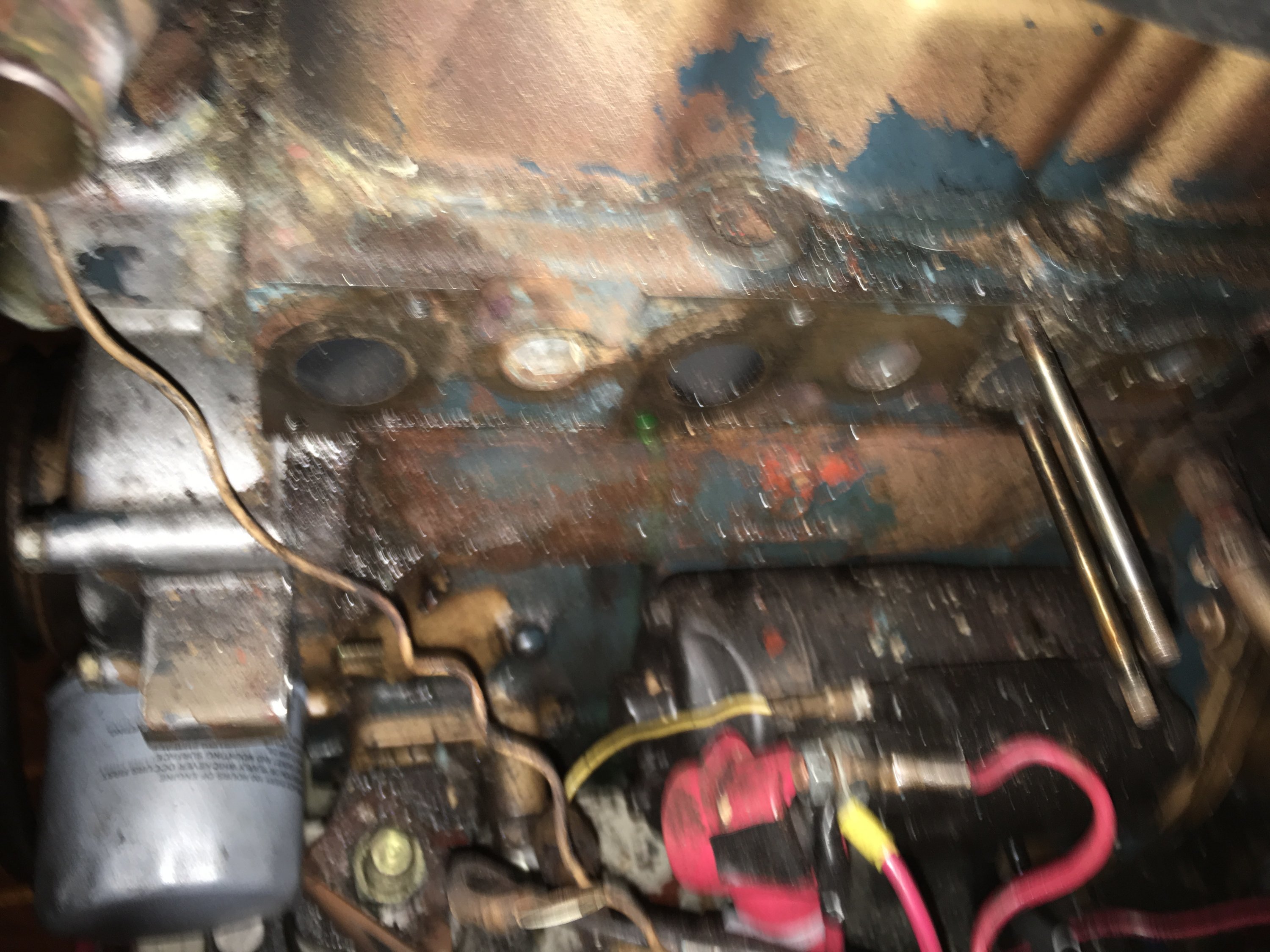

The new alternator bracket hangs off 4 new longer exhaust manifold studs (6 studs hold it to the block). I'm hoping I can pull the studs without pulling the manifold & elbow and and and. This is a "required" fix for the M25, it hasn't yet been done and the PO broke the timing cover filling the bilge with oil but shut down before engine damage. The under floor still weeps oil to the bilge occasionally so I have lots of absorbent pads down there. Full details on the rebuild are on Main Sail's site.

Got the studs out today. Yeah they didn't break in the block. At least one is wet so I need to investigate what sealant to use on threads. Now have to wait till gaskets show up. In mean time I'll paint the manifold and new brackets universal gold. Maybe clean up block and paint some of the block. I pulled the heat exchanger and it looks freshly cleaned (just like the po claimed).

Haven't made too much progress on the alternator bracket - I did order a LN - alternator and external regulator kit that Main Sail recommended. I'm going to try and get up to the boat tonight and remove the thermostat housing - see how bad it looks for the broken studs. (again I didn't break them -- the boat came that way).

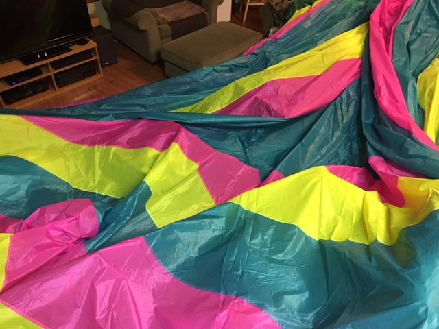

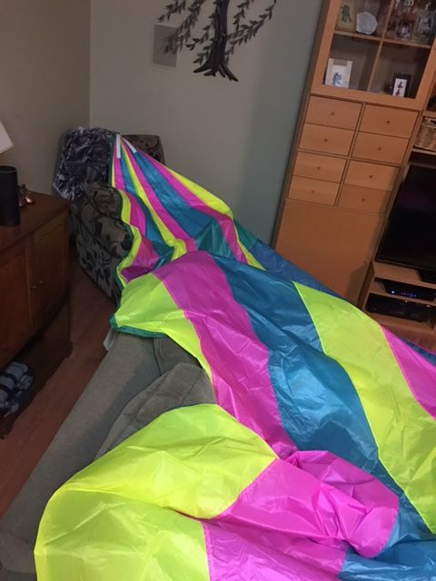

The boat's Xmas present came yesterday - all the way from Hong Kong - HK Sail Makers. 982 Sq Ft of fun. Can't wait to try it out.
US$1,056.00
luff=44.64'
leech=41.7' foot=25.86''
area
982 ft2 - tri-radial cut
Fibermax 44 ( 0.75 US oz ) Challenge nylon
asymmetrical
