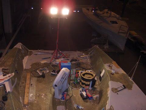

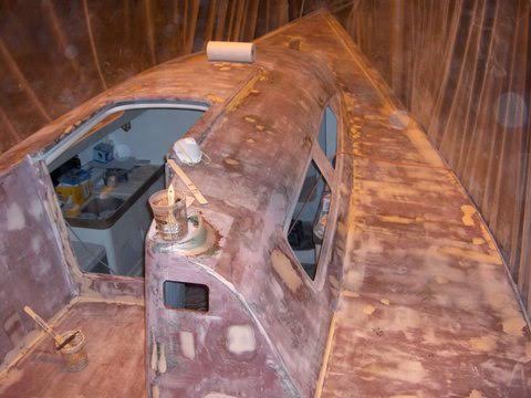

Our son had one. Was a popular class boat on the Great Lakes. Fast boat. He had to peel off the entire hull skin and relaminate the core because of how the hull was constructed allowing moisture to permeate the core. Large areas of the deck as well.

Yikes! I am told this boat had that done already. Is the repair durable?
If the core was rotted and then repaired properly, you will have a great boat to race. The work done on our son's boat made it better than any of the originals which left the 'factory'. No reason to think it wouldn't be permanent unless the work didn't include the entire hull or deck.
These boats were crap when new but survivors which have been fixed are great racers.
