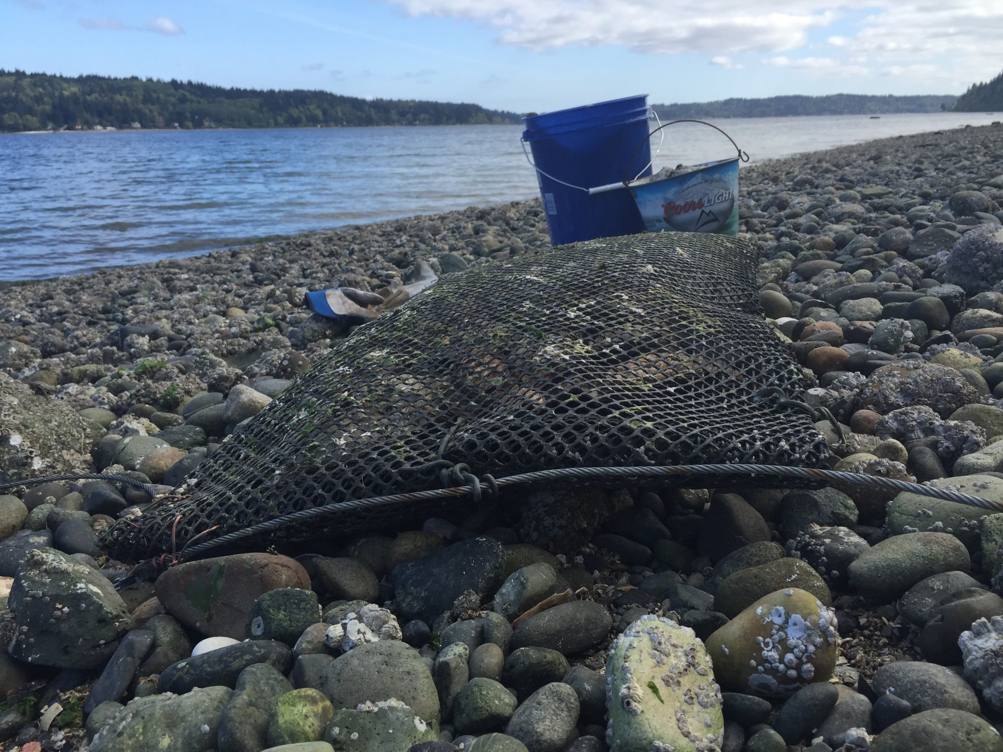

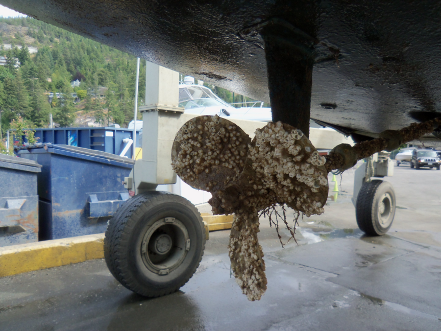

In December 2020 we had Micron CRC installed on a new to us sailboat at an Anacortes WA yard which they recommended. It was a singe coat as I recall, which seemed odd but they are the pros know this stuff (I guess). They did caution us that what works in their waters may not work in Central Puget Sound and this was good for 2 years.
I had the bottom cleaned in May 2022 and the diver indicated it seemed pretty good but there were some small barnacles starting which he dealt with. Now the boat is being day sailed regularly off my mooring where the boat rolls around a bit changes orientation to the beach with tide/wind, and there are lots of small barnacles on the rudder sides and within 1"-3" of the waterline. I am able to scrape these, but it's pretty obvious the CRC was a failure for 2-year life.
I found this post: Puget Sound Bottom Paint and will study it before the next painting session which seems like it needs to be in the Fall or maybe I can delay to Spring 2023 with some diver cleanup over the winter.
I'm assuming there is no magic solution to this issue other than my scraping until having the boat painted.

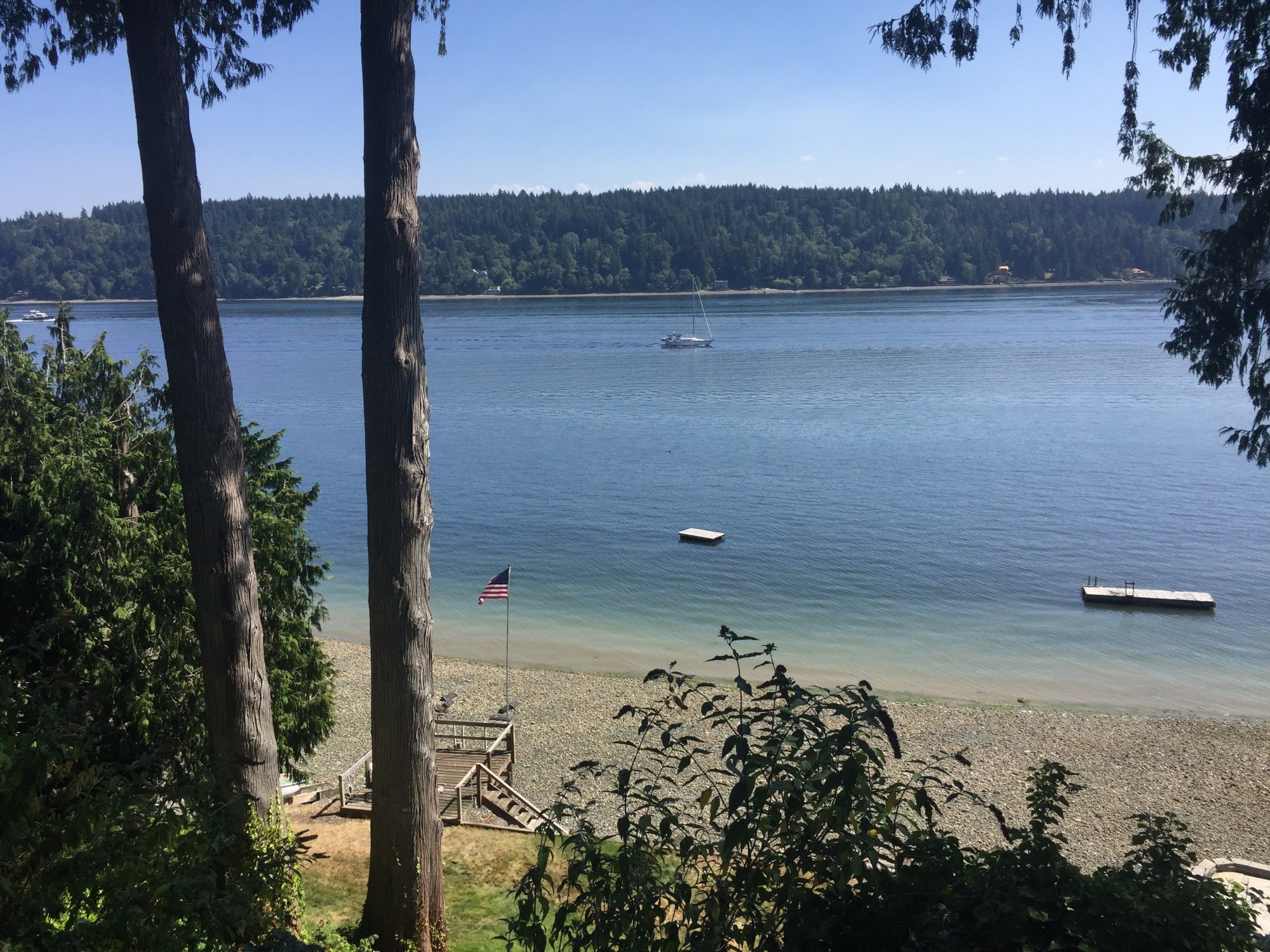

Regrading painting, has anyone ever intentionally used the tide and their beach to simply "lay the boat" over and paint where needed during the tide change? This would not be a long-term paint job, but might be a solution to my current issues? My beach is not ideal, meaning soft sand. It's more of the normal cobble so some padding (carpet ?) would be needed as the boat settles on its side.
overview of "work area".
Any thoughts on this would be welcome.

What you proposed doing is called careening. It is a time honored practice in areas with large tidal ranges.
As for your situation I'm not sure all the prep work necessary to safely careen your boat would be less effort than scraping or getting a short haul and slapping a quick coat of paint near the waterline.
Anti fouling effectiveness varies with locale. Somewhat counter intuitively areas with stagnant water will have less growth than areas with good water flow. Stagnant or slow moving water is not rich in nutrients which moving water is. The nutrients support growth. Moving water also wears away ablative paint faster than stagnant or slow moving water. Micron CSC is a soft ablative paint. Scraping and cleaning will accelerate paint wearing off leading to more growth. It is a viscous cycle.

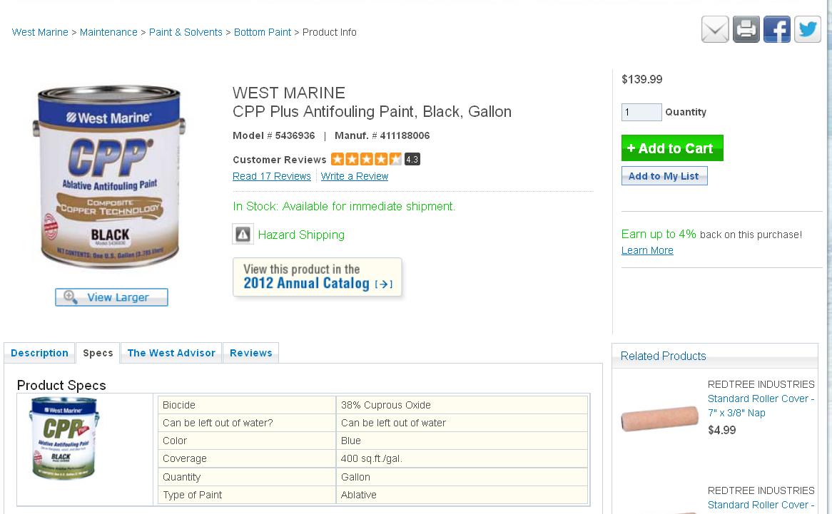

I got sick of the obscene price of Micron CSC and changed over to west Marine CPP Plus:
Every bit as good as Micron at 1/2 the price. The lesson learned here was to ALWAYS apply two coats and avoid having to repeat every two years with the cost of the haul out.
Take a look in the archives under bottom coat and you'll find some interesting info.
Remember, this is for MY area. Results may vary in YOUR area, or not.

Tide range at my home is in the 12' range - occasionally as much as 16'. Plenty given the 5.5' draft, but no seawall at high-tide, so it would need to be a lay-down setup. Tidal grids are a thing of the past in Puget Sound.
Interesting about being illegal. https://pugetsoundkeeper.org/wp-content/uploads/2017/11/2017-Boaters-Guide.pdf) Since I would just paint what I have and not do any washing, prep or other steps that would be nasty stuff - which I certainly don't want since I eat the oysters off my beach - I believe I would be fine. That said, the prep for lay-over does probably exceed the time of just scraping the barnacles when needed until a haul-out over the winter can be scheduled.
