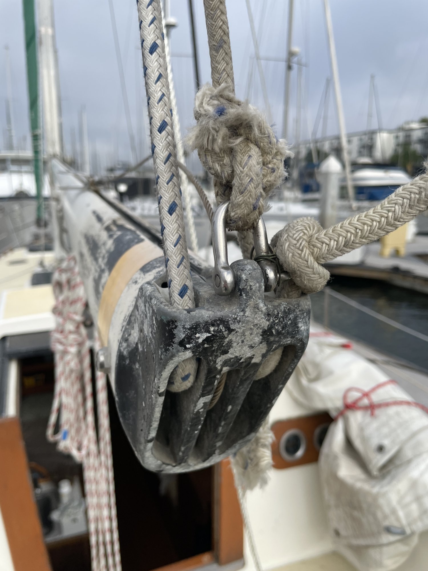

Actually i dont know for sure. Looking at pics now to try and find out. I know the topping lift was an original part of the rigging but how it was originally rigged is a good question. I would love to have that second line for reefing There is an attachment point at the end of the boom. Right now it has a shackle attached to a length of rope through a block that runs back through the boom to the mast. I will be climbing the mast this weekend. I'm curious where the other end goes.

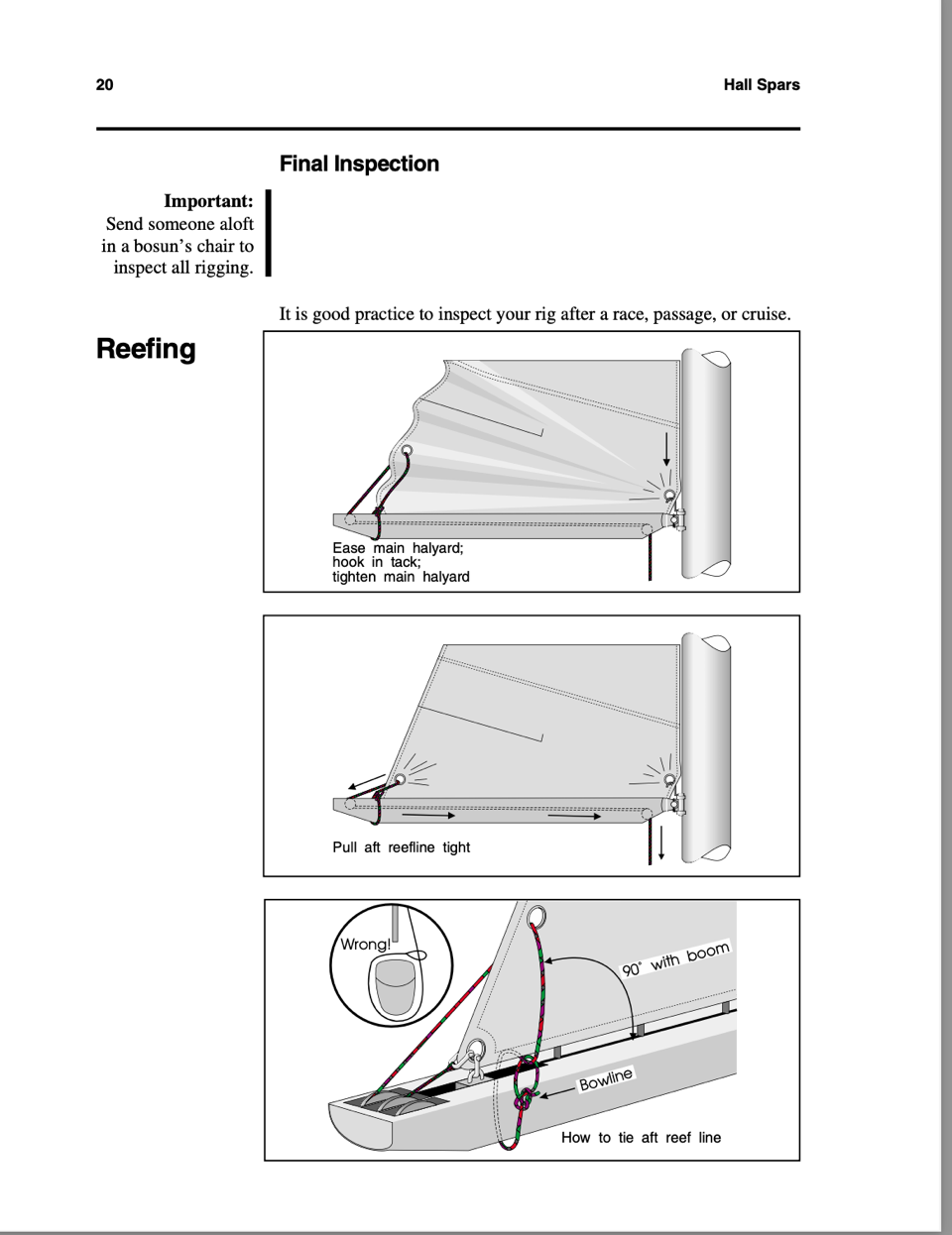

First Reef, out haul, Second Reef. Topping lift to the eye.
If you have a loose footed main, this is how you tie the reef line. From the turning block the line goes up the sail on the same side as the block, through the reef crinkle and down the sail and under the sail and over the boom, the around the bottom of the boom and back up. A bowline around the part that comes down the sail is tied so that the loop of the bowline is even with the side of the boom.

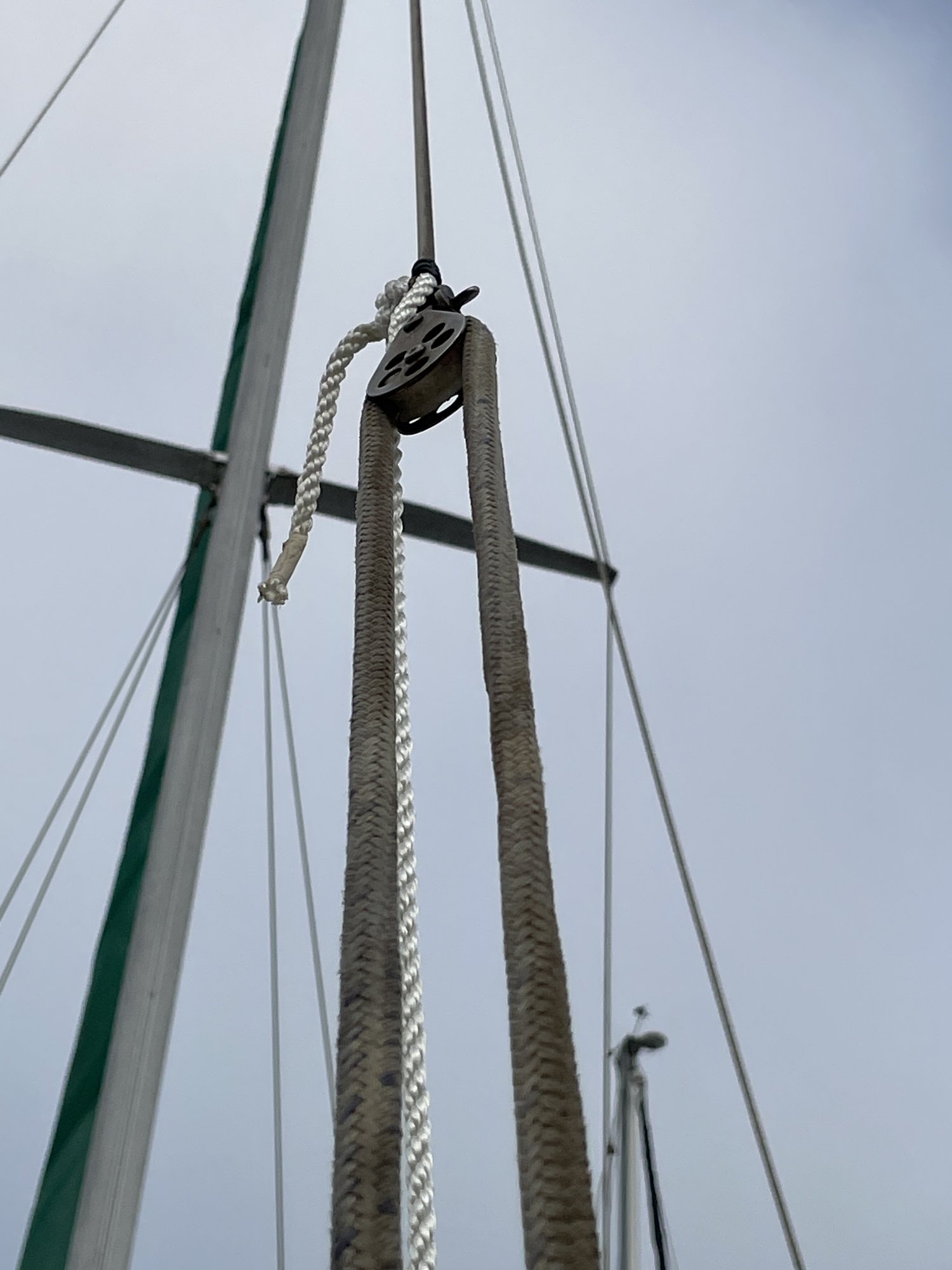

The only thing im not sure of is if the topping lift is spiced onto a piece of rope to come out the bottom of the mast somewhere. I have internal halyards and im embarrased to admit i have not sailed in so long on my boat, i cant tell you if the topping lift exits the bottom of the mast anywhere for adjustment, or if it is terminated somewhere at the top of the mast? It is a wire cable, not rope. As far as i know there is only a jib and main halyard coming out the base of the mast. I will have to double check next time im at the boat. I might have to run a new rope halyard inside the mast to change my current arrangement.
Also, the pictured reefing arrangement you just posted implies that i would need to un-cleat the two reefing lines when raising the mainsail all the way up?. That wouldnt be hard to do. There are two cam cleats for those two lines at the mast end of the boom. I would just have to get in the habit of remembering to do this if i dropped the mainsail while it was reefed.

There are many ways to skin a cat or rig a boat. A really simple and relatively inexpensive way to rig a topping lift is to have a single line (3/16" dynema would work well) from the top of the mast to a few feet from the end of the boom. Bridge the gap between the topping lift and the boom with a small tackle to allow for adjusting the boom height and slacking the topping lift when sailing. A fiddle block with a cam cleat, a single block with a becket and some ¼" dacron line and you're all set.
I have the reefing system I referenced. When you leave the sail reefed you remember to release the line real quick the next time you raise the main.

Thanks. I will have to think about this more and try and figure out how to rig this on my boat. From the few pictures i have found on the web, it appears the setup i have now was how it was originally done. Even old pics of my boat model (other owners/boats) show a block arrangement on the end of the topping lift similar to mine. I'm pretty sure now the topping lift cable is attached and dead ends at the top of the mast. Should not be too hard to convert. I just need to learn a bit more about how the different blocks work.
For this application you'll want a fiddle block, these have the 2 sheaves vertically aligned and are less prone to twisting than a double block with blocks aligned horizontally. A 3:1 purchase will probably be fine.
Nov 6, 2020
573
Mariner 36 California
Garhauer has double blocks with a cam cleat. Its 4:1 but small 2" dia blocks. I'm thinking this might be an option. I dont think the cleat would be too high to release from the cockpit. I dont know if the fact it swivels would be an issue though. Im thinking the cam cleat would be at the top attached to the cable thats already in place now.
14,053
That would work. Mount the fiddle with the cleat on the boom, it will be easy to release as gravity will work with you. Might be a bit more of a challenge to cleat the topping lift depending on the height of the boom, doable I'm pretty certain.
