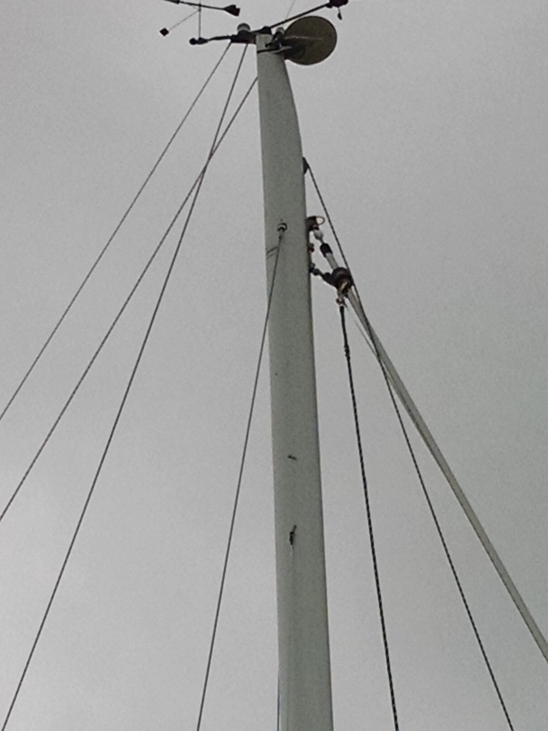

Agree. See the pic. Ours exits the mast about 6 inches +/- above the top of the forestay (and hounds). You get much higher you are asking for the top of the stick to get ripped off in a blow.

Mine's quite high above the forestay, maybe 18-20 inches, but I'm hyper-vigilant about what the winds are doing. Needed room for the sock to clear the furler.

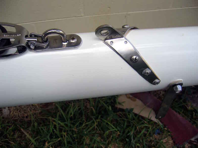

Back to OPs question, to attach an external block as a fractional spin sheave, these are two most common techniques. The strap-based one on the right is MUCH more secure. The pad on the left relies on a flat forward section of the spar
Absolutely, the pad eye is relying on the screw threads to hold the pad eye to the mast, at best with a ¼ -20 screw there will be 4 or 5 threads holding things together, unless they somehow the bolts were through bolted. Once the sail is up and full, the sail will be trying to pull the bolts out of the mast. Not much surface area on the threads to hold it together.
The strap puts the tension in shear across 6 bolts. Instead of supporting the load, the bolt threads just keep the bolt attached to the mast. The sail will be putting pressure across the diameter of the bolt and not on the threads.

Thanks for the replies, I didn't consider the unsupported load. I will place it about 8-12 inches above the fore stay. The masthound pictured on the right is the same one I was thinking of. This will be a winter project. Need to have the yard lower my mast. I'm not courageous enough to scale the mast.
These guys know their stuff. They have given you spot on info. The Masthound is how I designed attachement for my fractional trailer sailer to accommodate an asymmetrical spinnaker. Worked great. As Dave indicated it is the way that the forces will be pulling on your mast. The Masthound solves that problem. The threaded screws can be sized so that when in the mast they do not interfere with any in mast lines or wires.
