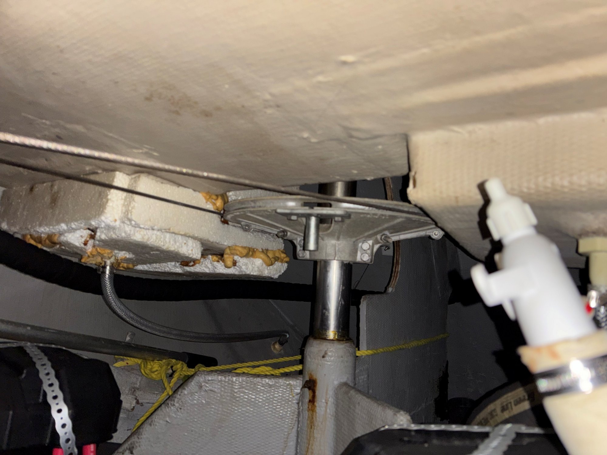

The surveyor made a recommendation that there should be stops at the 36 degrees either side of center for the rudder stops. You can see the pin on the quadrant in the picture (apologies again if there are multiples). I was thinking i might remove the pin and likely cut it down a bit and then mount it on the top. Doing this would make it possible to mount something on the bottom of the cockpit sole. I would likely use a suitable adhesive and some kind of track arrangement to allow adjustment of the stop. I am wondering if anyone out there has knowledge of how it was actually done on the Express 35'?

I can not identify the quadrant structure, to see its rotation, and the limits that should be in place in the image.
That being said, you do want to have stops to limit the amount of rotation for the rudder. At some point of rotation, the rudder becomes ineffective at turning the boat. At 90º, the rudder becomes a flat board in the water stream. The rudder post and the rudder construction are not designed to manage the forces in that configuration and can be snapped off. The stops are designed to prevent that from happening.

That pin is puzzling. We had an Edson quadrant on a previous boat. The pin was covered in rubber and mounted on the top of the quadrant instead of the bottom. The cockpit sole had a couple of fiberglass or wood beams as the stops. The stops definitely need to be strongly attached to the sole. I think ours were through-bolted to the binnacle guard rail hold-downs.

Yes, it is puzzling and I would much rather have it on the top. There is very little clearance between the cockpit sole and the top of the quadrant though - approximately 1 3/32", AND, the quadrant stop holes are threaded and do not go through, and that is why I would rather not mess with it. I am thinking of a triangular arrangement with the quadrant side being circular in shape to match the quadrant curvature as close as practical. An inch thick plywood possibly with a steel or aluminum band 1/8" thick with holes drilled appropriately to mount a block with urethane coating or such for damping....

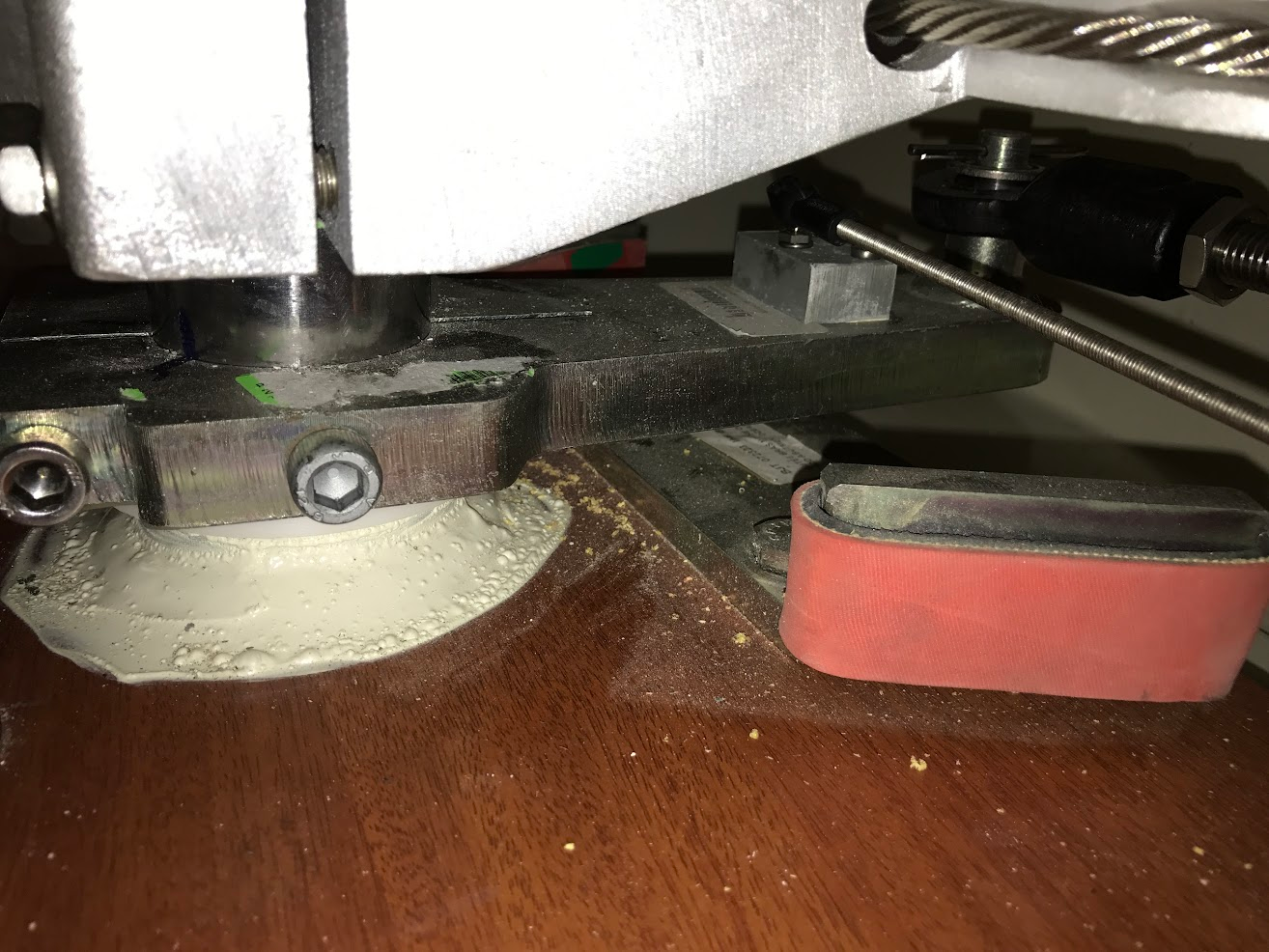

The other option is to attach a separate arm to the post, like a below deck autopilot arm would use. That’s how the stop works on our current boat - the autopilot connects to an arm bolted onto the post, and there’s a large metal bracket mounted just below that arm to limit the range of the arm. The metal bracket has rubber bumpers on it. This picture shows that a bit - the quadrant is at the very top of the picture. The autopilot arm is in the center of the picture, with the red rubber on the metal stops, bolted to a wood mounting panel just below that. I think the wood spans between two traverse bulkheads and is attached to them on the sides.
  • Helpful

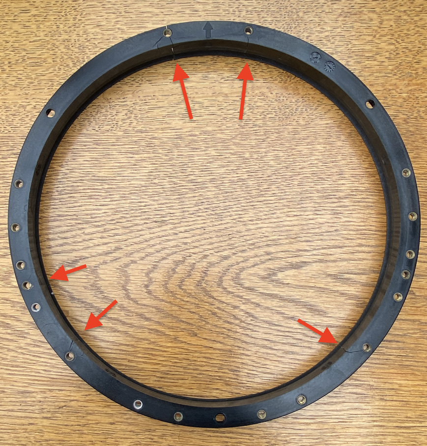

@jag55, you mention "chattering". There are a couple of possibilities for that experience. Both require attention to the inner workings of the wheel parts of the 4000+.
Mine did that type of behaviour right before it failed.
In my case, the "Drive Ring" was failing. Here is the unit when I removed it. You can see the cracks that formed in the plastic around the threaded rivetnuts in the ring. Replacement was the only solution. I was lucky to find one.
