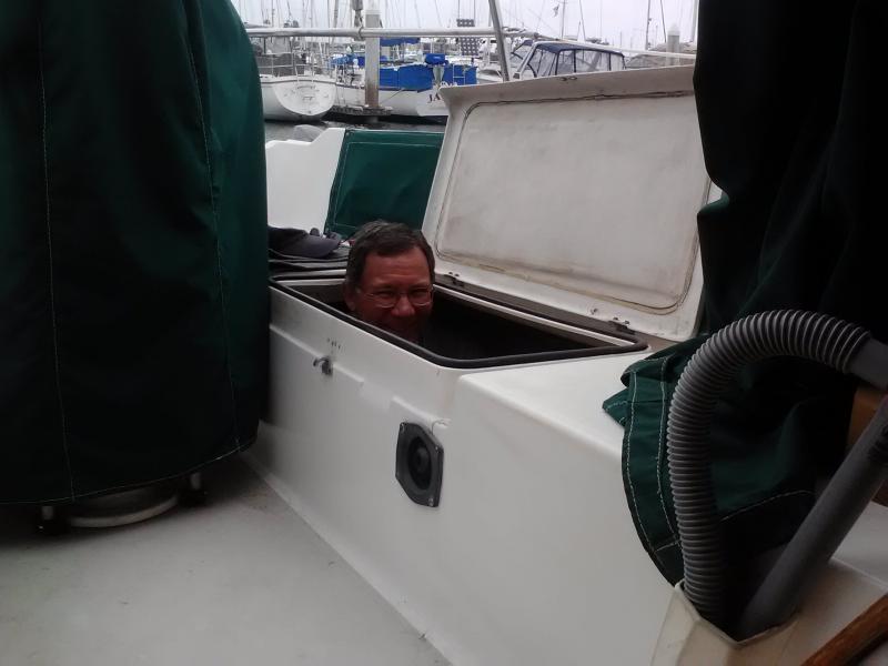

Like Stu - survey said it was cracked and needed changing.
Two man job for sure. Ours had a sleeve in the hose in the port side laz. Bill emptied it and climbed inside. The rest of the hose was good. I stood on my head in the rear laz, removed the plate and used a mirror to see the hose clamps. We pulled it out throught the port side laz and went to WM for 9 feet of hose $$$$$$$. I lubed both ends with pipe goop and it went back together with no problem.
