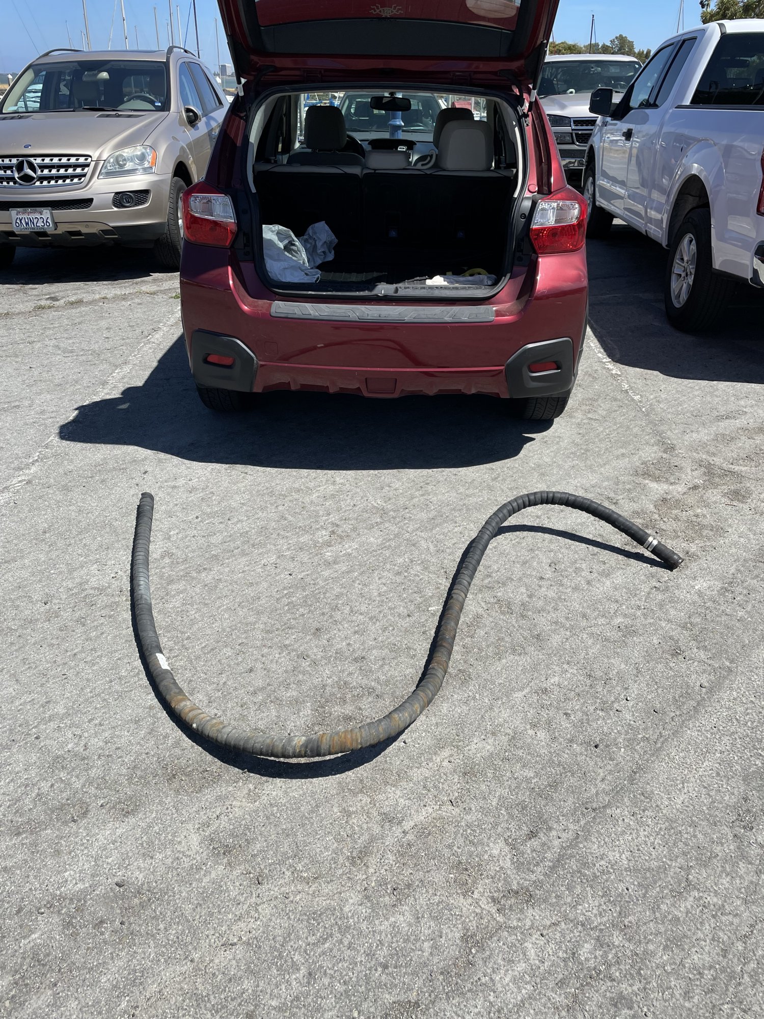

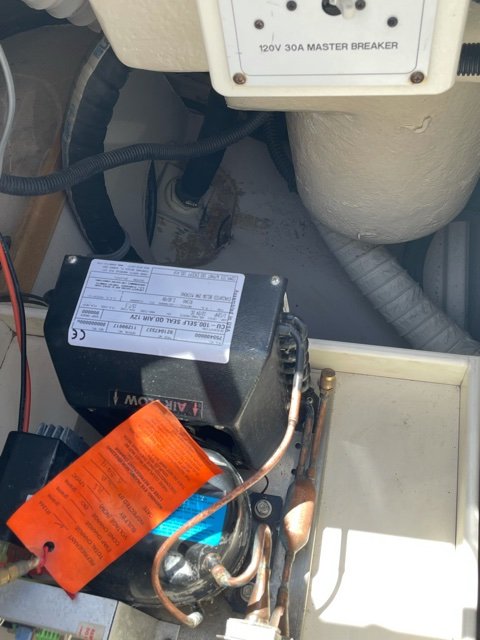

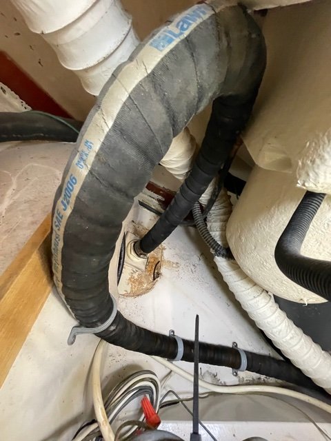

Figured out access and got it off, so 1/2 way there on this job.
Was able to unscrew and gently slide the compressor over onto the starboard shelf, which allowed me to slide the hot water heater a bit… thus allowing me just enough access via the aft starboard lazarette to get the transom part of the hose off.
It measured 12’4”, 1 and 5/8 diameter, and west marine didn’t have it in stock, so I ordered 13’ from Catalina Direct.
