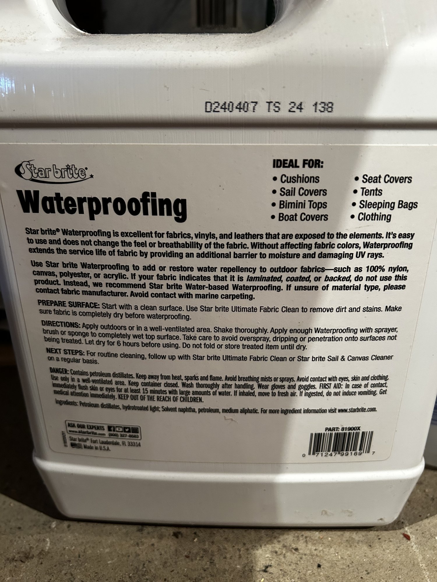

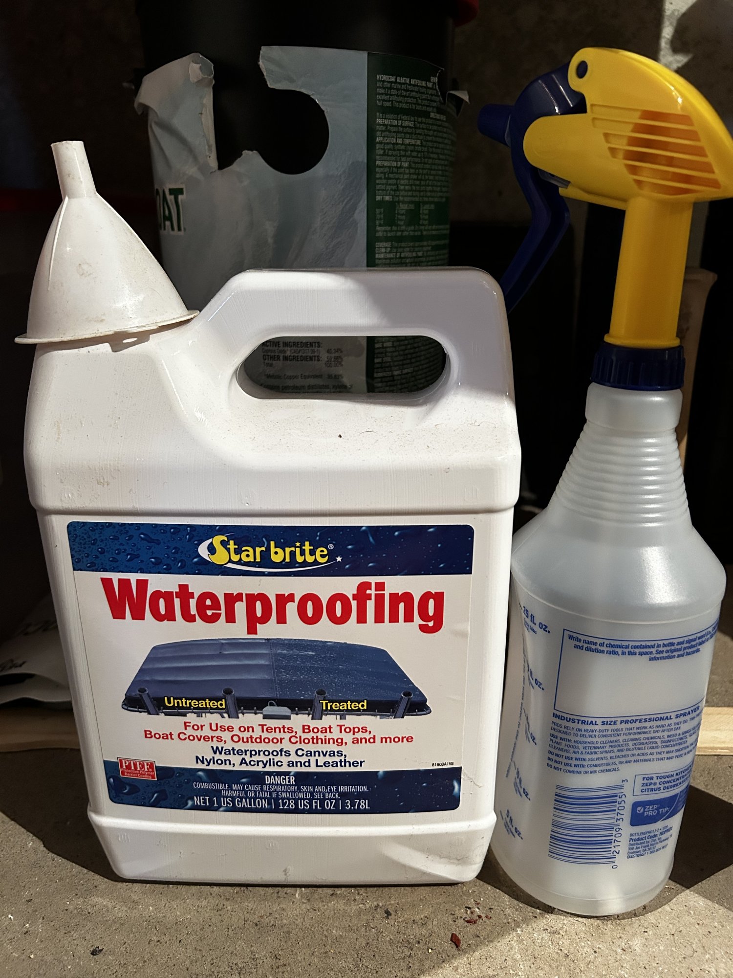

I use Star Bright Waterproofing. It‘s the only product I have ever used on my Bimini and I have never had a drip or any signs of water seepage. It is a bit expensive but well worth the price given its performance and it only needs a light spray from a spray bottle to cover a large area.
I do apply a slight bit more on sewn seams and zippers, because of the threads. But no leaks.
It repels bird droppings making them easier to clean off. All in all a great product.

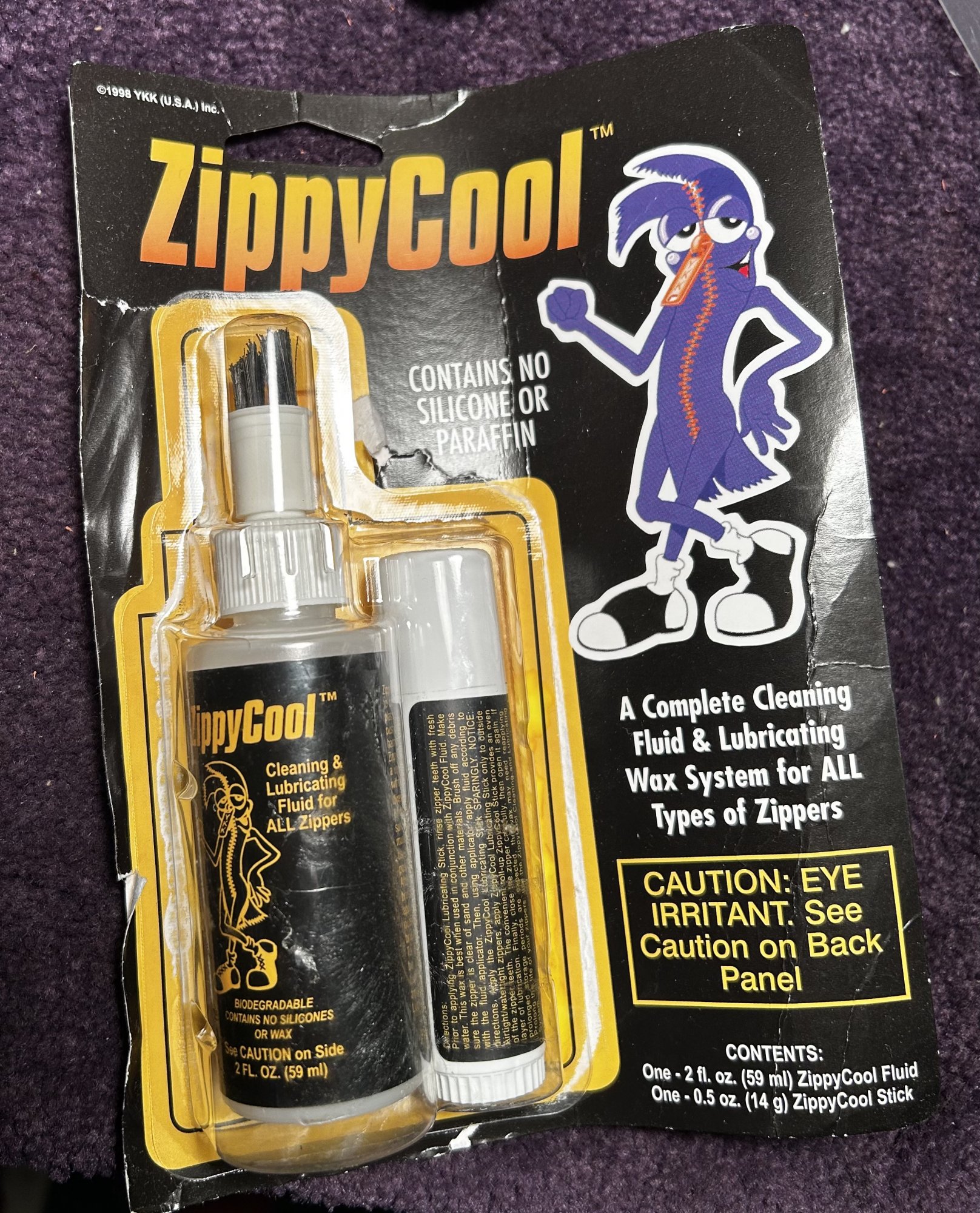

I also use Zippy Cool on the zippers. Not every year, maybe every other year. This has a cleaner you first use to clean the zippers then a wax tube you run along the zipper. It doesn’t take much and keeps them from binding up and jamming.
