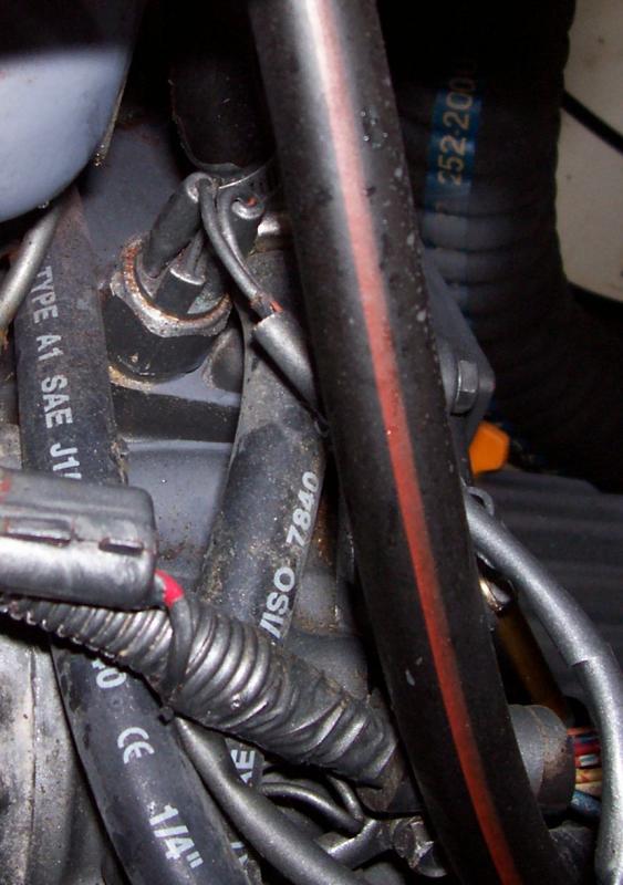

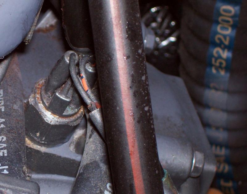

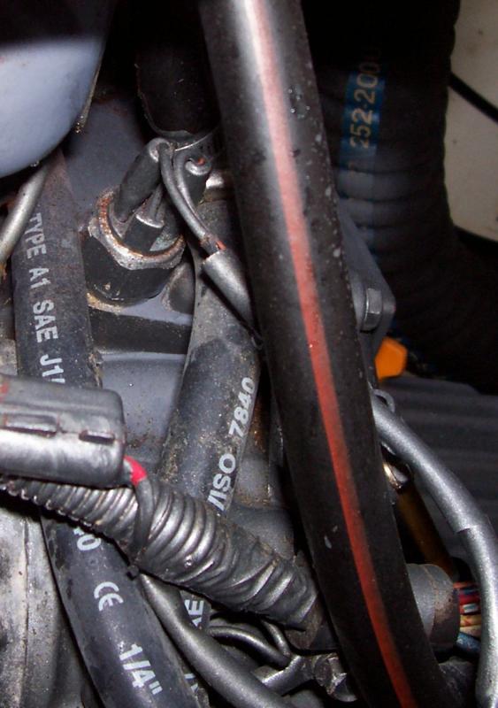

There should be a sensor located somewhere on the bell housing of the transmission. Remove the 2 wires and check for corrosion. A little steel wool to clean up each side should be all you need if there is corrosion.
Ahoy Capt340, I cannot find the bell housing.
are the tacho wires connected to the alternator or transmission?
sorry for such a naive query but I'm really a boat wiring goon!
thanks.

What is your Westerbeke model number? If we had that others could identify it and give you some insight as to the sensors possible location. Following wires can be an impossible task.
will try to read that facing a very narrow s ace and seems very salt corroded.
All wire fittings behind the alternator was tight.

Now that you have the Engine Model number, don’t know if you have a manual for this engine or not. Here is a link to the manual for that model. Transmission info starts on page 47. Seems you may have to trace the wiring from the Tachometer back.
Sometimes 2 people are needed as you can pull on a wire in a harness and another can see it move, ever so slightly at times, in the harness downstream from the Tachometer. Then move on from there.
It’s time consuming and hard work but can be done.
That should be the neutral start switch and should have nothing to do with the engine if it is running. I always deactivate mine because when I need the engine to start I want it to. However, this is not a good idea if one is not good at situational awareness (like not checking that the boat is in neutral before starting) or if one has a substance abuse or drinking problem (not joking).
