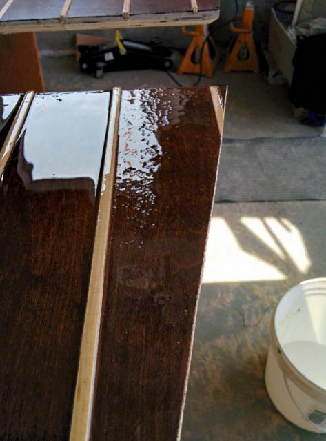

I find myself needing some advice again from the Forum. I've attached a picture of the project I'm working on.
As you can see the epoxy that I'm trying to put on my new floor isn't adhering in some areas.
Can anyone tell me what I'm doing wrong. I stained the floor then VARATHANE
Diamond Wood Finish - ext.(Water, Satin) two coats.
Did I do this backwards? Should I have put the epoxy on first?
Any ideas?
Thanks
Don

Don: Just drawing from my experience but as soon as I read epoxy over varathane: I thought a finish over a finish? If I use epoxy for a protective coat that is all I apply . Maybe now sand the finish so epoxy adheres properly? Chief

I see the picture that I tried to attach didn't for some reason. I'll try again.
Hi Don,
I don't see in your procedure where the epoxy is mentioned.
Sorry to be the bearer of bad news, but yes, I'm afraid you may have done this in the reverse of what it should have been done. My procedure in the past (according to the book) has been to use a thin coat ( using lacquer thinner) of epoxy to saturate the wood surface, then several coats of epoxy for mechanical strength, and finally three coats of varnish to protect the epoxy from UV. You'll find it all in the attached manual from System Three which is a excellent instructional. Their cartoons are also good for a laugh.
Chief has mentioned that there are many epoxies on the market and the number is growing daily (if not hourly). Check on line for you epoxy's manual. Seems like everybody, West System and others publish large instructional manuals on their products for PR. They may have a solution to you problem in there.
One final thing to remember when using epoxy is that it's 100% impervious to moisture penetration. Therefore, ensure that all work is absolutely hermetically sealed to avoid moisture penetration at all points front and back. IF water should get in, it's going to pressurize as it tries to find an escape route and will lift a lot of surrounding epoxy in the process.

Colour me biased, but I really don't have much faith in these water based varnishes. I would check to see that they do offer UV protection for the epoxy.
Do I understand that your observed lack of adhesion is only based on a patch test so far ? Great news :dance: as I'd hate to think of trying to redo the whole floor if need be. As previously mentioned, there are loads of manufacturer's epoxy manuals out there which will take you from the boring depths of epoxy chemistry to some amazing tricks like flaming the wet epoxy (using a torch) to produce a mirror like, bubble free surface.

Don: So sorry as that is beautiful work except for that finish. Do you think fine block sanding will clean it up for another finish coat? I can't think of anything else, plus, you could go to the Varathane for the finish coat now if you wanted to.

And yes epoxy first then finish... Think of the epoxy as your barrier coat. Also don't forget the bottom and sides!!! Sealing the bottom and cut sides, is very, very important if you don't want the finish to fail....

Had the same problem with epoxy not sticking. Solved it by wiping the wood with a throughly saturated actetone rag to remove surface oils.

Ok, original poster says he stained the wood, then applied water-based varithane, and THEN applied West System epoxy. This is not the correct order to apply the finishes.
First step would be to stain. I would check with West System (they have extensive information on their site) to make sure that either oil or water based stain (OP did not specify) is compatible with the epoxy.
Then, apply 2 coats of epoxy. You MUST let this cure for at least a week, to allow for full cure and production of any amine blush, whether there is supposed to be blush or not.
Clean with soapy water to remove any amine blush. Blush will prevent many finishes from drying or curing.
Then, he can finish with an appropriate UV protectant varnish. This will protect the epoxy from turning yellow from UV. As MaineSail has pointed out, I wouldn't trust water-based varnish. I would go with a respected name in marine varnish, whether it's Interlux, Pettit, Epifanes, maybe Total Boat... Besides, real marine varnish will provide that rich, amber color. Any water-based "varnish" I have seen goes on milky colored, and dries to a clear finish with no amber color. Even down on the cabin sole, I'd probably still use traditional UV varnish, because you could have sun shining through the companionway.
I might also use ground walnut shell mixed in with the final coat, or next-to-last coat of varnish for non-skid. Another option is to sprinkle granular sugar or salt onto a wet coat of varnish, then wash and dissolve off the sugar or salt to leave a non-skid finish in the varnish itself.
