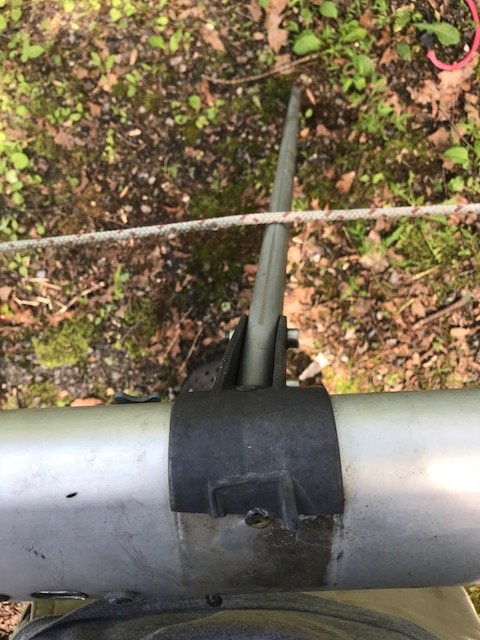

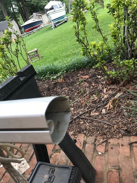

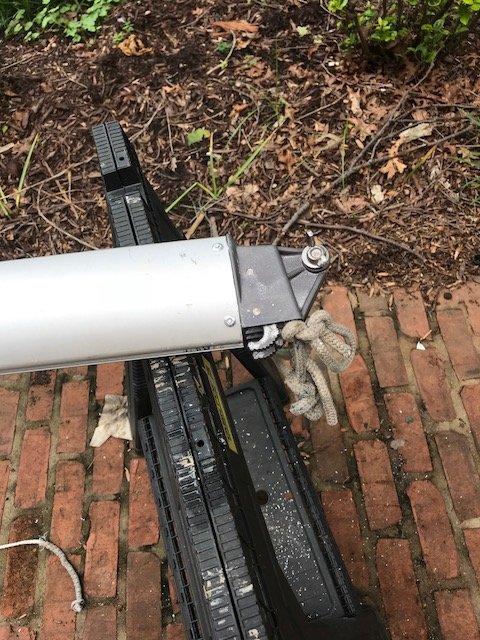

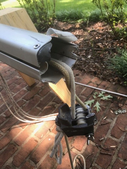

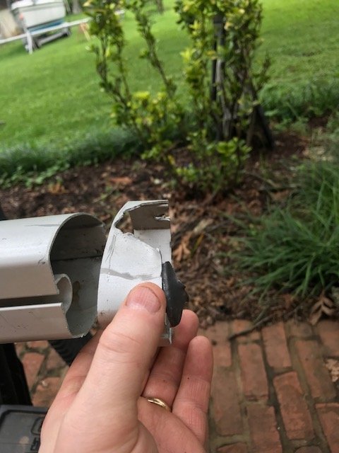

Well today I fixed all of the broken stuff. I got the parts I needed right here at SBO. Here are some pics of the recovery. First the boom. I cut off about an inch where the boom was damaged at the gooseneck. I had about 2" of extra boom length to spare.

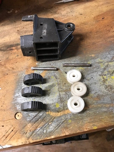

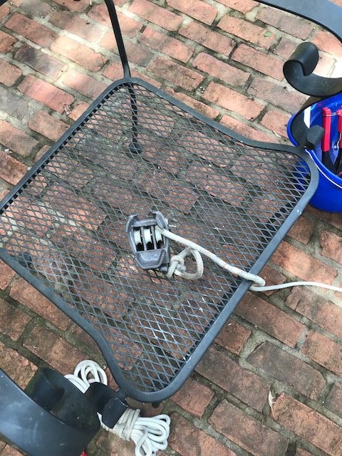

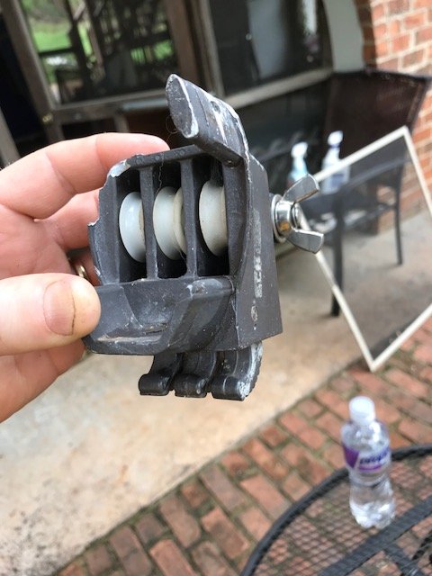

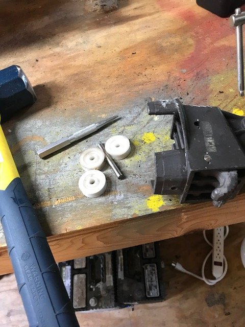

Then I removed the sheeves and cam clamps from the old damaged boom cap and put them in the new cap. Then time for rivets.

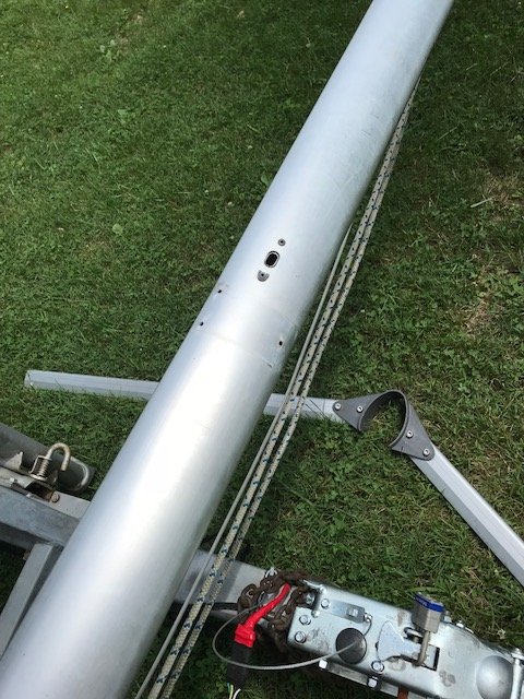

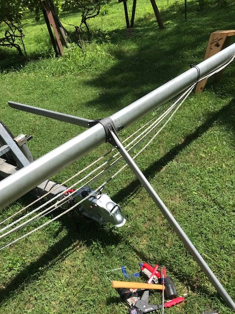

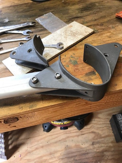

Now it was time to work on the mast. When the spreader bracket on the mast broke, the rivets were not torn out. So I first had to drill out the old rivets, move the spreader to the new bracket and then rivet the new bracket in place.

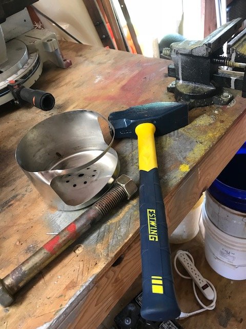

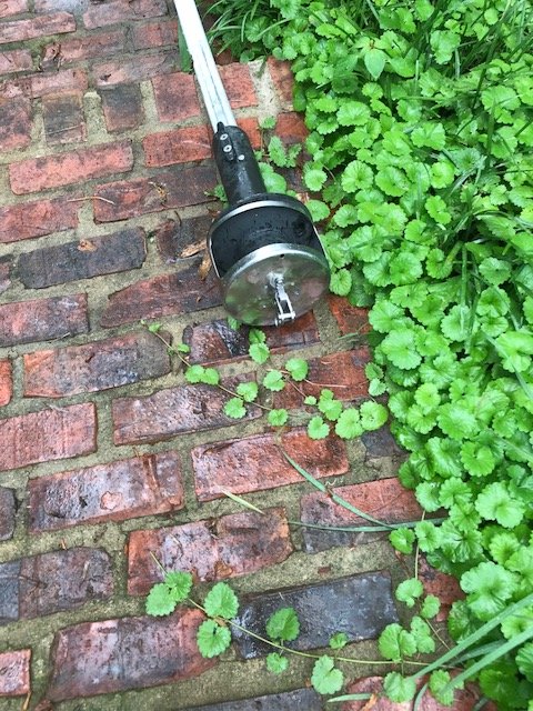

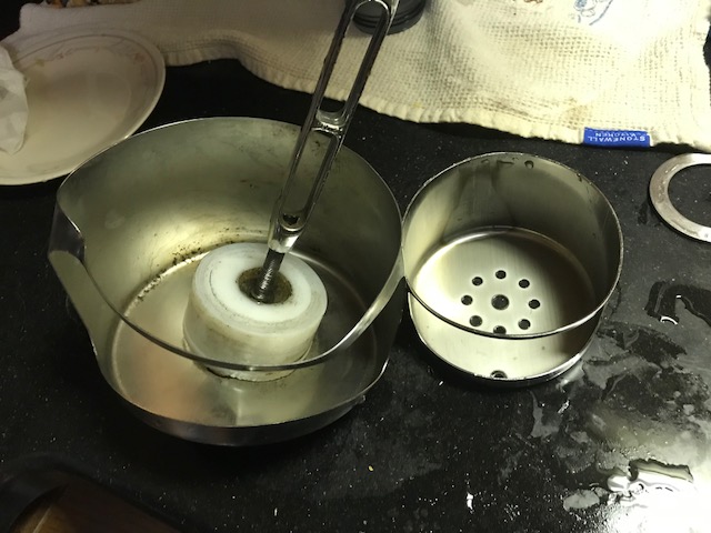

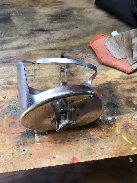

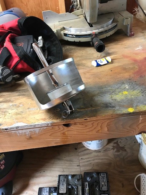

I also had to repair the guard for my furler. However I order the wrong size. So I decided to reshape the original using a 7/8 bolt as a punch and a mallet.
