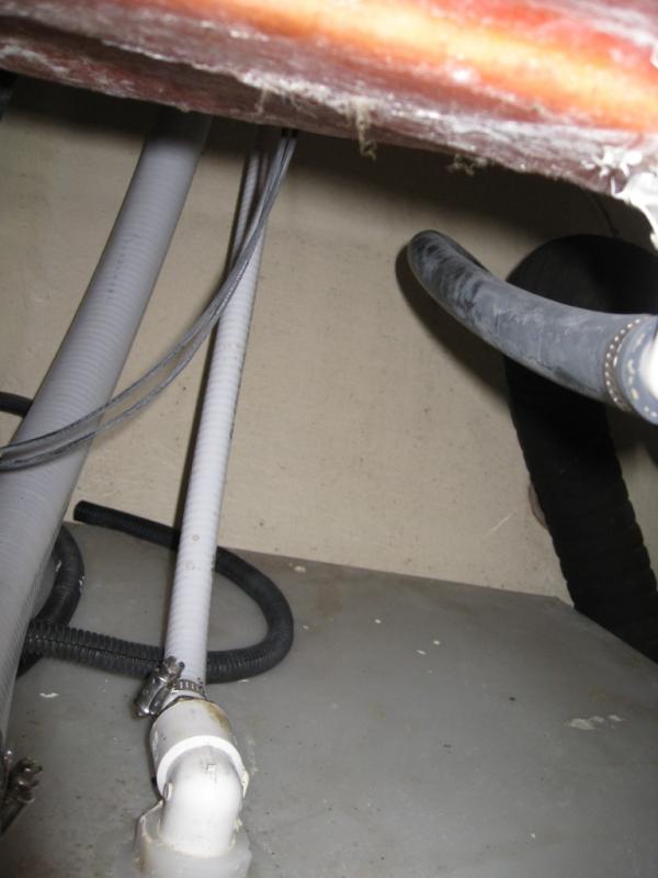

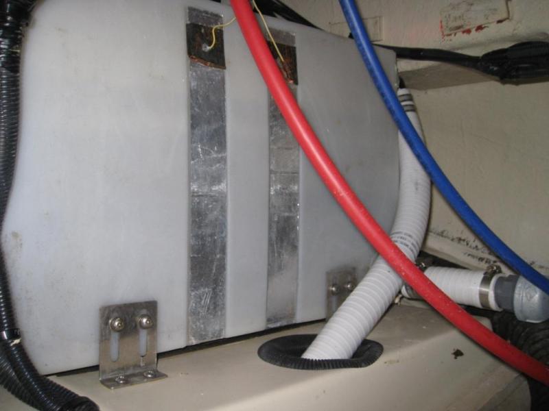

- 25 gallon holding tank with 2 foot hose to pump out and 5/8” vent hose which is 18” long, curved and definitely steeper than 45 degrees
- one head with run of approximately 15 feet to holding tank, some parts “uphill”
- one closed aft cabin and one closed v-berth
- the head is 1/3 of the way up the boat on the starboard side and is the best smelling part of the boat...somehow. The second best smelling part of the boat is the v-berth

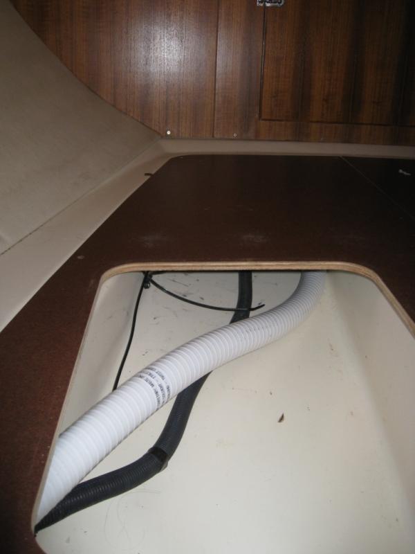

- worst smelling part is main cabin followed by aft cabin (the septic hose runs underneath the bunk, this is also where the macerator is/was located)
- holding tank on aft, starboard side and diesel tank on aft, port side
- aft cockpit with port side locker which continually smells (is above and adjacent to diesel tank)
- boat smell is at its worst when we close it up after a weekend with the holding tank full or partially full and return after a week. If we empty the holding tank before leaving the smell is not nearly as bad, but still there

You have two toilets, but only replaced ONE hose (and I'm not even sure which one you consider to be the "main septic line")??? It's a sure bet that if one stinks, they all do...and that includes vent lines...and everything you've written says hoses are at least one of your culprits. So replace ALL of 'em. If "the highest grade Trident product we could buy" isn't anything but Trident 101 or 102, it may already have permeated again...And a 15' run from toilet to tank is unacceptable, so we'll have to fix that too.
We would also periodically remove the main septic pump out cap while underway to get more air moving through the tank (after reading your book!)
You didn't get that idea from my book. No way that would help to the tank, 'cuz the pumpout line comes from the bottom of the tank.. the tank vent supplies air ABOVE the surface. It's also unlikely that any air moving across the top of a horizontal "hole in the deck" could even make it into the tank.
You two separate problems: odor INSIDE the boat and odor out the tank vent.
INSIDE the boat. Unless a tank is leaking, it's rarely if ever the source of odor inside the boat, 'cuz odor from inside a tank has only one place to go: out the vent. So nothing you do to improve tank conditions will cure odor inside the boat. You have at least two sources of odor--prob'ly more: hoses, residual sewage odor, and probly residual diesel odor. Sumps and chain locker are another possible source...you haven't mentioned doing anything to either of those. It's also possible that there is trapped water below the sole, but we won't know that till you've eliminated every other source.
Odor out the tank vent will allmost certainly require some surgery on the tank vent, but just using Odorlos correctly should improve things considerably. If you read the directions, you'll see that they recommend adding more at least every 5 days...more often in hot weather. That's because the active ingredient in it exhausts itself, and also becomes less effective as more waste is added. So if you're only adding immediately after pumpout on Sunday, it's already "gone"" by the time you return on Friday...requiring a new "dose" with the first flush...and more as needed. "As needed" means "when you get the FIRST WHIFF of odor out the vent."
There's a lot more to talk about 'cuz you've barely scratched the surface in eliminating all the sources of odor...but I suggest you spend some time reading the applicable discussions in this forum first. The we can talk some more about what else you need to do to eliminate ALL the odor.
