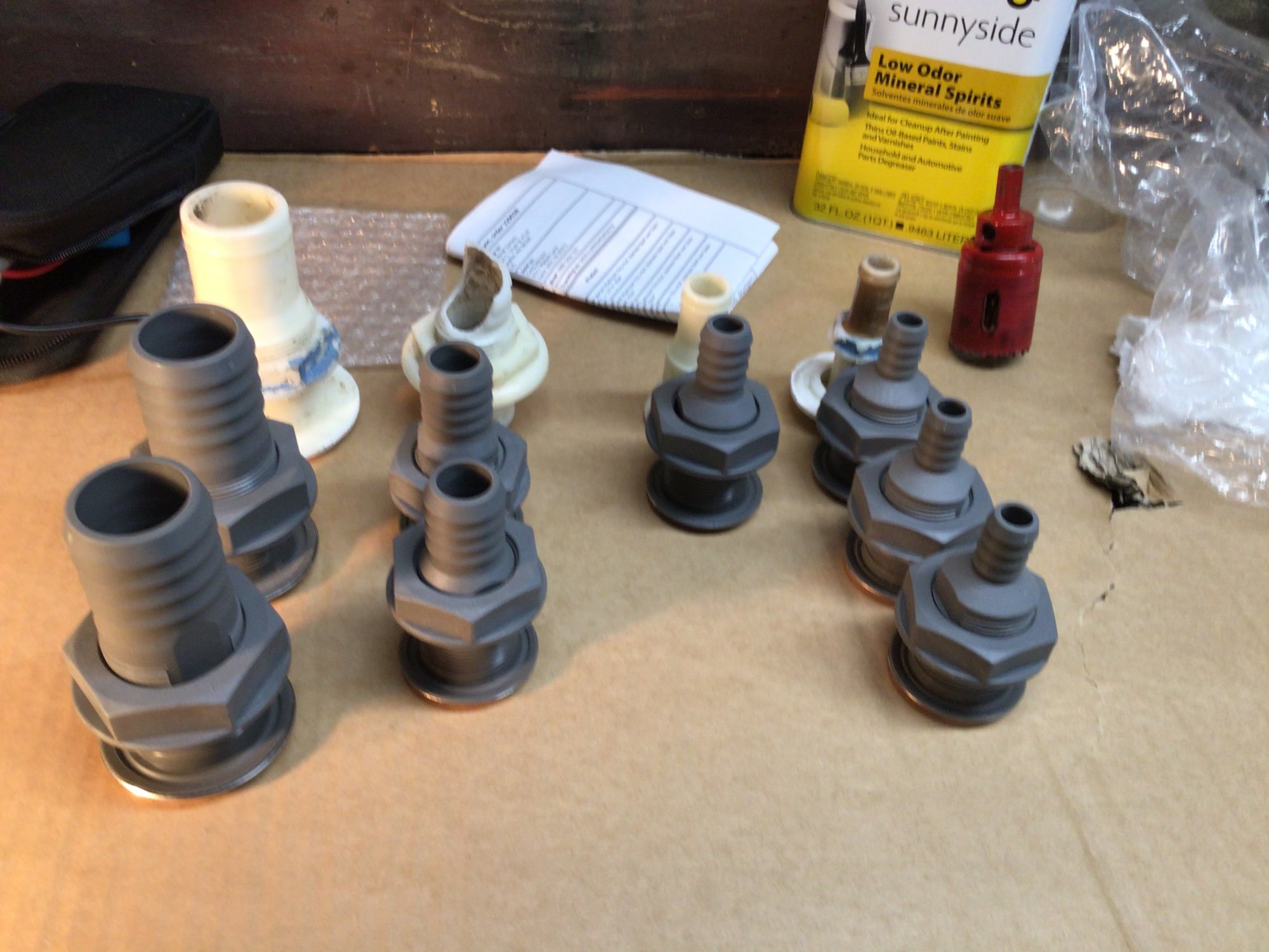

I am assembling parts to replace all of the above-the-waterline thru-hulls on my 1988 O’Day 322. The original white plastic one are brittle and ready for replacement.
I have 4 different hose sizes and 4 different “hole” sizes in the hull.
Despite my best attempts to verify the diameter of the threaded body of the new thru-hulls, when they arrived today, only the 1” hose size fits the hole In the hull.
The 2 smaller hose sizes (5/8” and 3/4”) have a hole size the same as the 1” hose size, so I will need to enlarge the holes in the hull for these 5 thru-hulls. The hull is solid glass.
****The question is, what is the best tool or way to enlarge the holes? I can’t imagine I can hold a hole saw in place well without having the arbor to keep it steady. A spade bit probably will bind in the existing hole.... would a step bit be the way to go?

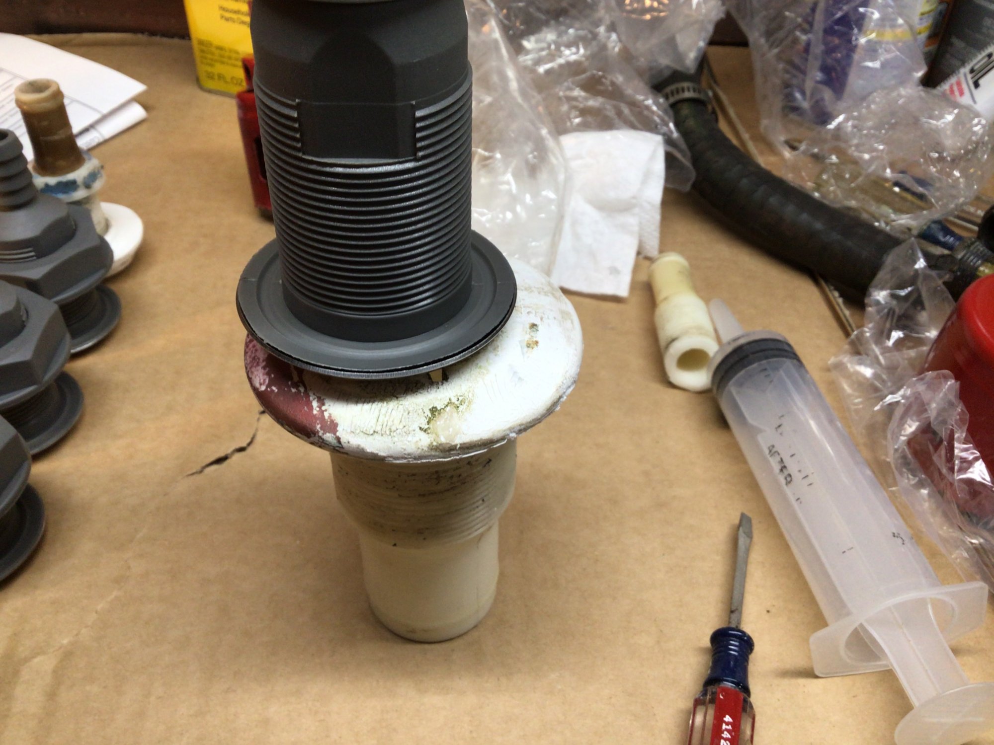

The largest thru-hull for the 1 1/2” scupper drains is actually smaller than the old one...so those holes may have to be reduced...which I assume will mean grinding and glassing them over, then re-drilling. Really didn’t want to do that...:facepalm:

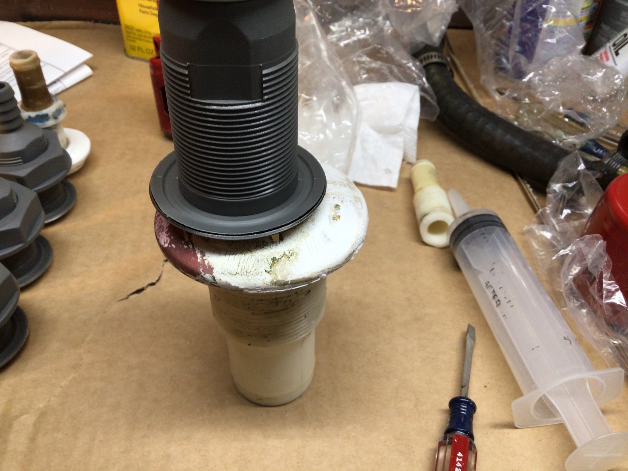

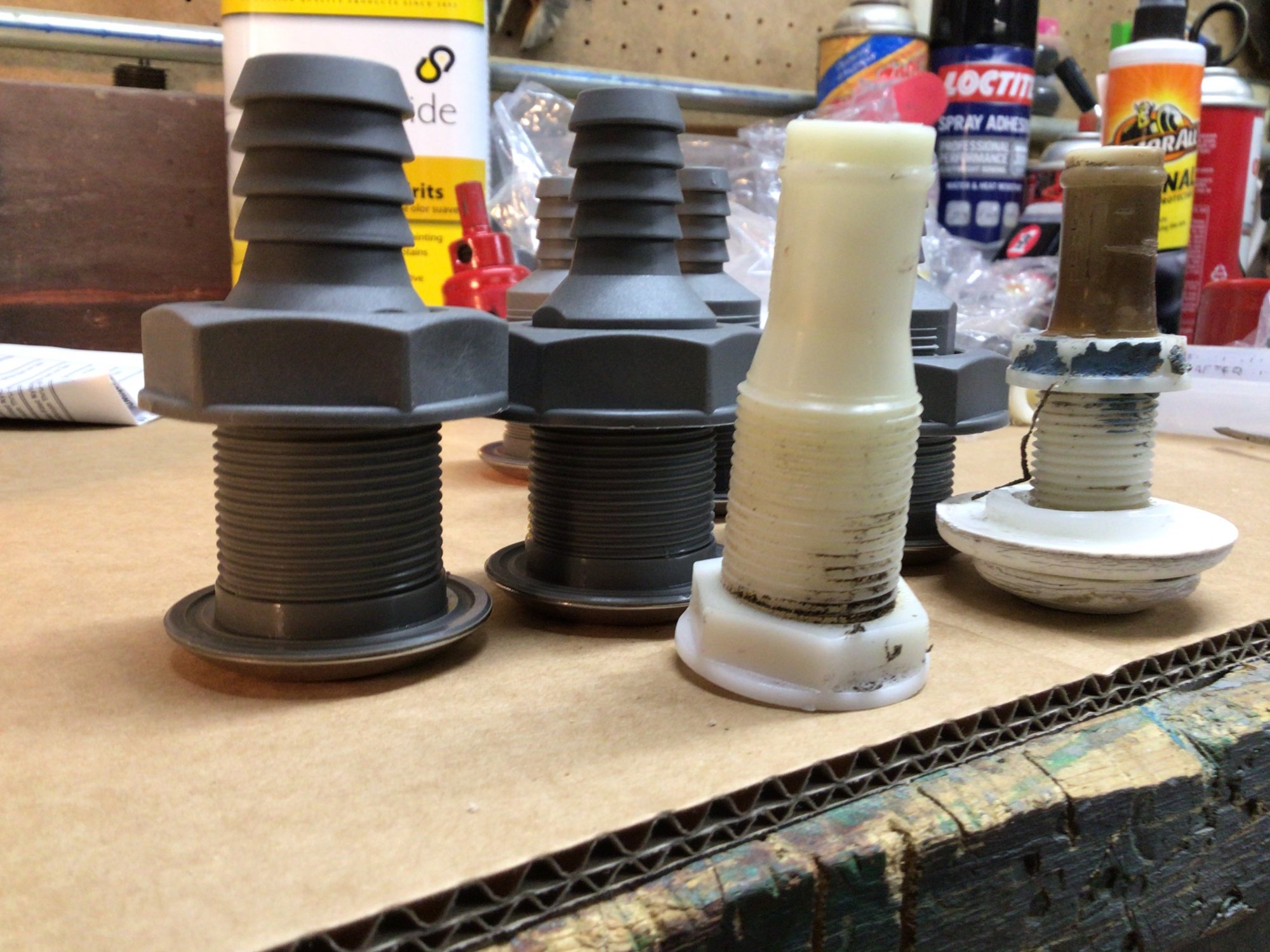

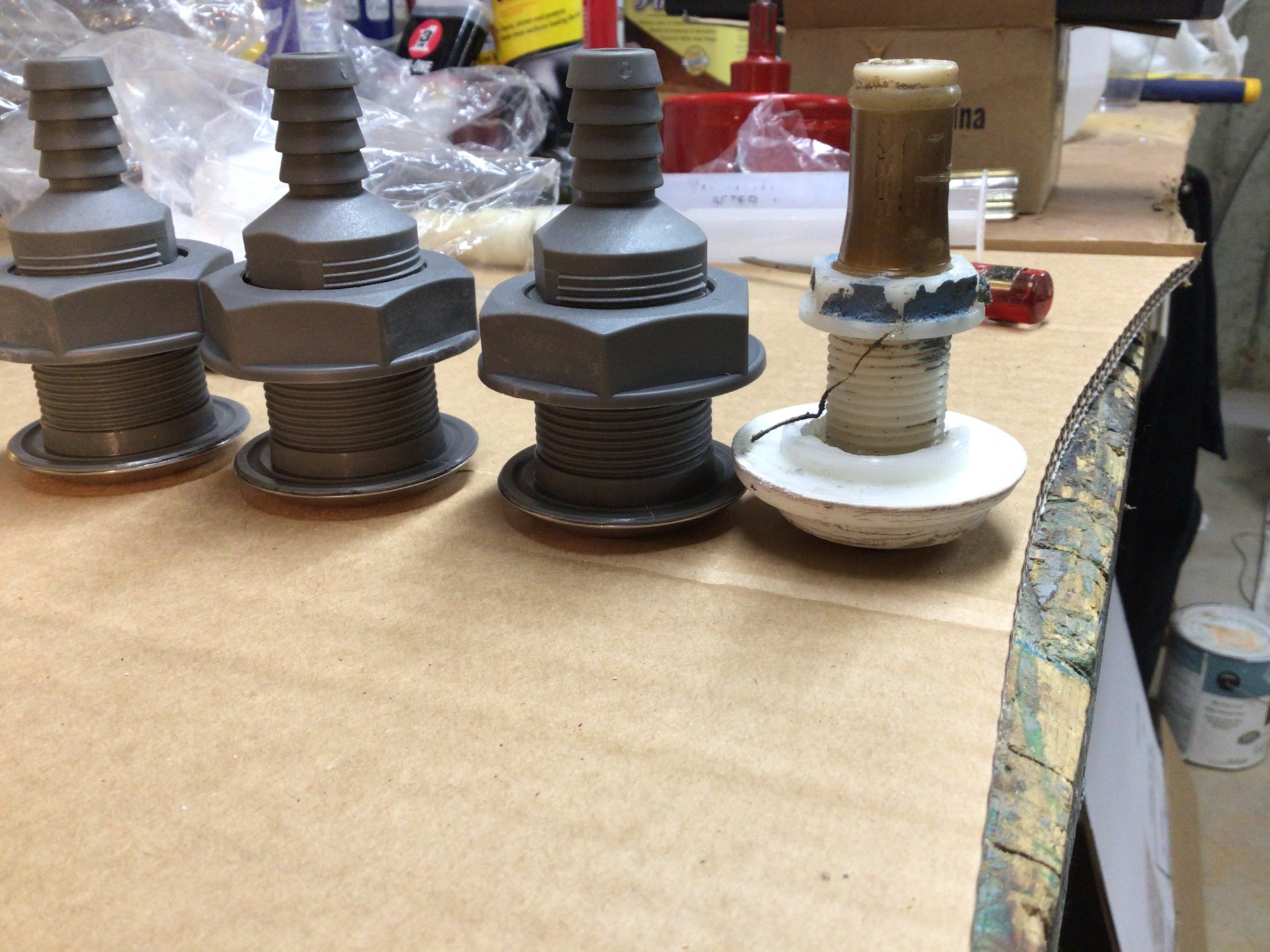

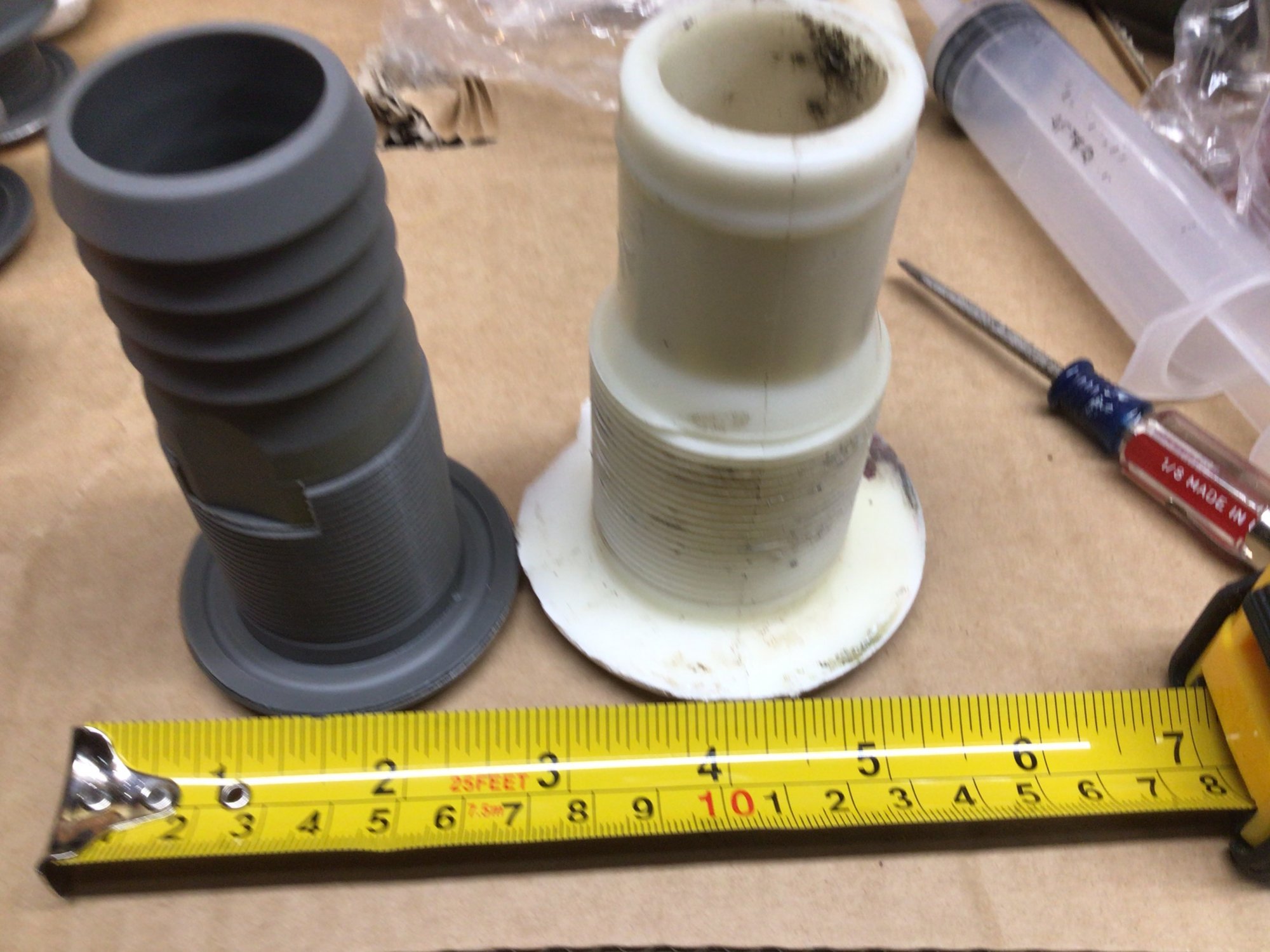

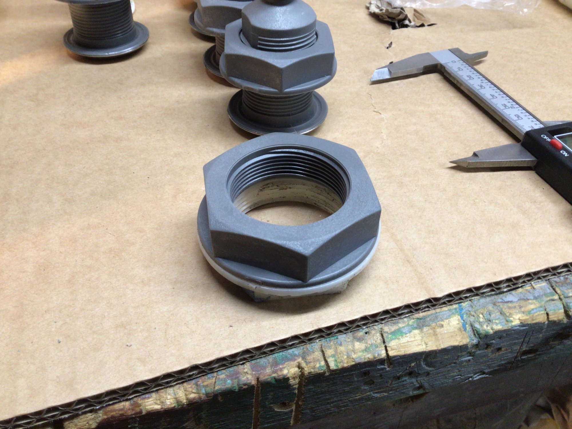

photo 1) all the new ones with their originals

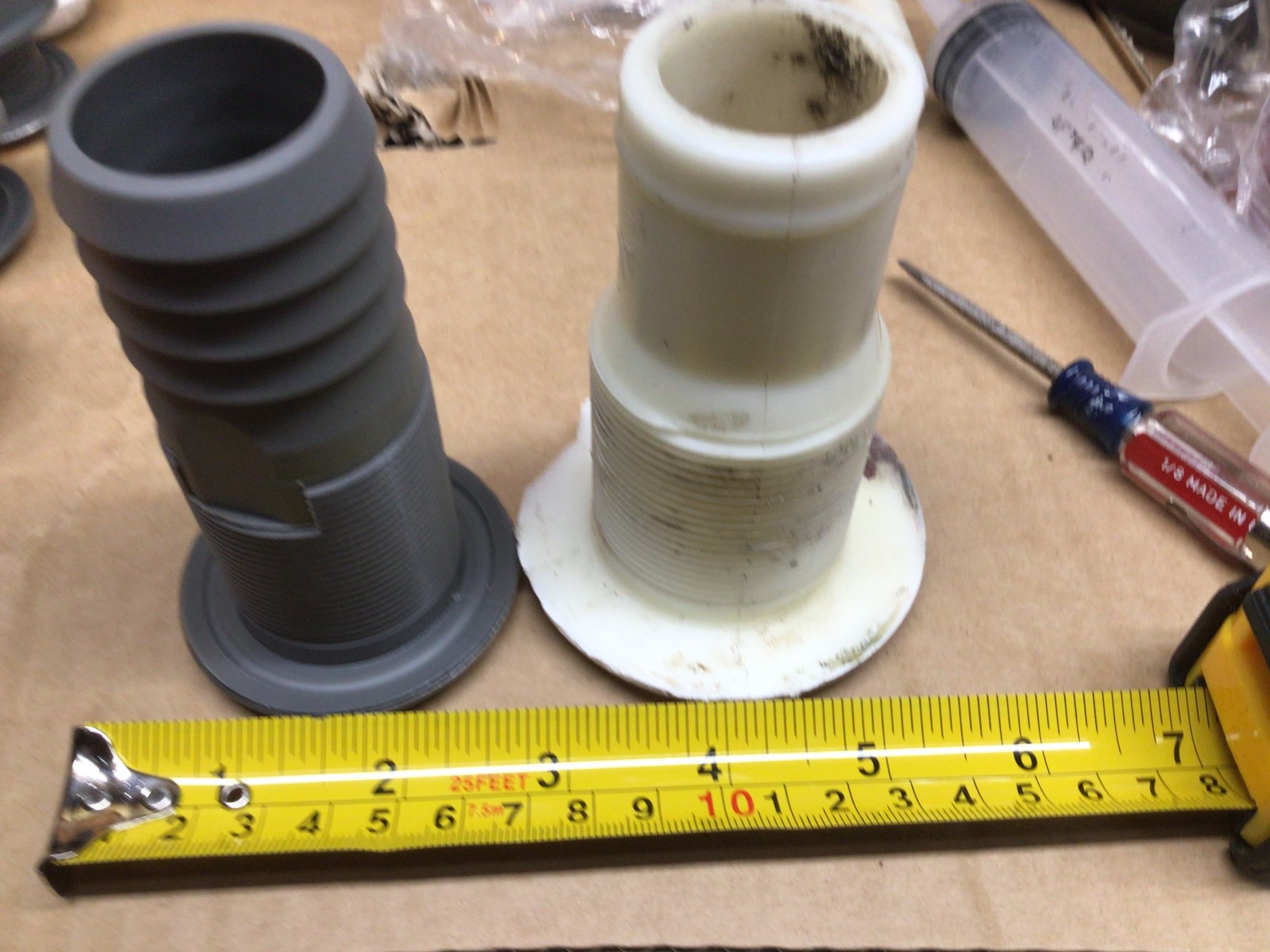

photo 2) 5/8” hose size, but bodies are way different size

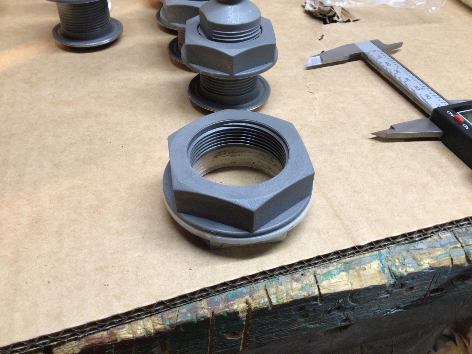

photo 3) 3/4” hose size...body larger than original (and same size as 5/8“ and 1” hose sizes)

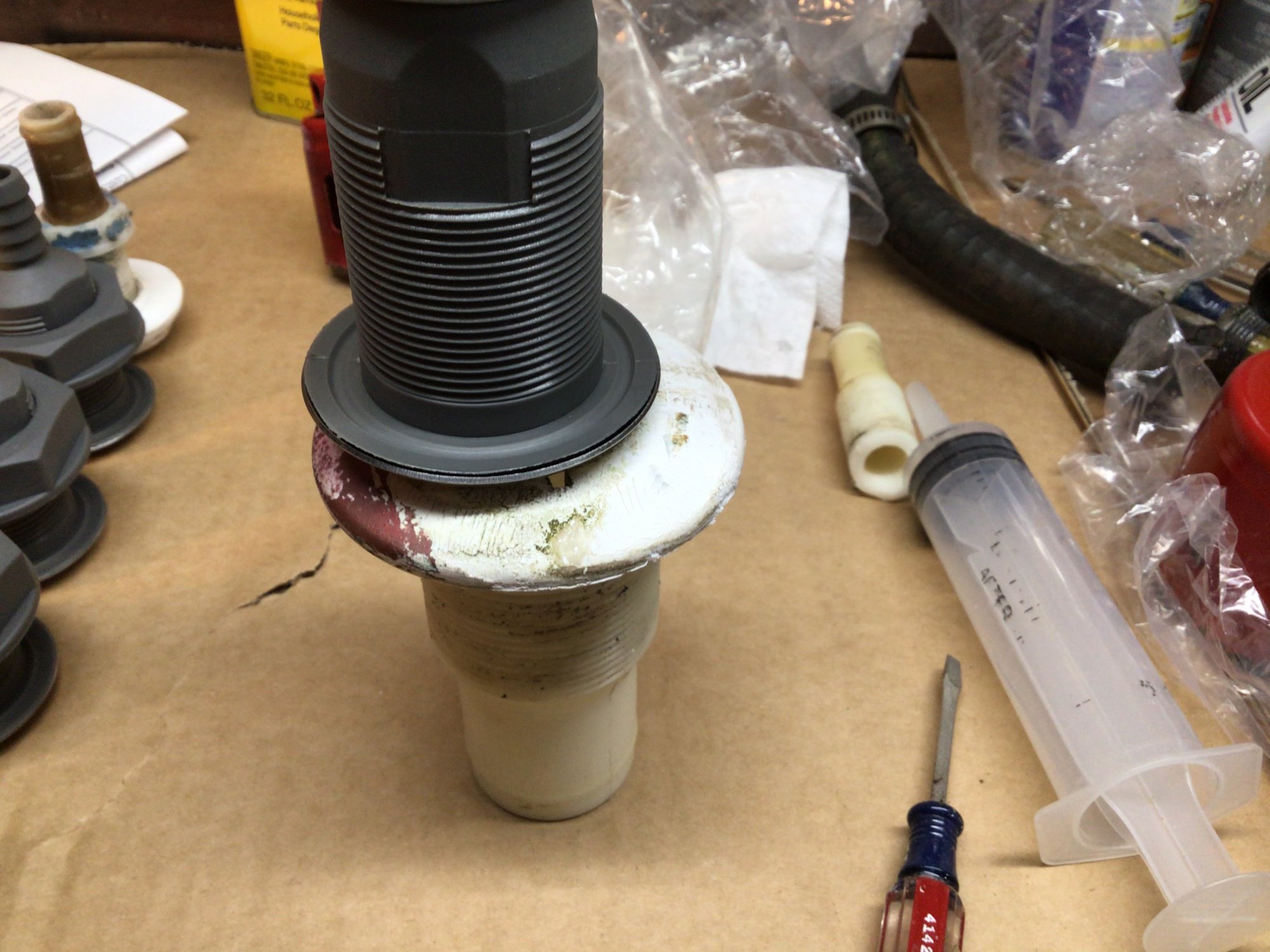

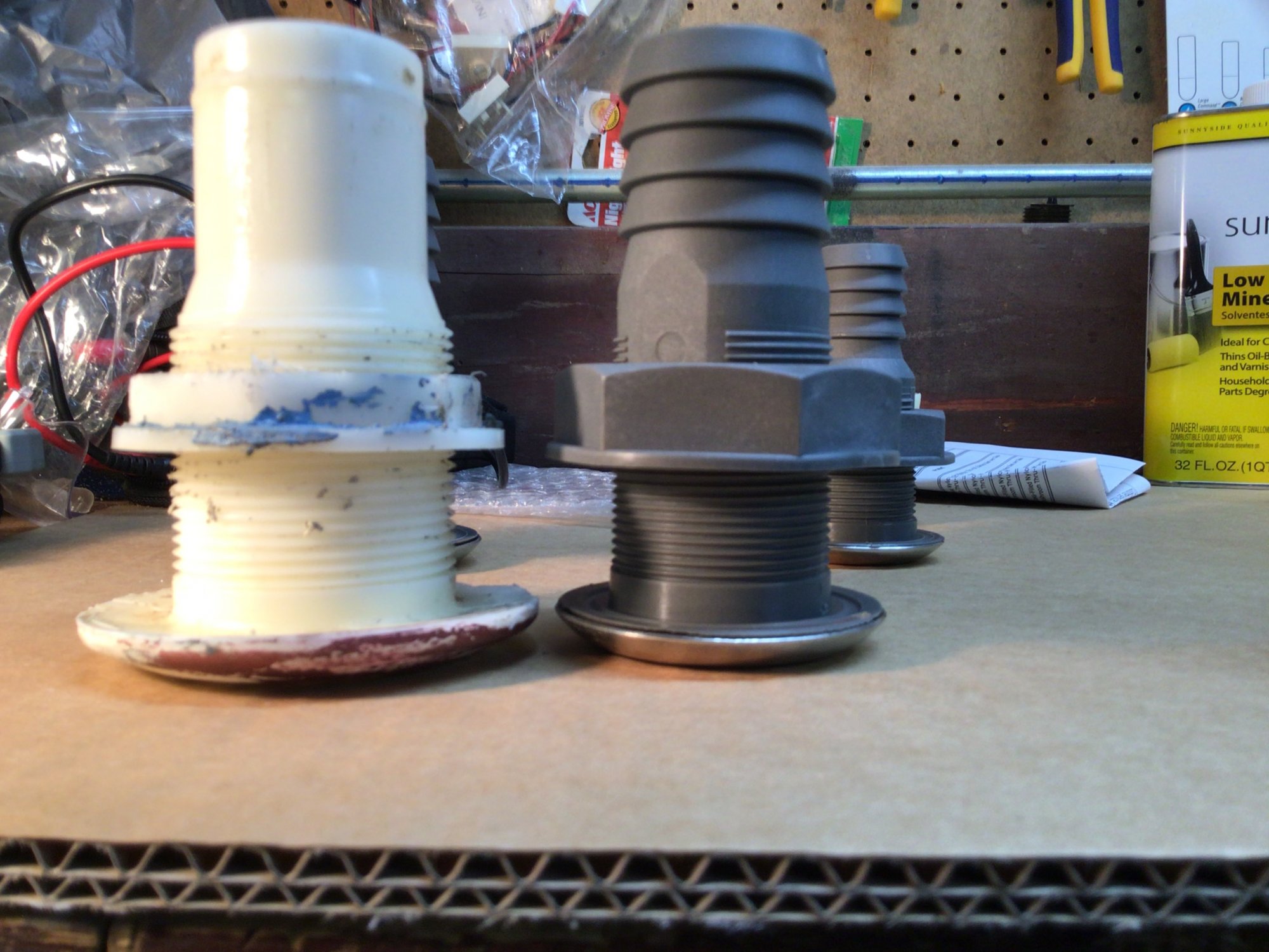

photo 4) 1 1/2” hose size...body is smaller than the original and may require making the hole in the hull smaller to

I am ready to order some thru hulls, but want to verify the hole size in the hull...

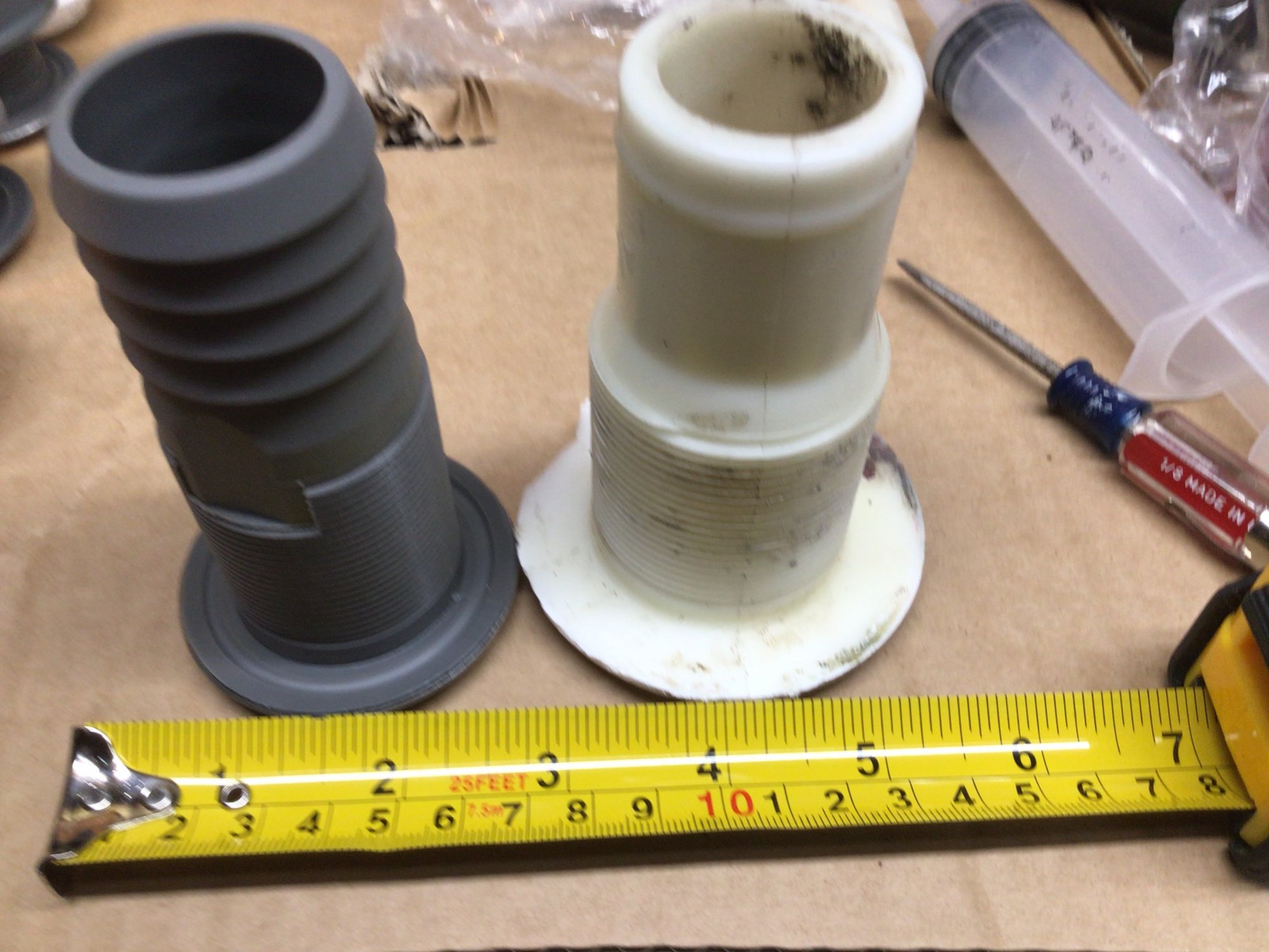

For example, part # 145708 - 1 1/2 hose size, but what is the size (diameter) of the threaded area or the size of the hole in the hull? The old one is 1.85" (1 7/8").
Part # 145703 - 5/8" hose - what is the thread area/hole size? the one I am replacing is about .785"
Part # 145704 - 3/4" hose - what is the thread area/hole size? (I haven't taken this one out yet).
Part # 145705 - 1" hose - what size is the thread area/hole size? the one I am replacing is about 1.3"

@dlochner - For the 1 1/2”, the new one is about 1.5”. The one that came out is 1.85”. So pretty far off. But the OD of the nuts are about the same size...so maybe it will fit...but there is about a 1/2“ difference in the size if the heads...a lot of that is in the difference in the size of the flange...
Tally Ho,
The threaded portion of the 1-1/2" mushroom to hose barb thru hull from Marelon looks like it has an od of 1.850".
Perhaps you could get the Marelon item for that hole and not have to worry about size difference.
What brand did you get?

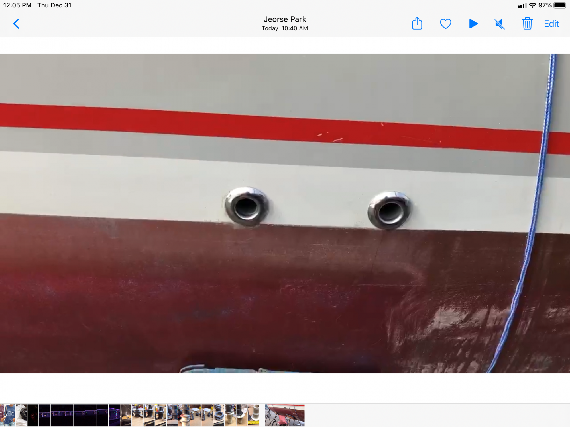

I went out to the boat this morning, and was able to enlarge the holes for the smaller size thru-hulls using the wooden plug idea suggested by @dlochner. It worked very well, and was simple solution (often the best kind) using stuff I already had at the boat.
I fit the 1 1/2” thru hull into its hole, which is a bit too large. The backing nut fits good, but there is precious little of the mushroom flange making contact with the exterior hull. I am going to think about this for a while, take the 2nd one out and see how the new one fits...it is too cold to do much with epoxy, so I have some time to think about this issue.
But for now, the smaller ones are in place thanks to the great ideas for enlarging the holes in the hull. I haven’t bed any of them yet as it is too cold to apply Sikaflex, but I am very confident in all but the 1 1/2“ thru-hulls, but will come up with a solution before spring.
