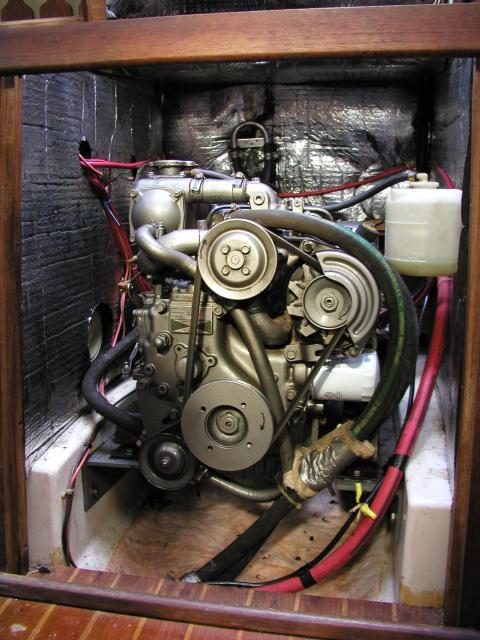

I think that the pump can be mounted in the bracket 180 degrees out. Sounds like that is what happened.. Remove the bracket and rotate the pump 1/2 turn in the bracket, which will reverse the hose ports .. Should be fine .. The cam should be in the top right quadrant of the pump as it is mounted, looking toward the shaft. The pump is in the bottom left of the picture mounted on a swing bracket and belt driven clockwise.

Yup, Easy and Maine are right but the cause is that the pump is flipped in the bracket. When you turn the pump 180, the ports will reverse and it should be fine. You can see from my posted shot that the hoses would be tough to reverse. Stu is correct.. if it has been pumping air the impeller is probably toast and should be changed out before trusting it.

His engine has the pump mounted to the engine, not like the belt driven Yanmars. No way pump can be reversed, but would be pretty easy to switch the hoses if you weren't paying attention. Everyone is correct about the impeller. Put it in the trash.
10,253
Ohhh Man.. I assumed that he was talking about a 3 GMF .. standard on most (old) 34's .. but I know some were equipped with Westerbekes and the new ones have the engine driven pump.. and ya right.. on those, the hoses can be easily reversed.. My Bad..
