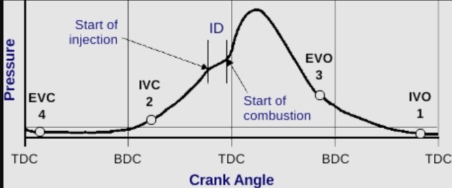

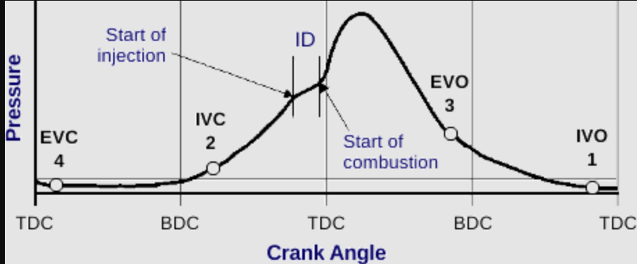

The knocking sound that is present in all diesels is due to the rapid combustion once the mixture reaches the combustion point. This is why diesel engines are built much more rugged than gas engines. Some things can cause that combustion to be more sudden.
