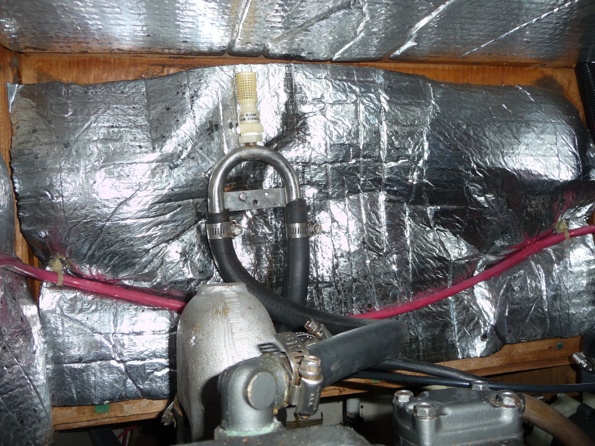

On my old 34, it looks like this:
Plastic thingie on the top of the "U" is a check valve to stop any siphoning. The seawater leaves the exchanger and goes through the loop to the exhaust elbow.
Nice mounting location. Mine was mounted on the side of the engine and eventually managed to leak from the check valve due to the rock and rolling at minimum RPM's coming into the dock. Slowly down the side of the engine, corroding it everywhere as it went.
Was not pleased in the least. Had to strip as much as gear as I could off the starboard side of the engine, wash and wire brush and finally repaint.

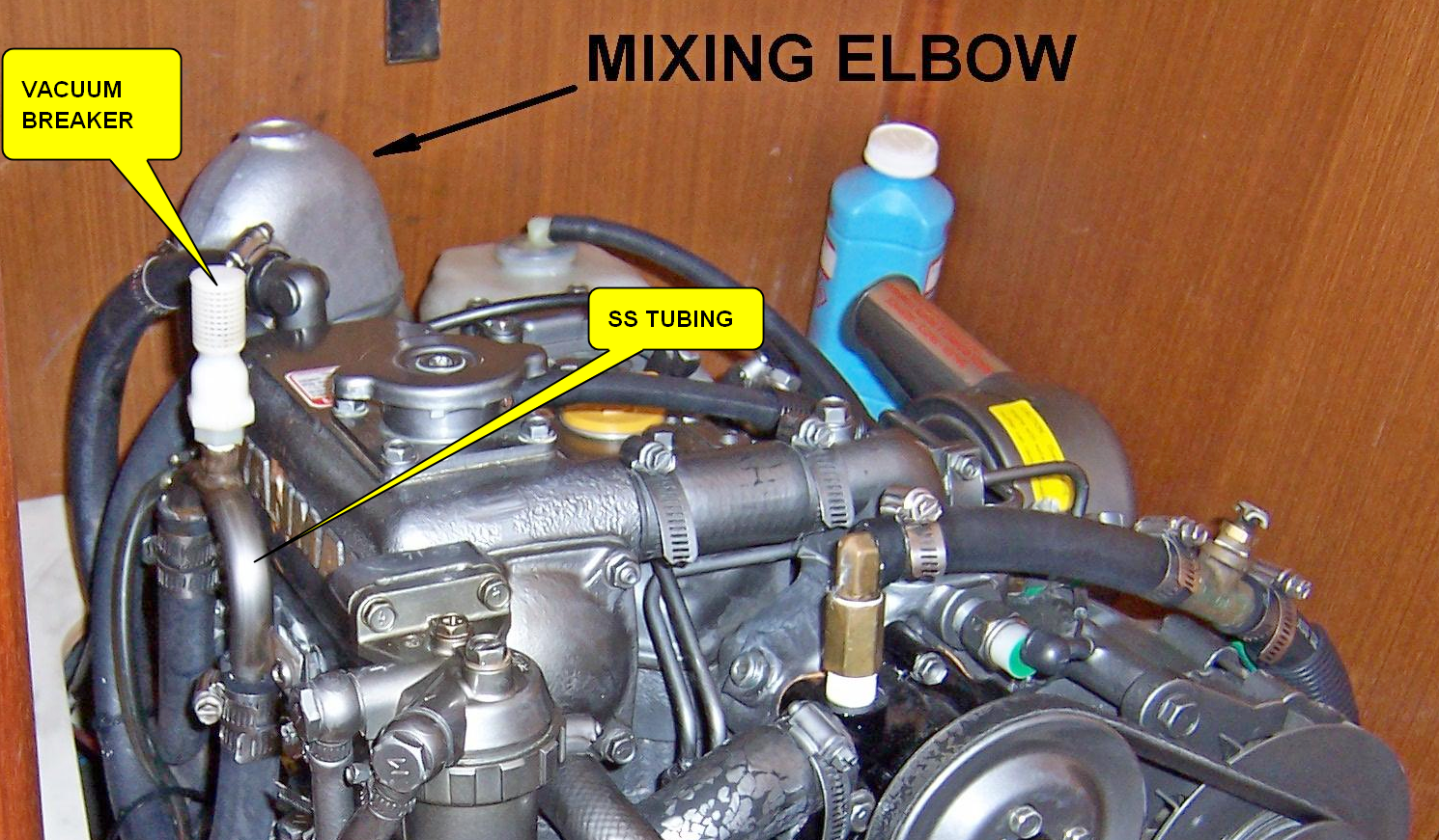

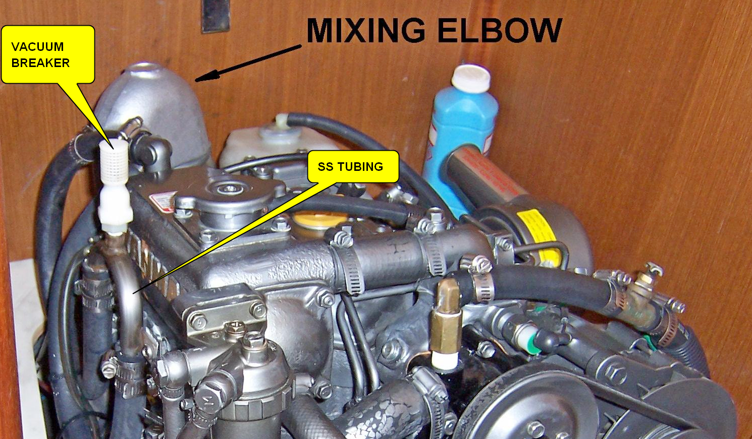

This is a shot showing the vacuum breaker attached to the engine as assembled in the factory :
Corrodes the hell out of the side of your engine when it decides to leak.
My bad, I had pulled it out for a better picture. It was not really attached to anything, it was held somewhat upright with the hose to the mixing elbow but was otherwise not attached to the engine or engine compartment. The hose on the left in the picture went to the HE. The reason why I posted in the first place was the vacuum breaker and tubing do not show up in attached scan from the Yanmar parts catalog. The PO had someone replace the mixing elbow assembly about 4 years ago and I guess they got a bit lazy but the hose to the bilge is a head scratcher. I'll see if I can reassemble and replicate your picture - very helpful. Thanks
