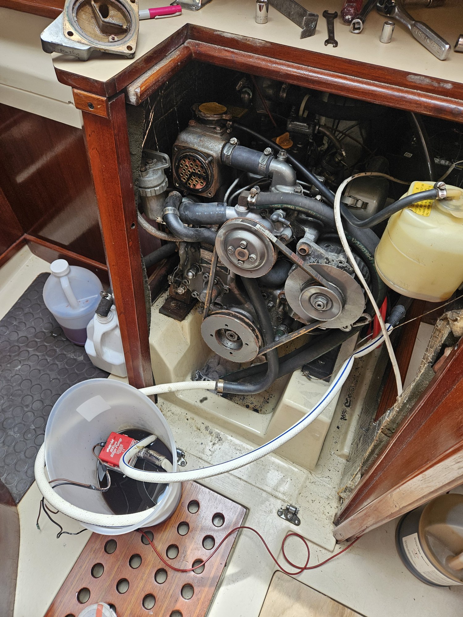

1) Drain raw water from heat exchanger with small 1/4" tube (there should be petcocks for this) 2) Connect ~ 3/4" tubing to raw water input and raw water output to a bucket 3) Run descaler (Rydlyme or other) from the bucket through exchanger using a small bilge pump supply to the front/intake of exchanger and return to the bucket from the back of the exchanger. 4) Remove descaler tubing and restore normal hose config (unless doing optional step).
5) Optional - Drain coolant from Heat Exchanger via petcock and small 1/4" tube into clean container. Drain off the residual descaler via raw water petcock. Remove the front exchanger cover and you can gently access most (not all) of the tubes to visually inspect and if needed, run a small implement (~5mm) down the length of the tube (BE VERY GENTILE - DO NOT FORCE ANYTHING). In all likelihood you do not need to do this but you can confirm a nice clean exchanger. Consider having a replacement gasket for the from exchanger cover in case it needs replacement. Put bolts back in their original positions.

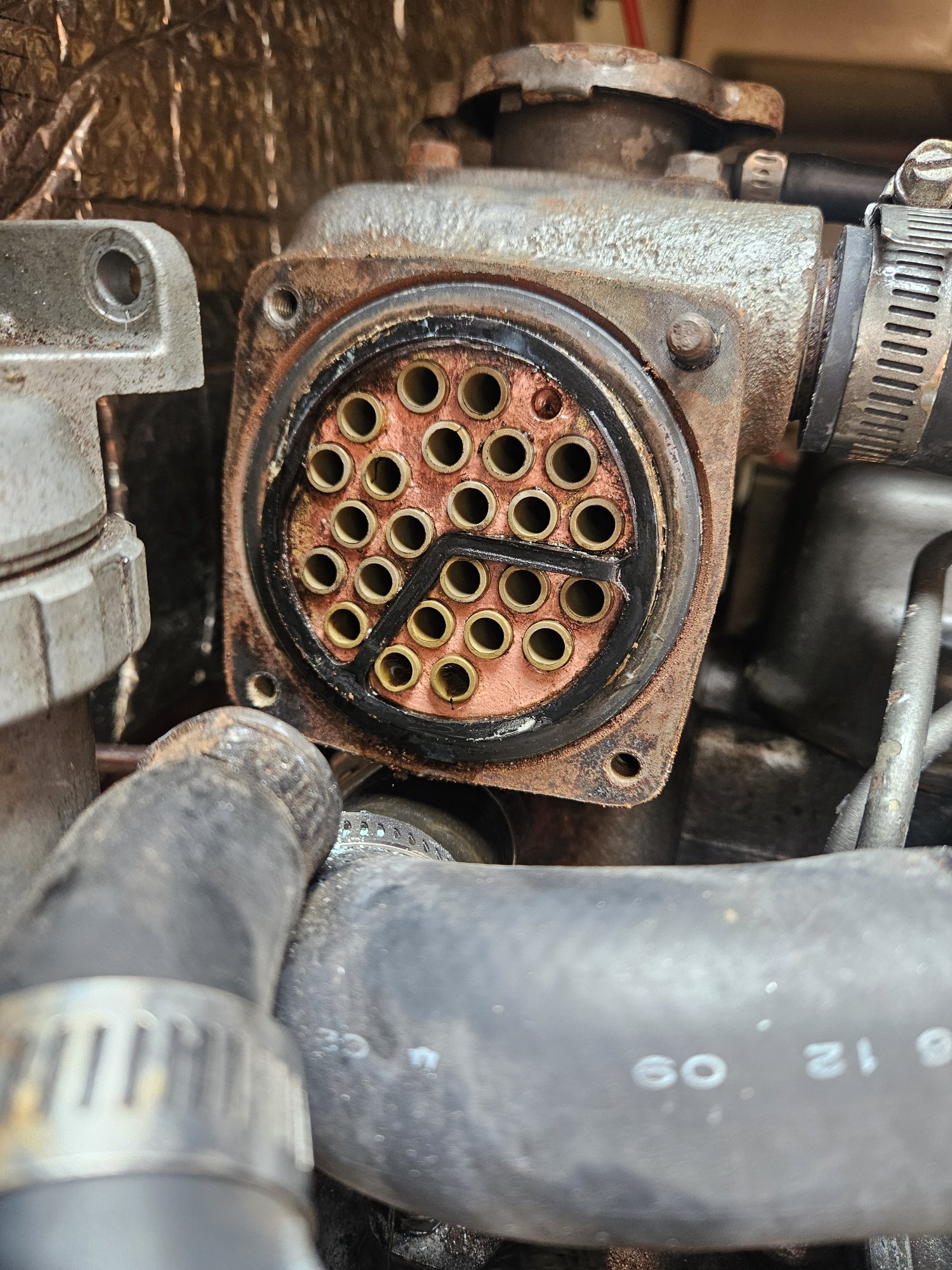

There was a lot of good advice on this thread and thanks to all who contributed. I ended the season with pretty much the same overheating problem. Today I took the cover off the HE and shined a light through it - perfectly clean which makes sense as the yard ran barnacle buster through it last fall. I also removed the exhaust elbow which looked pretty good which I expected since the PO replaced it two years ago.
Do HE need to be replaced? What should I be looking for if I ever figure out how to remove it (which I hope not to do). The water pump is the only thing I've not removed - it was replaced 5 years ago.
If it's clean as you have described, it's the same as a new HE. No moving parts.
