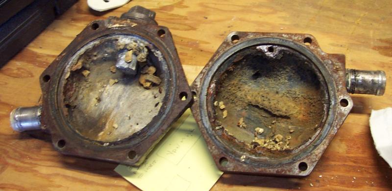

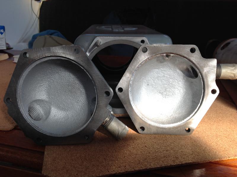

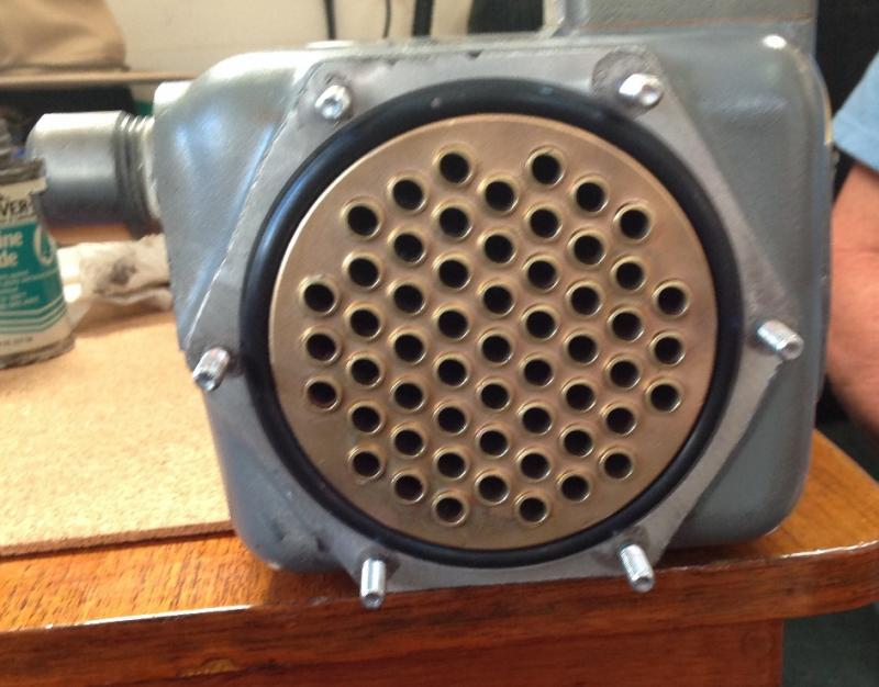

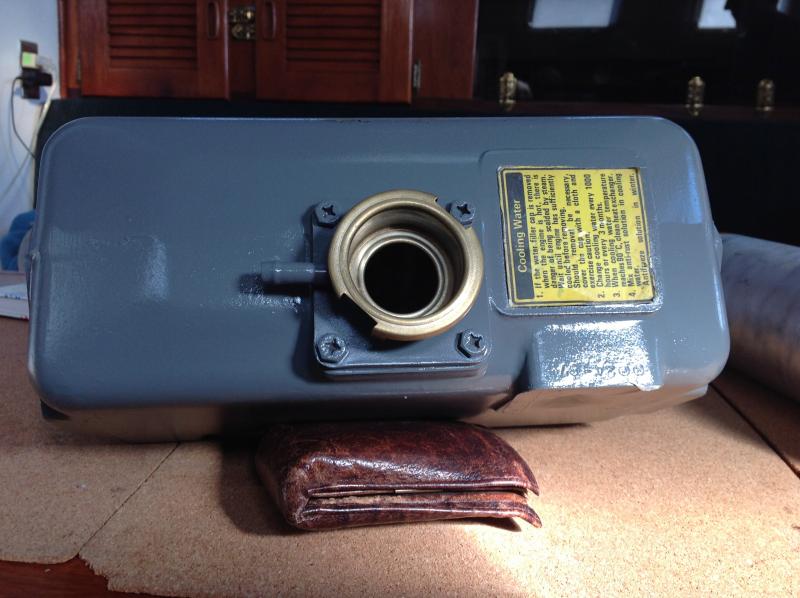

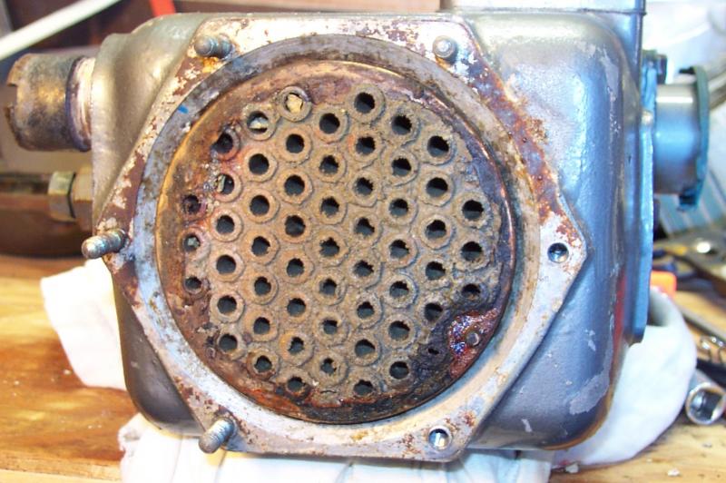

For grins and giggles here are some before and after pictures of my heat exchanger refurb project.
I choked a bit when the radiator shop quoted $176 for cleaning the heat exchanger, but when I got it back, immaculately cleaned, all gasket mating surfaces made perfect and the whole unit spray painted I was very pleased.
My curiosity was piqued about the failure mode of wax pellet thermostats and from what I could discern it is possible for them to stick in any position but most likely closed. I do figure though that if they are in well maintained coolant they will last a long time.
