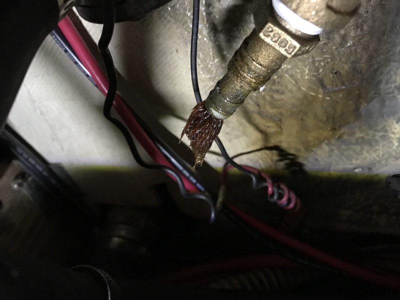

Pulled the hose off the intake side of the strainer and found this:
A clog of grass.
Since the barb is sized for 1/2" hose, then gets thicker to take a 5/8" hose, the ID of the barb must be less than 1/2".
I think my mistake was using the combo barb fitting and I would get more flow and less chance of a clog at that fitting with a true 5/8" hose barb fitting.
I now have on order a couple of true 5/8" hose barbed fittings.
Now on my project list are new gauges with better lighting with visual as well as audible alarms.

While you were changing things did you forget to re-install the strainer on the outside of the hull?
21,102
That looks like a healthy gob of seaweed.
I have tried to avoid the multi size fittings and the 90 degree less expensive turns. Pay the extra and get the full flow bends. Also go with the 3/4 inch thru hull if possible. Water to the engine in volume is better than none.

Cut the 1/2" part of your barb off with a hacksaw, then you will have a 5/8" fitting. I've done it afew times with those "combo" fittings.
That was my first thought but while I was checking for a blockage further into the fitting, it felt like the ID did not get larger where the OD expanded to 5/8".
If I didn't find a 5/8" barb with 1/2" thread I would give that a try.
For your next haul out, consider changing the thru hull to a 3/4 inch.
I may just do that. Another option is to use the 3/4" macerator discharge thru hull which is now a spare.

I see. You can get 1/2 NPT to 3/4 but not 5/8. Wonder what would happen if you used 3/4 for the hose and found a 3/4 to 5/8 straight barb fitting.
Ward H
Nov 7, 2011
3,651
Switching to my 3/4" thru hull/valve with 3/4" hose to a 3/4" barb-1/2"NPT fitting at the strainer will at least put the restriction at the strainer which gives me easier access if the restriction causes another flow issue.
Next time at the boat I'll have to see what I need to route the hose from the larger thru hull to the strainer.
In the meantime I'll replace that dual sized barb to the 5/8" barb I have coming from FS.
