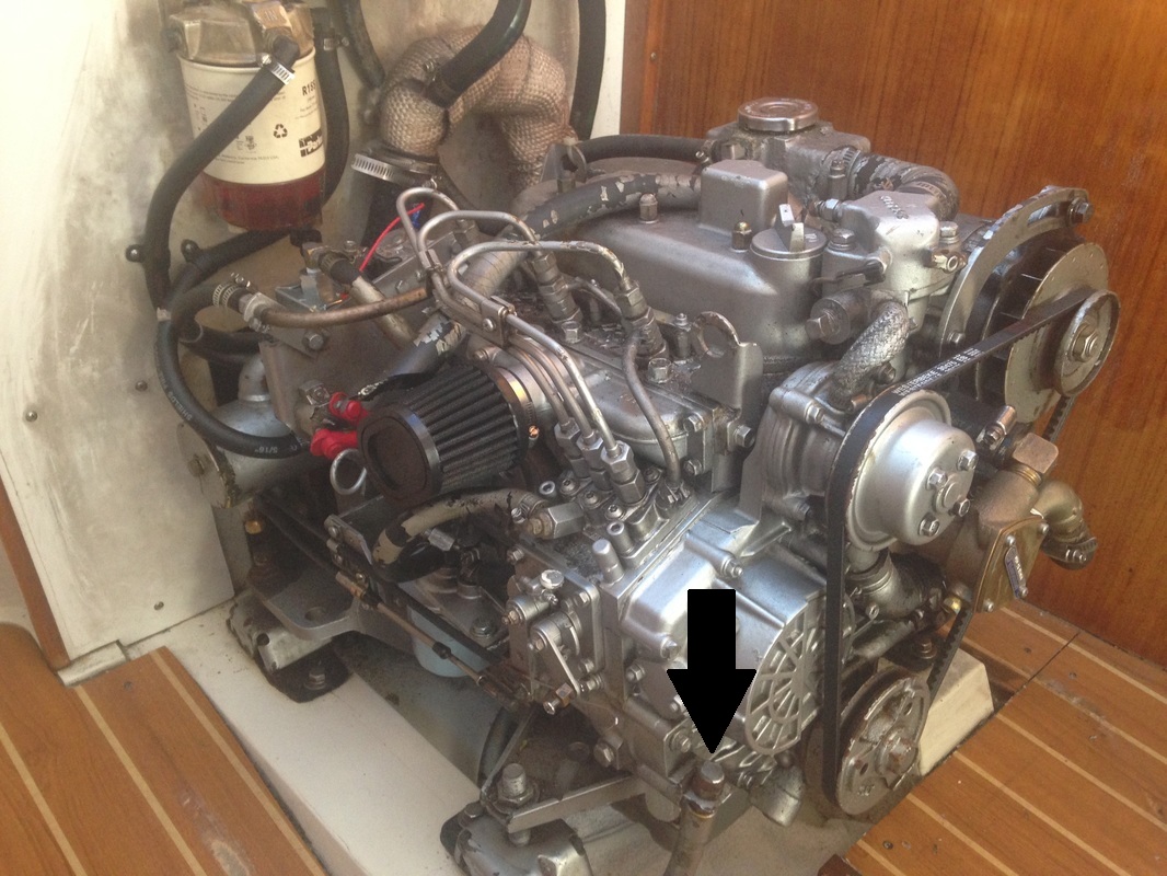

I feel a little silly asking this, but is draining the engine oil on the M25XPB really as easy as uncapping the tube at the front starboard side of the engine and not making a mess? Either draining into a pan or sucking out of the tube should work. Seems too easy.
23,319
If the hose goes to the bottom of the oil pan underneath the engine, then YES! Not so hard. Easier to suck it out than drain into a pan, 'cuz it's hard to make the pan work without getting the outside of the hose all covered with oil. I cobbled together a hose fitting on the end of the hose from my hand pump that fits into that oil drain hose, works great.
