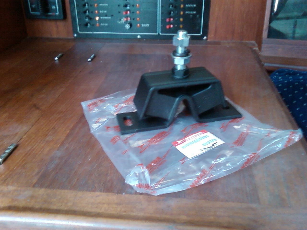

My 410 is now 20 years old. I am wondering if the engine mounts should be replaced. Any advice on engine mount life?
Everything that @kloudie1 says PLUS, if you haven't done an alignment check recently (or ever), notice if the drive shaft axis is much below the prop shaft axis when the flange is first separated. This will indicate if your mounts are failing.they should be close and none less than 1/4"
