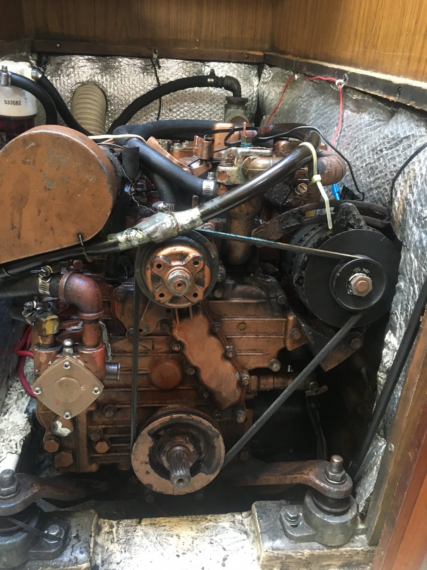

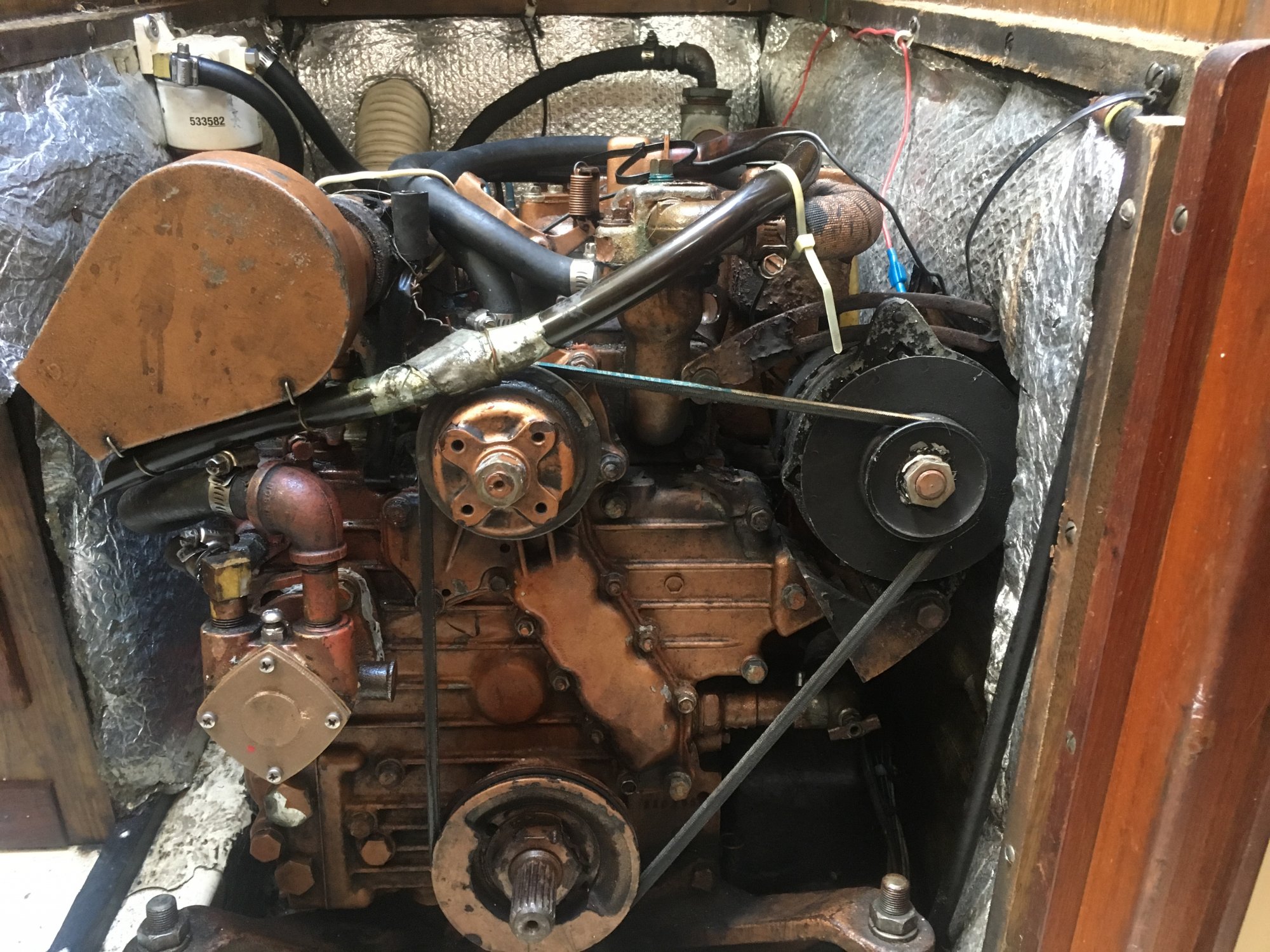

I have a 3 cyl. Universal diesel in my 1982 Allman 31. I am trying to determine the model number. Previous owner is no help. I think it may be an M25 or maybe an M30. Internet search says the model number is on the exhaust manifold, but I have not been able to find it. Anyone have an idea or trick to ID this? I will be needing to get oil and fuel filters soon. (by the way, it starts and runs great)

A picture sure would help.
The model # is behind the thermostat. The exhaust manifold is on the right and has no engine information on it.
This is an M25, 1986.

Bill sorry I cannot see a number on the engine. I did wonder about a hose riding on the engine pump pulley wrapped up with tape. You might want to modify the path it takes so that it does not wear a hole in the hose and spray its contents all over the engine compartment.
