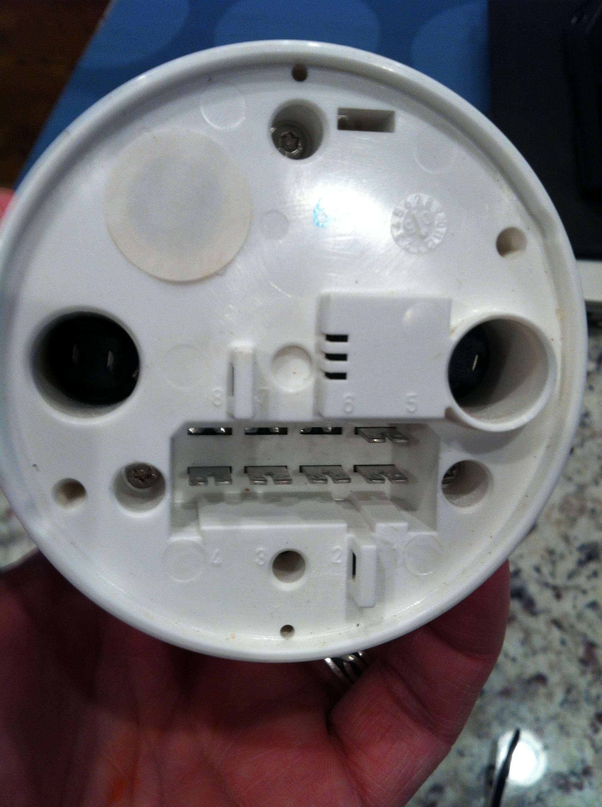

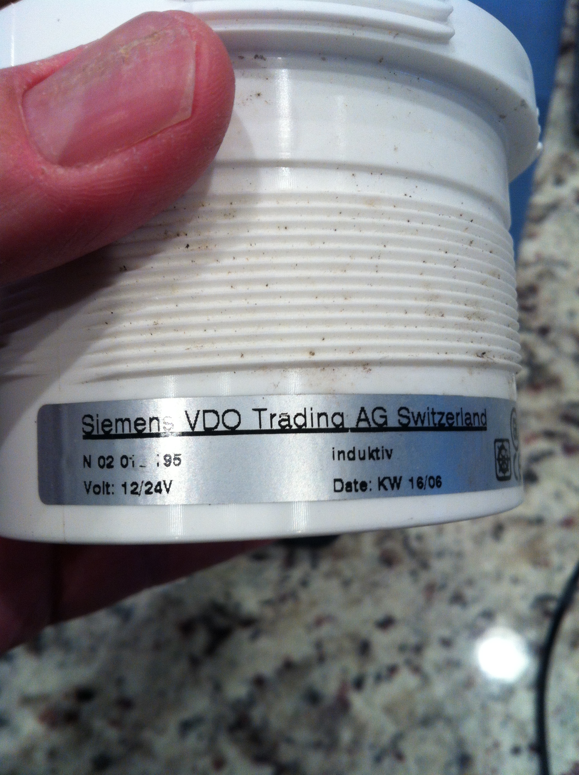

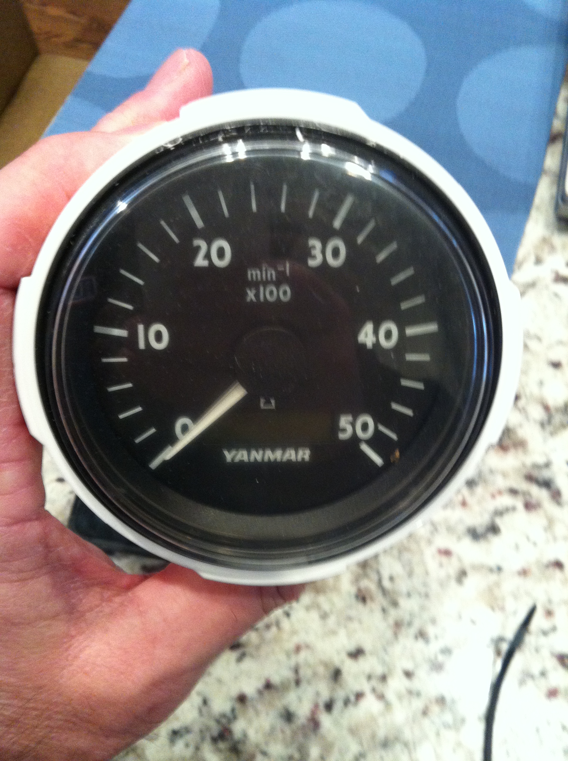

GREAT work! I have the same issue with a (new to us) 2007 Beneteau with a Yanmar and the Mod C version of the instrument panel.
HELP! though. After getting the tach and hour meter gauge out of the instrument panel, I do not know how to get the black dial/instrument out of the white plastic tubular casing it is in so that I can delicately slice/pry off the face plate as described to get to the problem area. I have removed the screws on the back of the white plastic case but cannot seem to get the instrument out of the case. Does the clear bezel screw off? do I have to cut the rubber seal around it? Is there some other trick? Basically, how do I get at it?
Any help is appreciated! Thanks!

Copy all, and thanks. I really like the idea of installing a mechanical hour meter (and would appreciate any advice on the best way/leads to connect it to in order to drive it) and will be ordering one to install, but also thought I'd try this rehab this VDO during these winter months when I'm not actively sailing Second Star.
With that in mind guys, how did you remove the instrument from the white case it is in?
