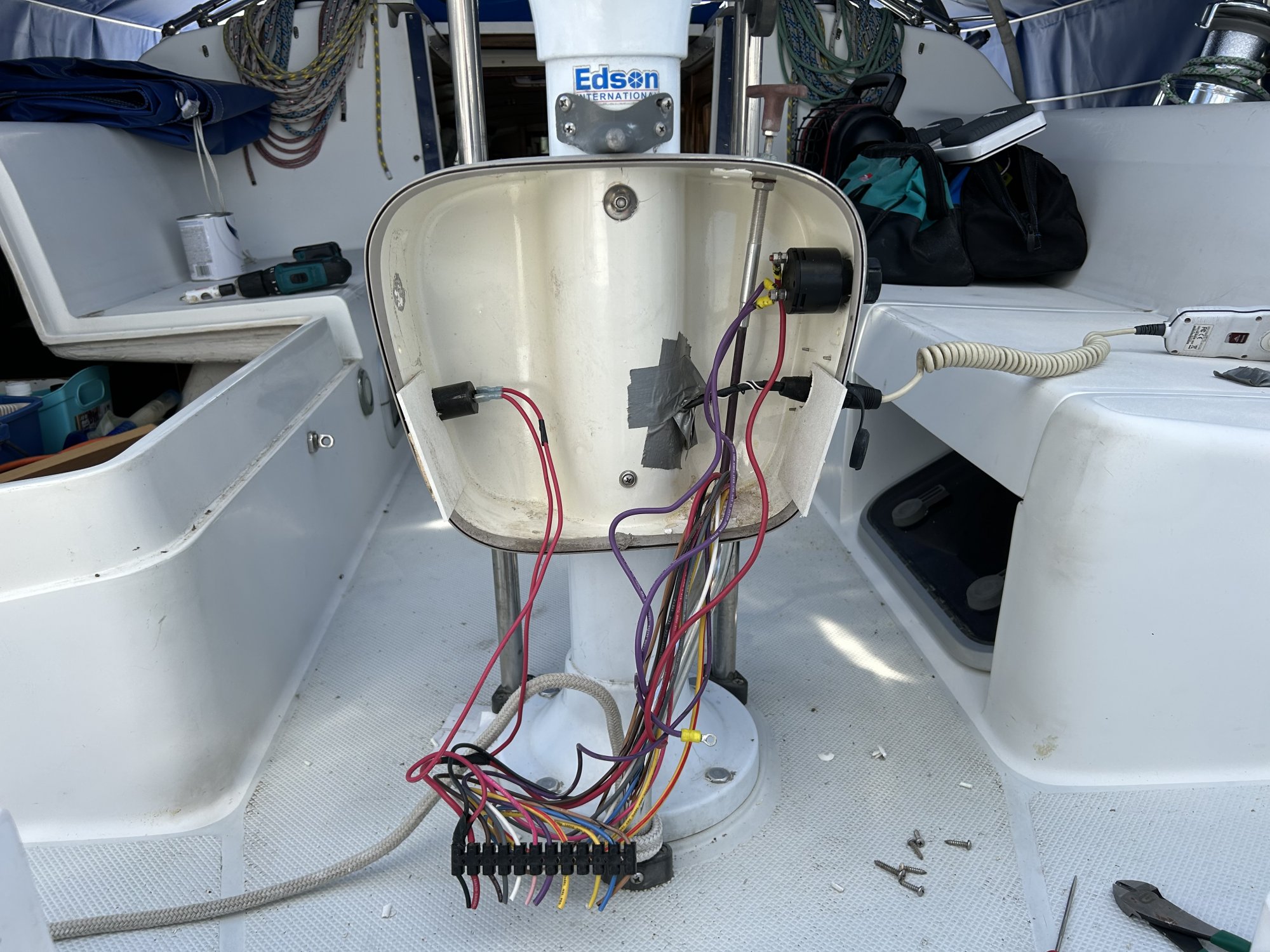

If anybody has ever installed an engine instrument gateway to their chartplotter, I would love to see how it's done. I'm starting with the rat's nest of wires in the insturment pod ...

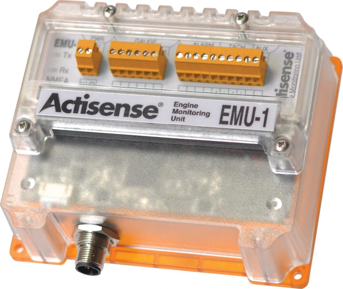

Looks like Actisense makes one - not sure about reliability, durability etc. - just that this is the type of thing you’re lookin* for if you have an older, non computerized motor.
EMU-1 NMEA 2000® Engine Monitoring Unit

Sorry. Just noticed you indicate a 3gm30f. According to the manual electrical diagram there is no digital module - strictly analog sensors so you will need module to interface the analog sensors and then convert/transmit the information to the NMEA 2000.
A search for “ analog to nmea 2000” will give you a variety of options including the Actisense.

Thanks for everything above! I think this takes me much further down the road! I'm still working on cleaning up the instrument pod at the base of the my pedestal and I'm ready to wrap that project up if the weather would cooperate for going down to the boat. March has been miserable so far!

Right ... I'm thinking that all the sensors (including the fuel gauge) I need are already installed. They have the wires leading to my existing analog instrument panel. I just need to pair the wires to the converter in the correct slot and then link to the backbone with a NMEA 2000 spur. I'm a little confused by the ActiSense discussion about a configuration tool (NGT-1). I'm figuring that it is not necessary. It sounds like it is used with a PC for diagnostics and information .... I'm only wanting to repeat the analog readings on my CP for easier viewing.
Actually, alternator output & fuel burn would be really nice to add!
