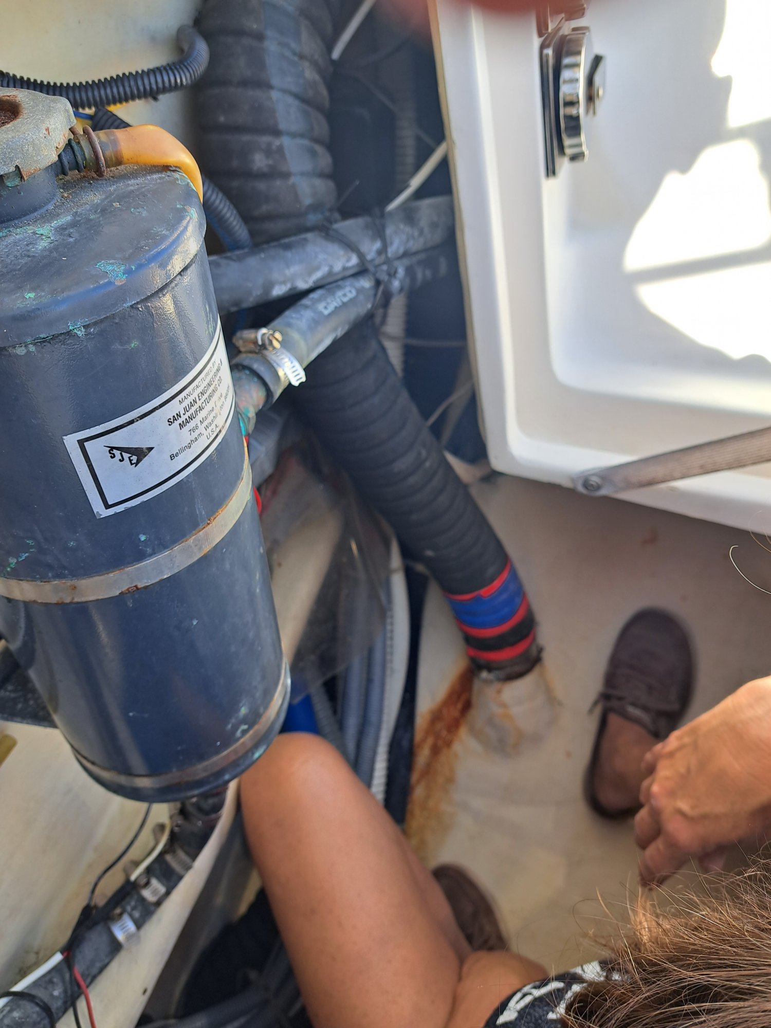

Hi all
Well first a lesson learned. When you store your floaty toys, wash buckets, etc and you notice some rust one them at the first of the season.... investigate it!

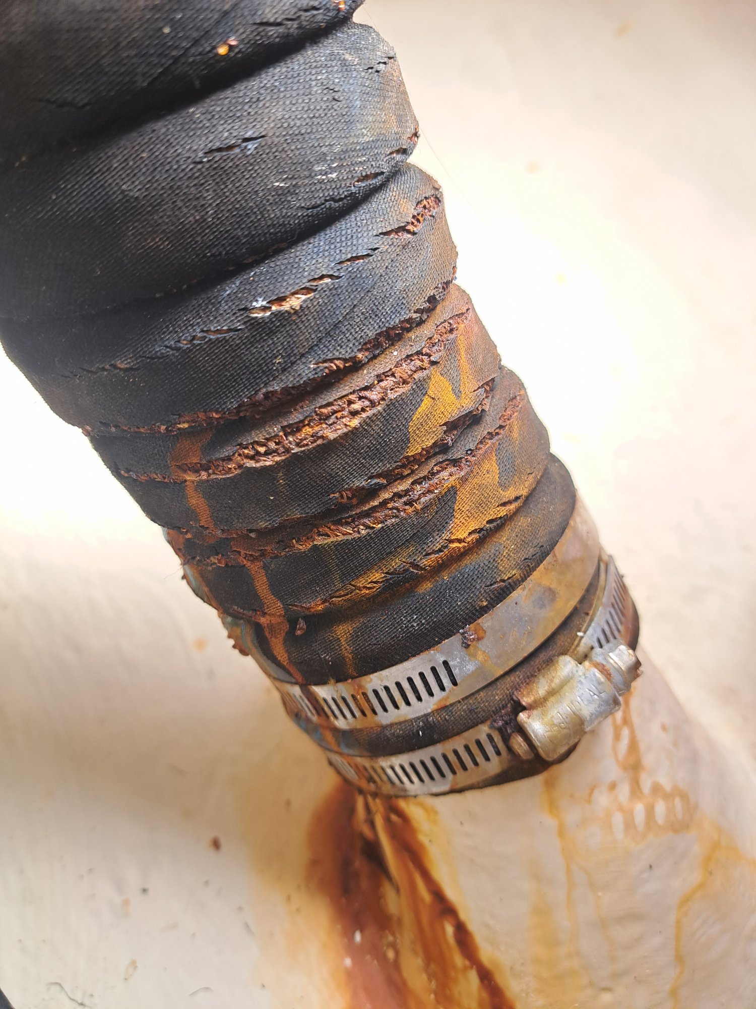

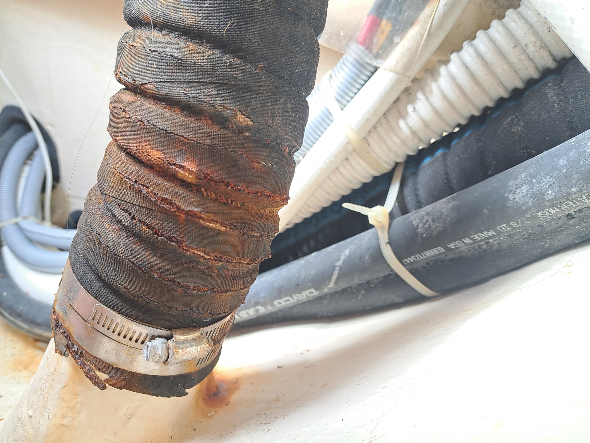

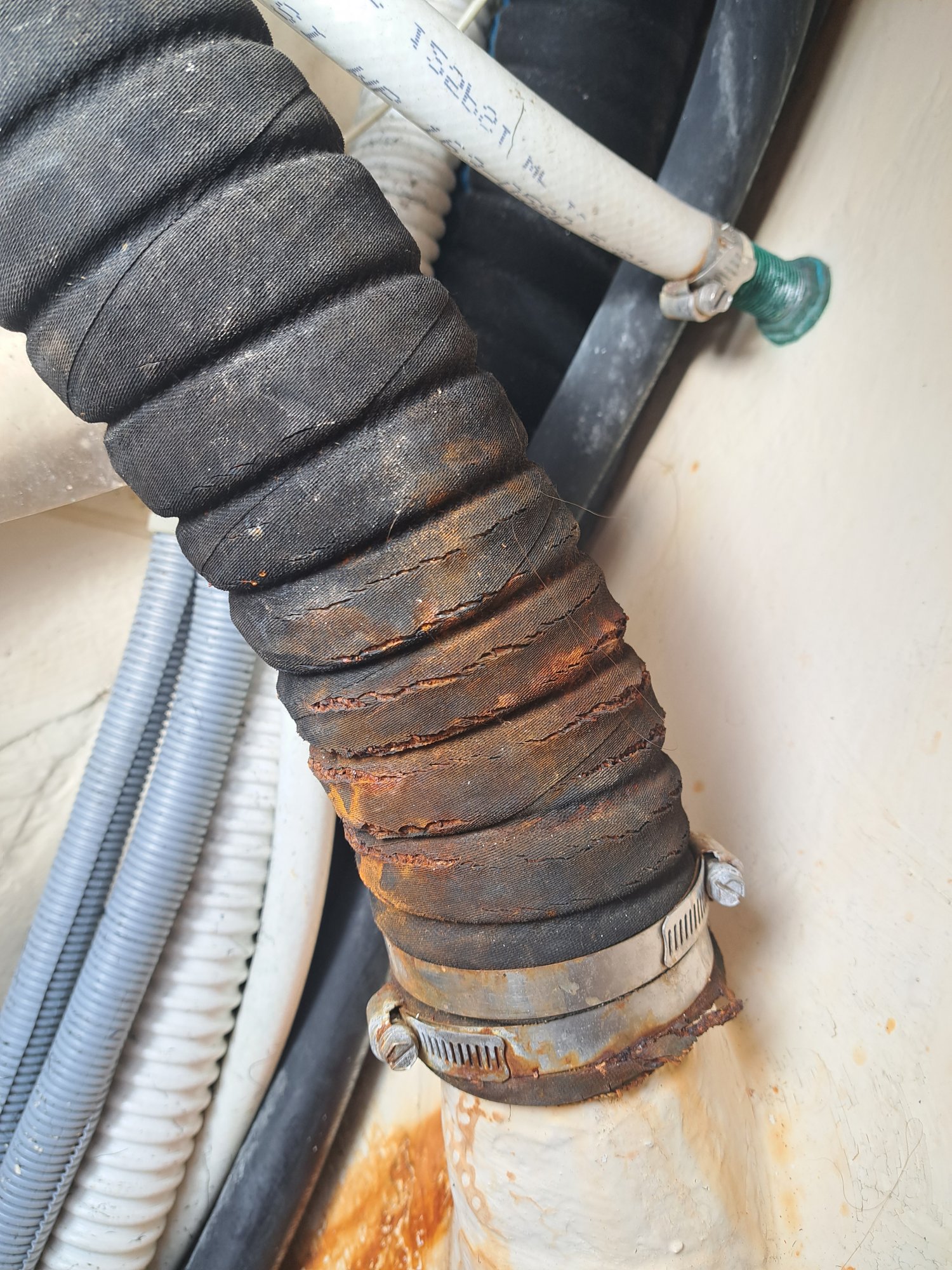

My issue. I have fairly significant rust and some leaking on the bottom of the hose where it dumps overboard and this didnt happen quickly, its been over time obviously. I suspect from bobbing up and down in places like Catalina, etc.
So looking for some advice and thoughts.
If I dont have too, I dont want to replace the entire exhaust host because of expense and the royal pain its gonna be to do. Just not a spring chicken anymore.
Could I cut the hose just above the rust, and then reattach at the exhaust port? I inspected the hose at several places all the way up to the mixing elbow and it looks in good condition. My loop is four feet coming out in the bottom of the lazarette, over the top to just over three feet to the exhaust pipe.
See the pics, and a final note. If you dont have any rescue tape get some. It basically stopped the leak to a drip and we put a good three hours of motoring to get home.
Thanks and happy holidays to all.

That hose has steel wire inside to reinforce it. The rubber has rotted and the wire is showing you need to replace that hose sooner rather than later

I concur it must be replaced ASAP. I just want to research the options I have. The hose shows rot only about 8 inches up if you can use my wifes size 7 as a reference.

I know it won't be a fun or inexpensive job, but what you're seeing is significant decay of a 20+ year old hose, assuming it's original. I'm afraid if you try to replace just a small section now you'll be chasing problems further up sometime soon.
14,278
It is likely the corrosion and rot extends up past the visibly damaged area due to water wicking up the wire. Change the hose.
