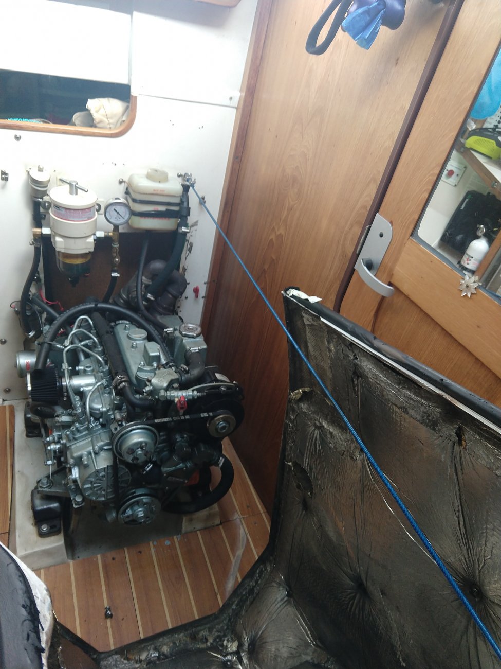

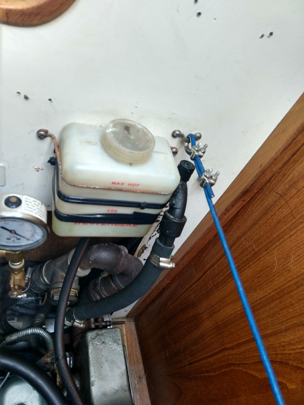

The blue one is new. The original failed at one of the clips so I replaced it. I did move the attachment location as I have been playing around with locations of various components to fit the Racor 500 and upgraded fuel pump (still not completely done with that).

@JK_Boston_Catalina310 your pictures are a gold mine of info when I start really examining them, thanks! I say start a thread with here are my pics, you figure it out what is different!

Like the mirror on the head door? I like it!

I like the location of your fuel filter. I am replacing mine tomorrow, but first I have to move a lot of stuff out of the aft cabin so that I can remove the forward full length cushion to gain access to the filter. I used to completely empty the cabin and remove both cushions, but I read on this forum that the plywood access panels could be cut in half, so that only the one cushion would need to be removed. What was Catalina thinking?
Anyway, your location for the Racor could be a lifesaver when the time comes to change the filter in a hurry.

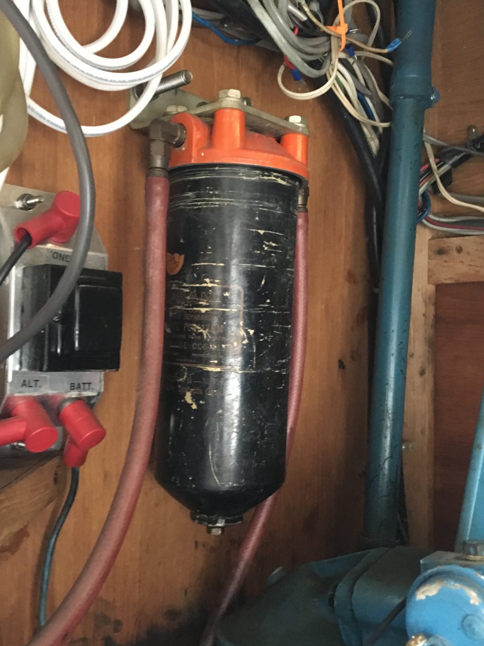

This what I inherited
It was a nightmare to change.

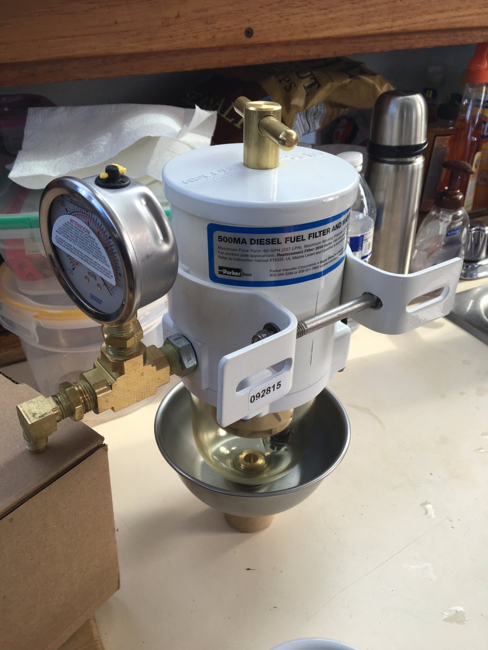

This is what I installed in its place.
It is a pleasure to change.

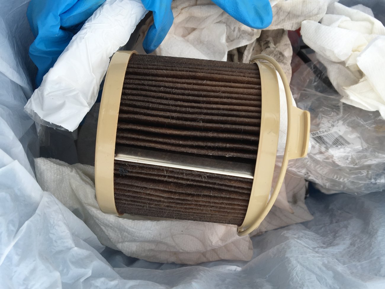

This is what the filter looked like when the engine died...
Fuel contamination.
Now all better.

If you look at jssailem's photos his has the metal bowl. That is the correct one for where I mounted the filter. I need to add the metal bowl but I am having a hard time finding the bowl in the Caribbean and getting parts shipped is hard now that we are cruising again.
I wanted the Racor 500 because of the cost of the replacement filters and the ease of the change. Like jssailem I can change in about 5 minutes.
