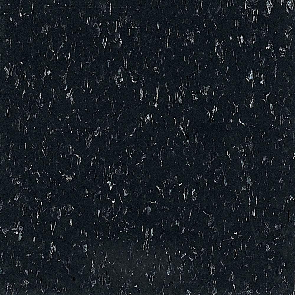

1 - VCT(Vinyl Composite Tile) as the mass layer $.68/SF
The main component of this tile is 85% North American limestone.

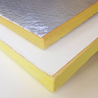

2- Foil faced 1" fiberglass duct board for additional noise reduction

JamesG161
Feb 14, 2014
7,899
Hunter 430 Waveland, MS
Aluminum Tape to seal all of the edge seams
That is my attachment method in my genset compartment.:plus::plus:
I dumped the tack/washer type nails.
The limestone tile is "way cool" add on. I wonder if it gets the "Hummm" reduction award.
Jim...

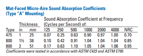

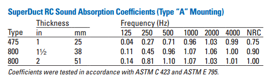

This board is normally used for HVAC duct work. it is stiff, but easily cut. it does not really bend. Below are the acoustic properties for the 2 most common Johnson Manville Duct boards.
