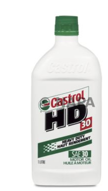

Just checked NAPA site. They have a HD30 Castrol SAE30 Motor Oil.
Thoughts,
Jun 2, 2011
347
Hunter H33 Port Credit Harbour, ON.
Castrol HD 30 meets API S classification :
  • Exceeds API SM, SL and SJ performance for passenger cars and light trucks
Yanmar is specifying API classification CD or better. I would not use this particular oil because it does not meet the API classification CD or better.
I stand corrected in my earlier statement that S indicates spark ignition and C indicates compression ignition. The API document that I linked states S is for Service and C is for Commercial. C grade oils, in my pinion are better quality oils. We also use the C classification 10W30 in the automotive engines.

You want to make sure it is HD oil which is not regular 30W oil. Walmart? and the truck supply places in Halifax carry the Shell Rotella T.

Thanks Guys. I also checked with Marlow-Hunter Tech support and they said the HD30 Castrol SAE30 Motor Oil is good. Any HD (Heavy Duty) 30W motor oil would work.
