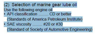

I will check the Tag on the transmission tonight. From the Yanmar Manual:
Not being a mechanic I am somewhat confused wrt which oil I can use.

Thanks for the information guys. The 15W-40 I used has a CJ-4 Rating. I will pick up a 10W-30 for the transmission tomorrow as the stamp had 20/30 same as manual.

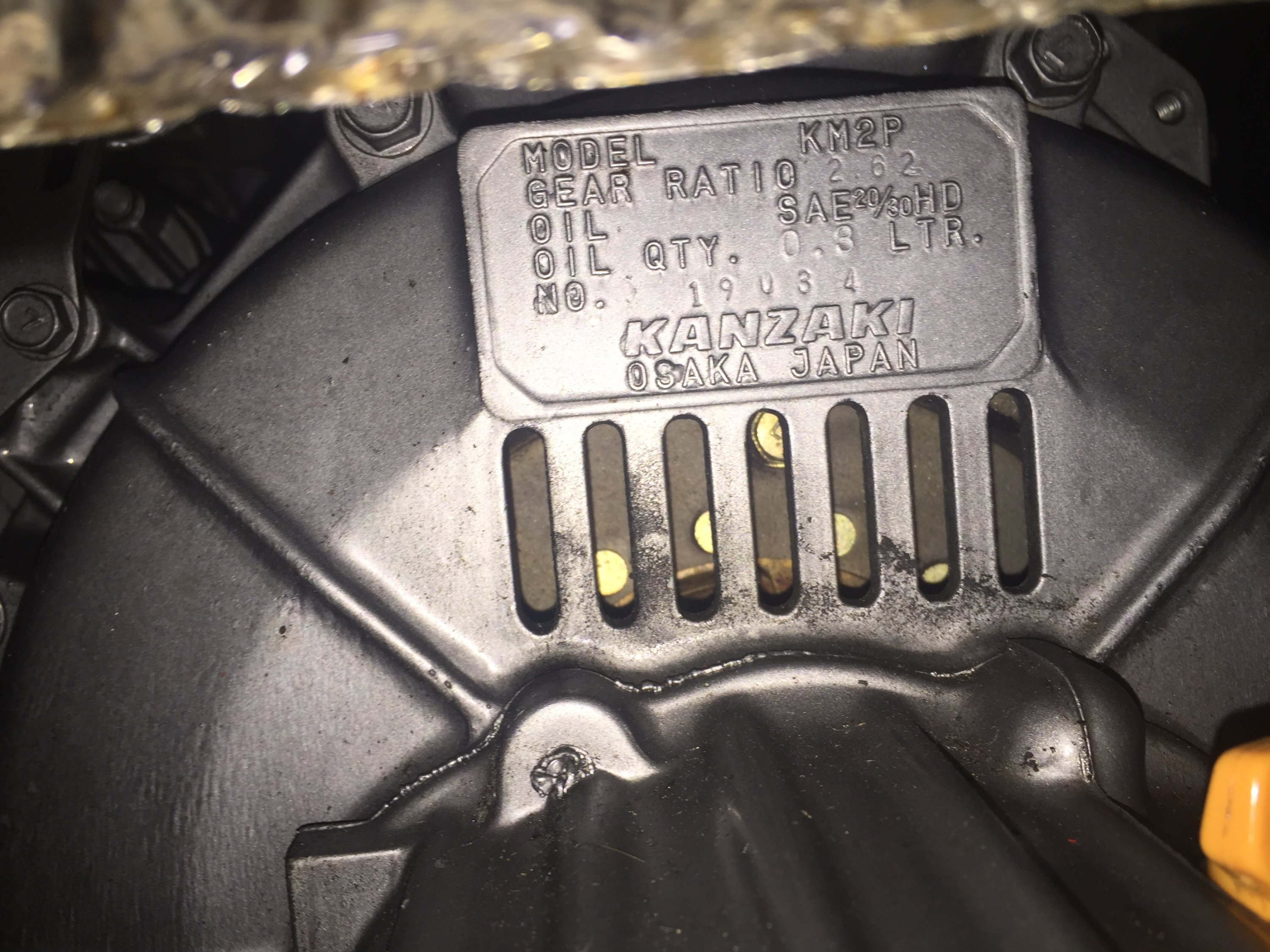

This is the ID tag from the tranny on my Yanmar 2GM20.
Hard to read, but it says "SAE 20/30 HD".

I believe that means an EITHER 20 OR 30, not a multi-grade . go with the manual in post 11. LUBE OIL needs to be decided by the transmission, not by the engine.

The engine manual and the specification plate on the transmission specifically states that 20# or 30# HD gear oil should be used in the transmission. This is not the same oil as 15W-40 or 10W-30 multi viscosity motor oil. Why on Earth would you want to use 10W-30 motor oil in your transmission, when the transmission manufacturer specifically states what you should use??? I use 30# HD gear oil in my 3YM30 gear box as specified by Kanzaki.
