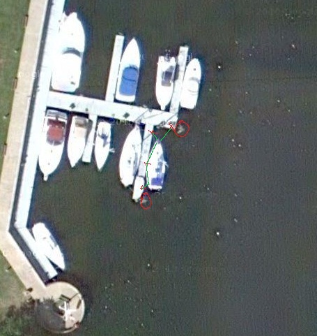

Let me first state that I am located in Stamford CT, behind the ACE Hurricane Barrier (http://www.nae.usace.army.mil/recreati/shb/shbhome.htm), and on a floating dock so any storm surge I get should be largely minimized by the barrier, however I still want to take all precautions possible.
Attached is a google earth shot showing my boat in it's end slip. There are 2 sets of 3 pilings set in a mini tripod shape secured together with bolts through the pilings, and heavy 1"+ steel cable wrapped many times around them near the top. I circled the two locations of pilings in red on the image. I also marked with small red X's where the 4 cleats are that I have available to tie off to.
I normally run a spring line both forward and aft from the dock cleat near midships to the bow and stern cleats (I don't have a midship cleat), plus a stern line, and a bow line from each bow cleat to the available dock cleats, for a total of 5 dock lines. I marked the normal dock line locations in green on the image.
Aside from doubling up these lines, is there any other suggested / recommended things I should be doing here? what about the pilings, should I run a line to them? normal tidal range is about 8ft, so any line ran to a fixed point like the pilings will have to have quite a bit of slack to handle the tidal range expected... What about throwing out an anchor or two, and where should I put them?

edit, forgot to add that there is another single piling directly in front of the bow at the corner of the slip that I didn't mark on the image.

First off, the barrier will have little or no effect on surge. Katrina had a 20' surge for many miles inland. Don't count on it to be of much help. Make sure that your dock lines cannot be lifted or floated off the pilings. Double anchor your boat. 45 degrees of the bow and stern. Being tied to the dock does nothing to keep the boat from pushed up on the dock or pilings. The anchors hold it off. Make sure they are set very good, and tight enough to keep the boat off dock or pilings. Give yourself plenty of slack in dock lines to absorb any surge.
I said should... the Army Corps of Engineers built it specifically to prevent storm surge damage to that area of the city, That said, if I trusted it completely, I wouldn't be asking for additional advice... :)
I'll try to set the anchors, but I have to be careful not to interfere with the channel, big tugs come by pushing/pulling big barges a couple times a day or more, and to get any scope, I will have to set the anchor near the middle of the channel... They are going to close the barrier (which will also close the channel) sometime saturday, so I may be able to get down there and do it then.
how do you suggest I tie off to the pilings? loose to just stop the boat from drifting away if all hell breakes loose, or tight to try and keep the boat in the slip as much as possible?

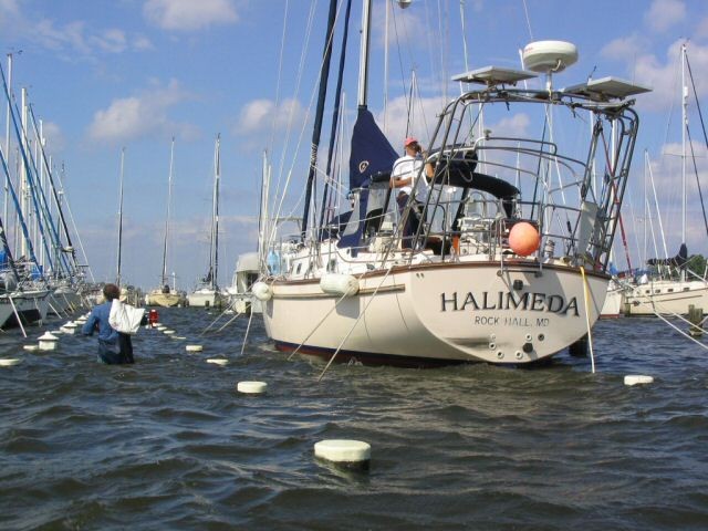

This is a vivid example of what to do to ensure your dock lines are your friend rather than the problem. All too often, people don't allow the boat to move and tie too close to the dock and pilings.

Don, so if I understand, tie the dock lines to the floating dock fairly snug to stop the boat from banging around, but leave the piling lines loose to keep the boat in position even with an extra 5+ feet of surge?
great pic btw, It looks like you are not on a floating dock?

I am with N&E, don't count on the ACE barrier...IMO, the pic shows you pinned pretty hard to the dock. Ideally you want to be clear, by several feet from things that do not move, and to have the ability for the boat to float up and down at least several feet more than the normal tide range. Certainly without the weight of pier/dock sections attached.
That is tough in your scenario. Again as Nice suggests, lay out an anchor to the beam side, as far as you can, and spring/tie to that.
Given the scenario that you have presented and the fact that they will close the channel shortly, I would set two or three anchors and "moor"in the channel. At least you will have room to rise and fall and swing without hitting something, and less chance of something bashing you.
I think I would be more worried about the two big boats against the seawall, being properly tied...because when they break loose or shear their lines...they will move out on the bounce wave against the sea wall...and destroy things along the way.
I would also envision the whole section of floating dock tied to the big boats over floating the piles (they don't look too tall or robust -most I have seen aren't) or coming apart at the joints and as a unit bouncing around like the CA boats did with the tsunami...there was not as much storm surge there as is predicted for this girl.
Much as I despise haulouts, yours may be a case where it is the better choice.
The problem with snugging up the dock lines is impact esp if you have cement docks. Most incidental damage occurs from impact with the docks. I'm sure there is a theory that snugging the dock lines limits movement and thereby limits damage but most of the boats at my marina during the last storm sustained damage because of short dock lines.
