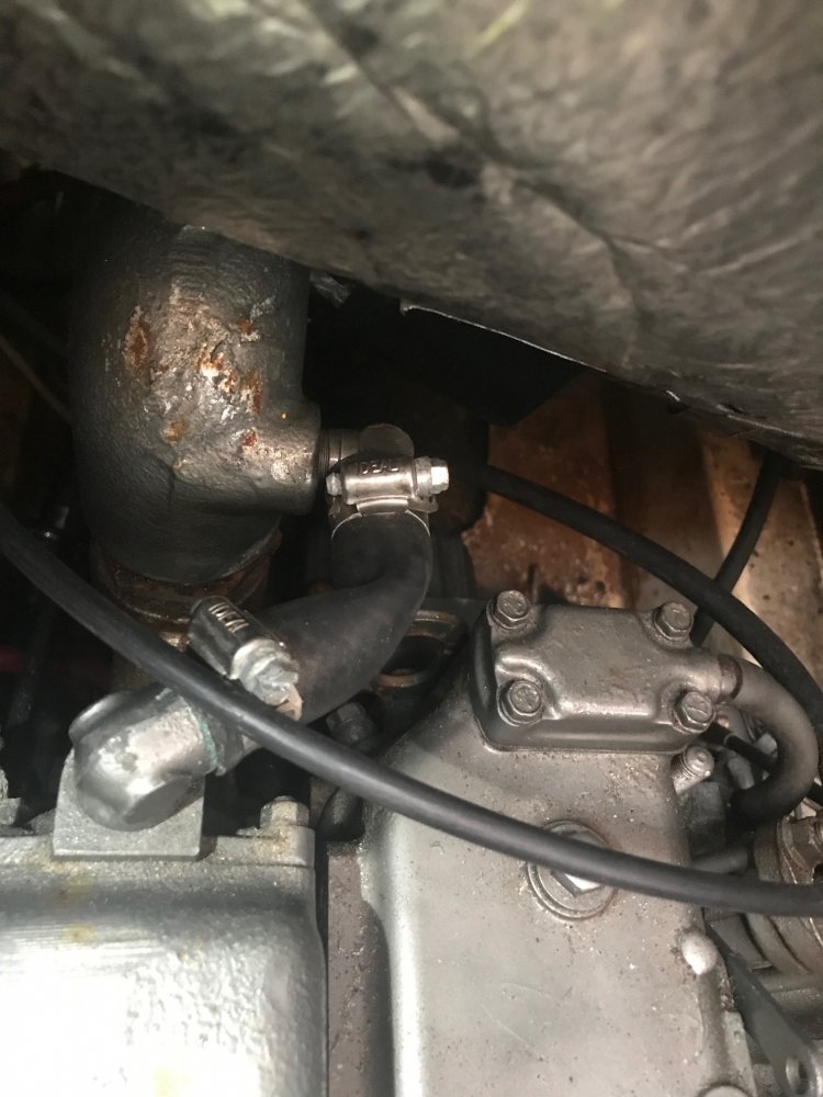

This for sure does not seem to be the correct hose ? looks like a great way to restrict flow. Any part number for this hose as it seems to need a custom bent shape or perhaps a longer run hose ?
10,247

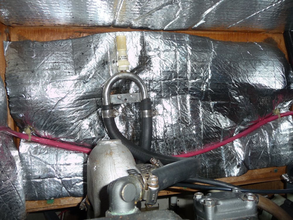

Nope, not the correct hose.. It should have a higher vented loop on the back wall of the engine box. New hose should be run without a kink, which is apparent in that picture.. hose diameter is correct as it carries only raw water. This shot shows the set-up on the H-34. Hose from back of exchanger to vented loop then hose from loop to elbow. Prevents back siphoning from exhaust to engine. cylinders..
Of course you know the H-34 exhaust system, but if there is a waterlock muffler system in place, is it necessary to install the vented loop?
FlyingAloha, it's your boat, your choice, but you can make tighter bends without collapsing the hose if you use a wire-reinforced hose, such as Trident Series 100/250. That would be my recommendation.
10,247
I hear ya, Scott.. but the 34 did not come with a water lift muffler.. There is a horizontal cylindrical fiberglass muffler .. again original but ya don't know whether his boat has had that changed.. The original exhaust outlet is under the stern counter and as soon as any speed is on, sail or power, the stern squats and the outlet is submerged.. again, probably not a high risk of back flooding .. There was/is an original high loop in the exhaust hose just before the outlet.. but not a worry I want to have..
Like it is, his boat.. his choice..

The vented loop that is installed in your photo looks like a very good installation and certainly serves the purpose!
10,247
I scratched my head a bit thinking I'd take the loop out of the system but ended up convincing myself to leave it in.. The valve had stuck open and made a mess with salt water all over the back of the engine.. now, it is on my list to check and I haven't had a problem since.. Amazing how much "stuff" one is forced to learn when ya start dealing with a good old boat!
Good move...:clap:
Especially if you don't shut the sea cock soon after engine shuts down. Closing the sea cock will stop a siphon.
If your flex impeller is even slightly worn, you can siphon back into your engine's open exhaust valve.
The amount of back flow depends difference of the boat's water line and the top of your engine.
