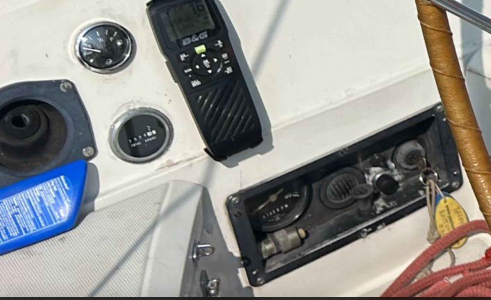

remotes is battery life. The B&G hand set has about an 8 hour life. We were often traveling longer than 8 hours with several overnight and multi-day passages, so we have 2 mics, one in use and the other charging.
We’ve replaced the battery in ours twice in 11 years as the old ones stopped holding a charge. Last time we were able to get a replacement with a few more mAH that still fits in the case. With that we routinely go for 9 hour day sails and still show more than half battery life at the end of the day. If you want to do overnights though you’d probably still need a backup handset.

I didn't mention earlier, a significant drawback to wireless remotes is battery life. The B&G hand set has about an 8 hour life. We were often traveling longer than 8 hours with several overnight and multi-day passages, so we have 2 mics, one in use and the other charging.
I mounted the charging cradle for my H50 remote mic in the cockpit and ran power to it….so when using it, it is close at hand AND it is being charged. I store it at the nav station when not in use and can charge it there with the USB port on the back (but I don’t usually need to do this if I am sailing often.
I suppose you could charge in the cockpit using the USB port, but I like having the radio in the cradle at the helm.
