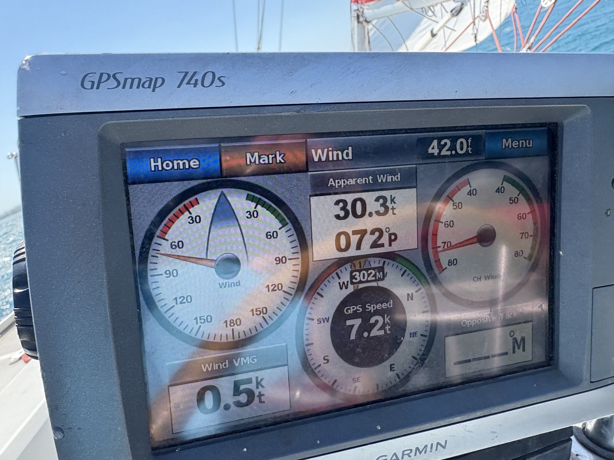

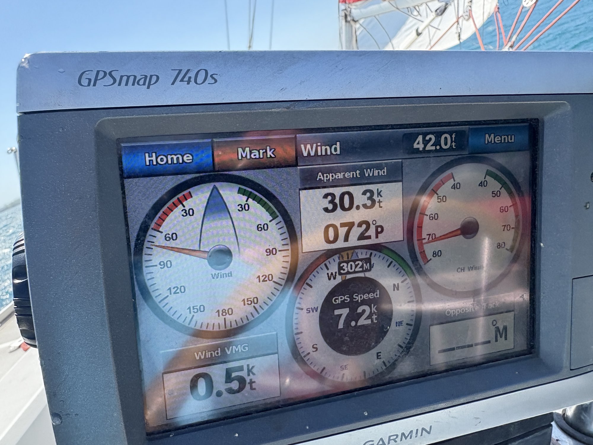

My setup is far from perfect, but I find it very functional for my use…but YMMV.

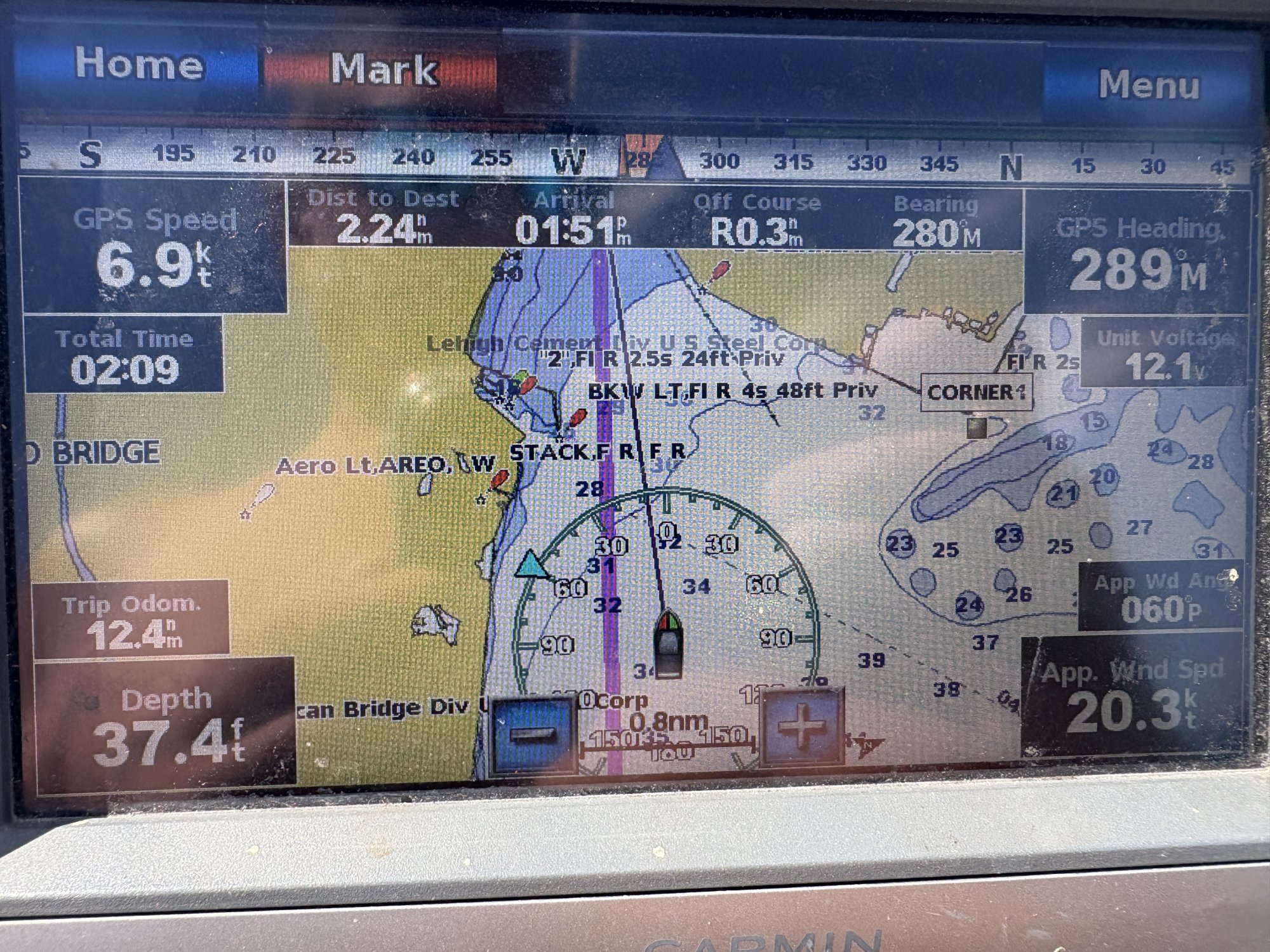

I have a Garmin GPSMaps740 Chart plotter. It has built in GPS, Depth and water temp. It does not provide Speed through the water though. I am on Lake Michigan, so no tides or other currents to take into consideration, so I am ok with no Speed through Water.

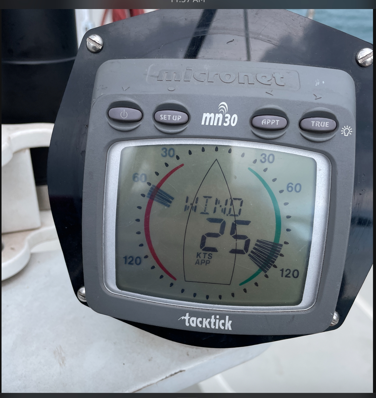

I have a Raymarine wireless wind anemometer on the mast, and a wind display at the helm. I added a used Raymarine wireless interface (N0183) so I can put the wind info on the chart plotter and use it on my Raymarine Autopilot to hold a wind angle.

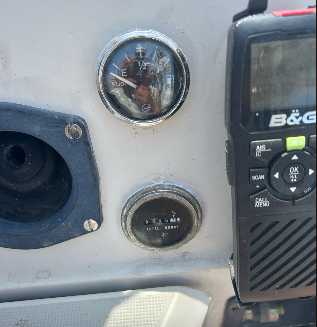

Finally, I bought a B&G V50 VHF with an AIS receiver and a wireless remote that I mount at them helm when I am on the boat.
I have a N2K network that ties the Garmin CP (depth, speed, heading, GPS, etc), the wind info, the VHF (AIS info) and a Raspberry Pi I am playing around with.
The CP can display charts, or a wind screen that I really like…

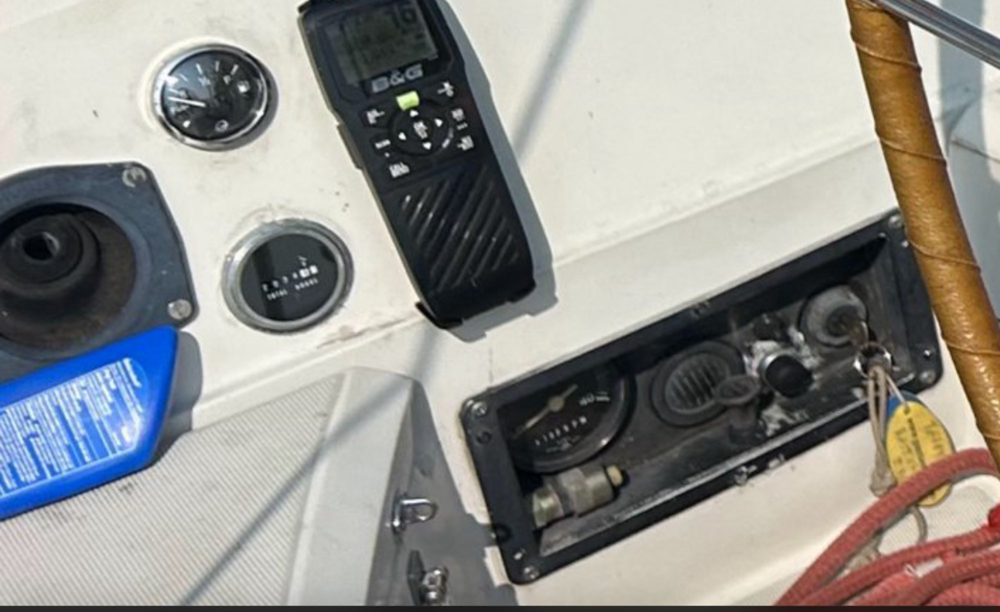

The radio is down below but has a wireless handset that makes it completely usable in the cockpit, with the benefit of still using the masthead antenna and not just the small whip on a handheld VHF. The only drawback is that the volume range on the wireless unit isn’t great, so hearing transmissions when motoring sometimes means picking up the handset to listen.
We have a B&G VH60 with 2 wireless handsets. To deal with noise in the cockpit we added an external speaker in the cockpit. This helped a lot, however, it rendered the handheld remote mic useless because the radio did not shut off the speaker when broadcasting from the remote mic. It was very confusing to hear your voice echoing while speaking and there would be occasional feedback. The speaker on the radio does echo when using the mic, but it is not very loud and not distracting. Actually, it is sort of nice as you know the mic is working. Other brands of VHFs might not have the same issue.
Otherwise I do like the B&G radio. The user interface is easy to read and the menus are pretty straight forward, in contrast to the Standard Horizon I replaced. If I were to buy a new VHF I'd take a serious look at Icom.
