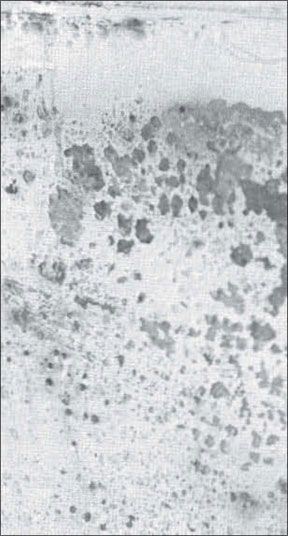

I hauled out to paint and have discovered extensive pitting on the iron keel. I had remarked to those pulling the boat how good the shaft zinc looked. It seems the keel is used as the negative bus. Any suggestions for a more appropriate arrangement to stop the keel corrosion?

My guess is the keel barrier coat failed. Same thing happened to my Hunter 46 due to lack of maintenance by the seller. Yard sanded the entire keel to remove corrosion products and pitting to bare metal, then applied 5-7 coats of epoxy barrier cost then antifouling paint.

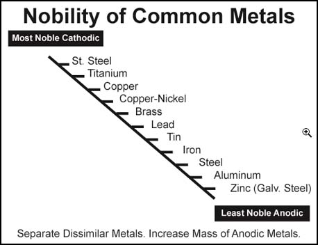

"Sacrificial" zincs are on the bottom of the nobility scale so if installed correctly should be the first to go. The fact that yours is in good condition would indicate that that is not the case. Building a protective system is a complicated issue (Nigel Calder's Boatowner's Mechanical and Electrical Manual has a fairly extensive chapter on this).
