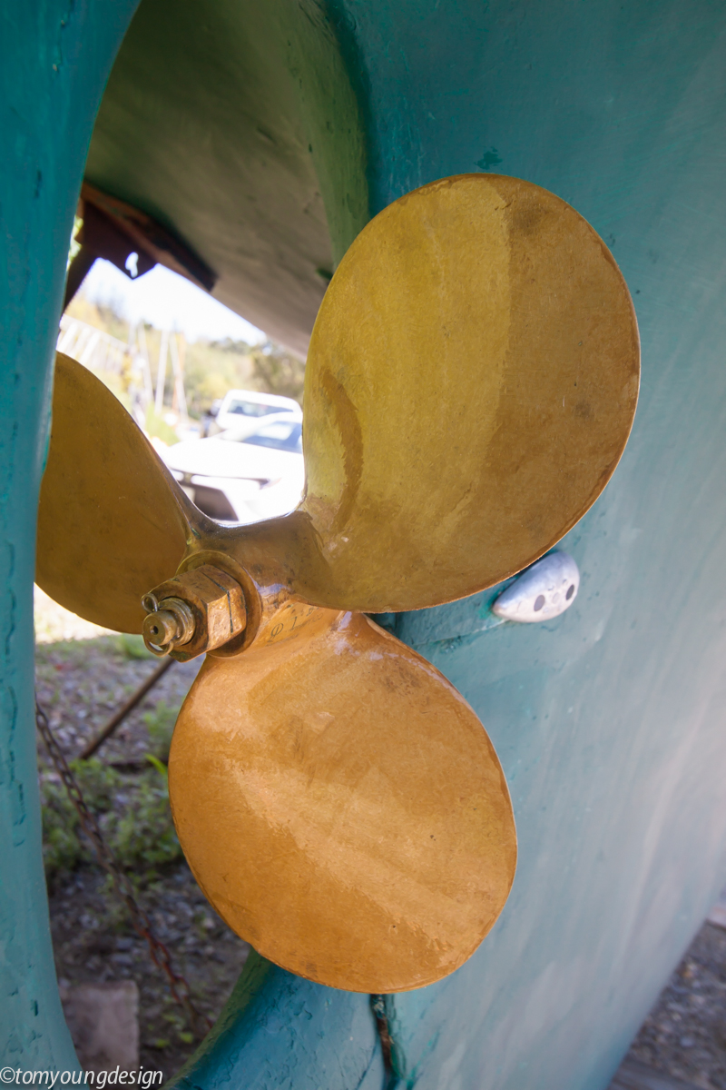

A curious thing to me about electrolysis is, why do most people have no real problems with it? Is it because many of us are floating on moorings, not involved in shore power issues and nearby boats?
I've owned 3 sailboats and can't really recall an electrolysis issue beyond the simple degradation of corrosion which is a far more severe concern in the salt environment.
Books have been written about bonding vs not bonding. I don't see evidence that bonding matters (I've had it both ways), as long as electrical systems are correctly wired.
I have two zincs, conceivably making an electrical connection to the bronze shaft log, but isolated from the shaft- SS, and the prop - bronze, due to cutlass bearing rubber.
One zinc is usually partially eroded, the other minimally(?). The only other zinc is in the HE on the engine. This HE pencil zinc is always entirely eroded away each spring (I don't check mid-season), when I install a fresh one. That HE is ancient, possibly new in the 70's (I swapped it with a re-power).
I have no room for a prop zinc but the prop, at least 45 seasons old, has suffered no electrolysis.
What gives here? Outside of extreme examples of ruined components due to dockside shoddy wiring examples, is electrolysis a boat problem, or more an owner problem?
