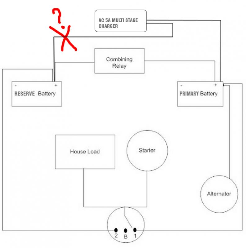

From my 110AC source I have a West Marine 5Amp multi-stage charger which appears to have two white cables, one going to each battery, and a single black one that goes to one battery and obviously loops over to the other battery.
I can't find a manual for it, and so I'm curious if I wire the alternator to one battery, and use the combiner, do I need to remove the battery #2 output leg from the AC charger? I've attached a diagram how it would be connected:

Yes, that's right, remove it. It will avoid the relay from "chattering."
Yandina: size the unit based on what your charging sources MAY BE IN THE FUTURE. In 1998 I bought a 130A model (only 70 & 130 were available back then). I didn't install a 100A alternator until years later, but was glad I got the right sized combiner back then.
