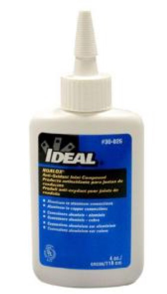

Well you could use a product called Noalox. You can get it at HD. It's an anti-oxidant paste used when connecting aluminum wires. Should be what you are looking for.

Yeah your on the right track
Will have to phone the company to see if the product is compatable with the tinned copper and such connections on our boats
The word aluminum when talking about electrical connections is like stepping on a land mine such the need to check
