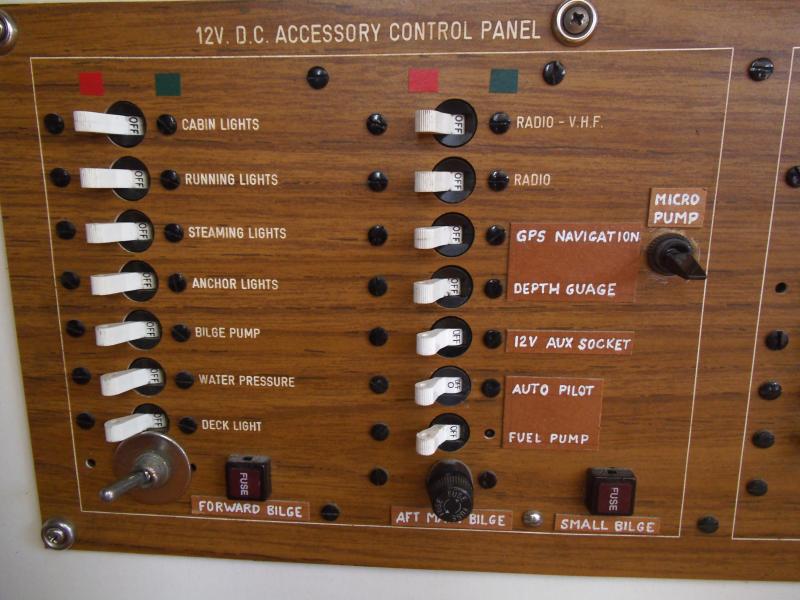

Another option -- see the attached photo.
- From your local stationary store buy a sheet of color matching cardboard and a white pen,
- Do a reasonable attempt at duplicating your existing panel's font with your best grade school block letter penmanship,
- Use a spell checker so you don't spell something like GAUGE as GUAGE as I did,
- Spray several very light "wispy" coats of flat or egg-shell spray can clear lacquer or clear fast dry polyurethane to make your label water and dirt resistant,
- Use a sharp exacto knife and straight edge to cut each label to size,
- Use double-sided clear tape to affix to your existing panel's surface (sail maker's type works well).
