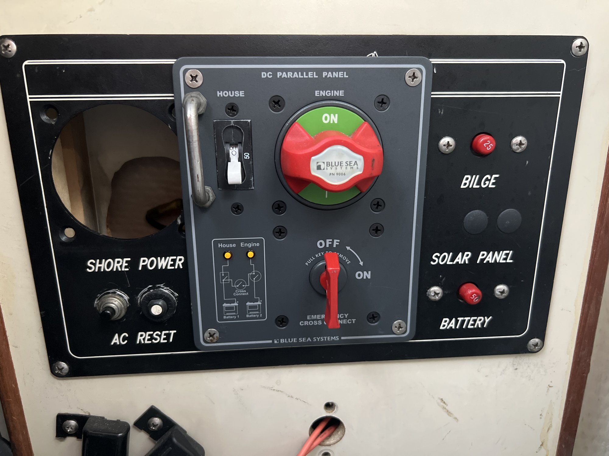

I have a DC parallel panel patched onto whatever panel came with my 1993 Hunter Legend 35.5, and it is full of mysteries. Most recently, after replacing my batteries, I wasn’t getting DC power and determined the “house breaker” on the DC parallel panel was no longer working. As we were leaving that day and I couldn’t source a 100amp breaker to replace it, I settled for a 50amp and hoped for the best. Now, when plugged into shore power, the same house breaker trips and won’t stay on for more than a few seconds. I’m not using much amperage - why would it trip when connected to shore power?
I did notice that when I flip it, the voltage to the house battery goes up slightly from 13.2 to 13.3, volt and the starter battery goes up from 12.55 to 13 bolts before the breaker trips. And they settle back to 13.2 and 12.55 respectively. It seems the house parallel panel house breaker is the conduit for the AC charger to charge the starter battery, and the amperage drawn exceeds 50amps?
See image for the “house” breaker referenced.

I dunno, 50 amperes at 120V is 6000 watts which is 500 amps at 12 V way more than a charger would be doing.. The breaker is tripping for some oher reason. Is it a ground fault breaker?? I think you'd see smoke if the breaker is tripping at 50 amperes.. I'd be looking for something that happened during battery hook-up. New breaker could be baad too.. not unheard of. Time to break ouut the multimeter..

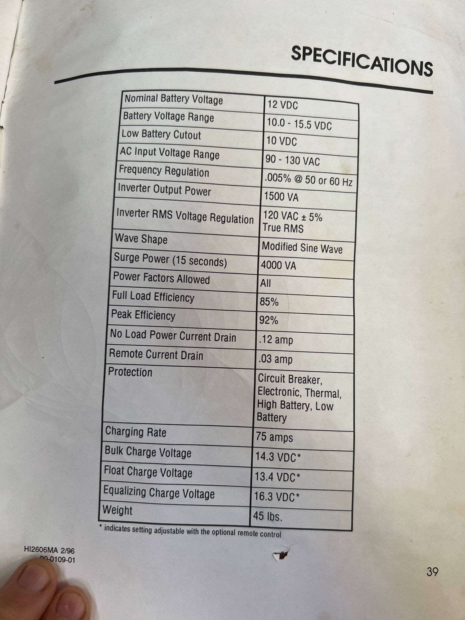

How many amps is your battery charger rated to output? That seems the most likely culprit.
It's a West Marine WCU-15, rated at 75 amps. The house breaker was formerly a 100amp breaker instead of a 50amp breaker. Maybe the full charge is routed through the house breaker, causing it to trip?
Yes, that seems like a good possibility. But +1 to Stu’s advice to trace the wires and make a wiring diagram. Everything will be much more easily understood after that.
Chargers are generally rated in DC output, and that breaker looks like it’s on the DC panel, so I assume it’s popping from DC current, not AC.
