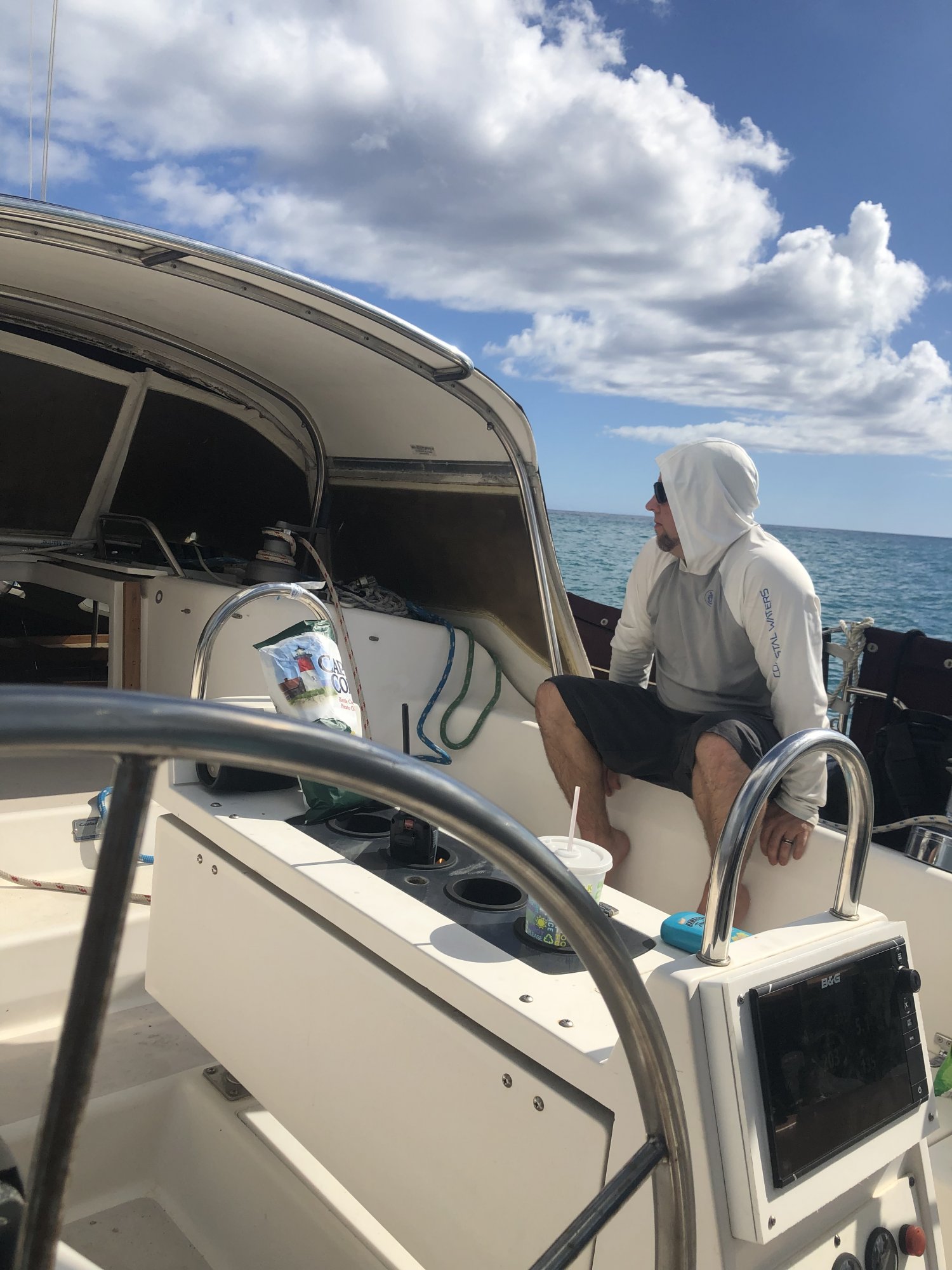

I just purchased, well the check is on the way from the lender, a Catalina 400 mkii. The owner added an electric winch mostly for the main halyard but didn’t wire it up. He has the selenoid and switch I believe in the store room. I’m wondering if I need two gauge or one gauge. The distance from the winch to the bank is about six feet. The winch is under the dodger star side. Maybe just need some insight to get me started in the right direction on this project. I’m also wanting to buy my own crimpers so I can make my own cables till I die. Mahalo
