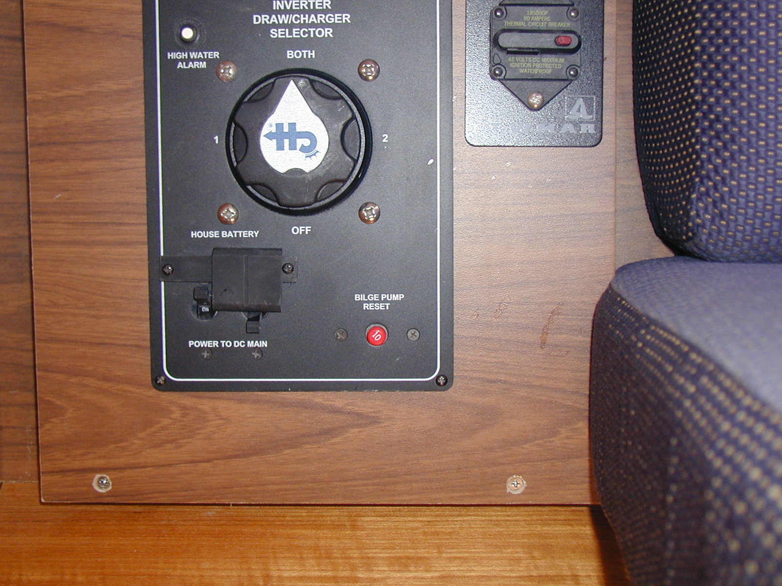

I've tried every position possible with the switch under the chart table. This boat has the inverter installed. Is there a main breaker reset for the DC panel?

You don't say how your house and start battery system is setup,I have a inverter charger
also and have 2 circuit breakers on the bottom of the 1/2-both switch that is to change between my 2-4D's and each breaker turns on witch house battery to use.
Do you have these breakers because either will shut down each battery from the house
but my system did not come from the factory with a start battery just the 2 house batteries
and they were wired to start the engine.
Maybe like me I changed things up to add a start batter,do you have a manual and if so check the battery page.

I just looked at my manual and with or with out inverter/charger it shows 2 battery system
and so like me changed things by adding a start battery.
Check for the breakers on the 1/2-both panel and those breakers will control power to the main DC panel and depending how the start battery is wired you should have have power to the key even if no power to main panel.

Our 2005, 38 has a breaker between the 1,2 both rotary switches for the DC panel that needs to be on to get power to the panel and then on elsewhere. I downloaded the panel diagram for the 2005 36 and it shows breakers below the big rotary knobs on each panel. Have you tried these?
May 8, 2016
14
Hunter 36 Catawba Island, Ohio
Yes, I have tried the breakers to no avail. The best hypothesis I heard so far is the lack of a ground to complete the circuit. On my next trip to the boat, I'll be certain to have my tester with me!
