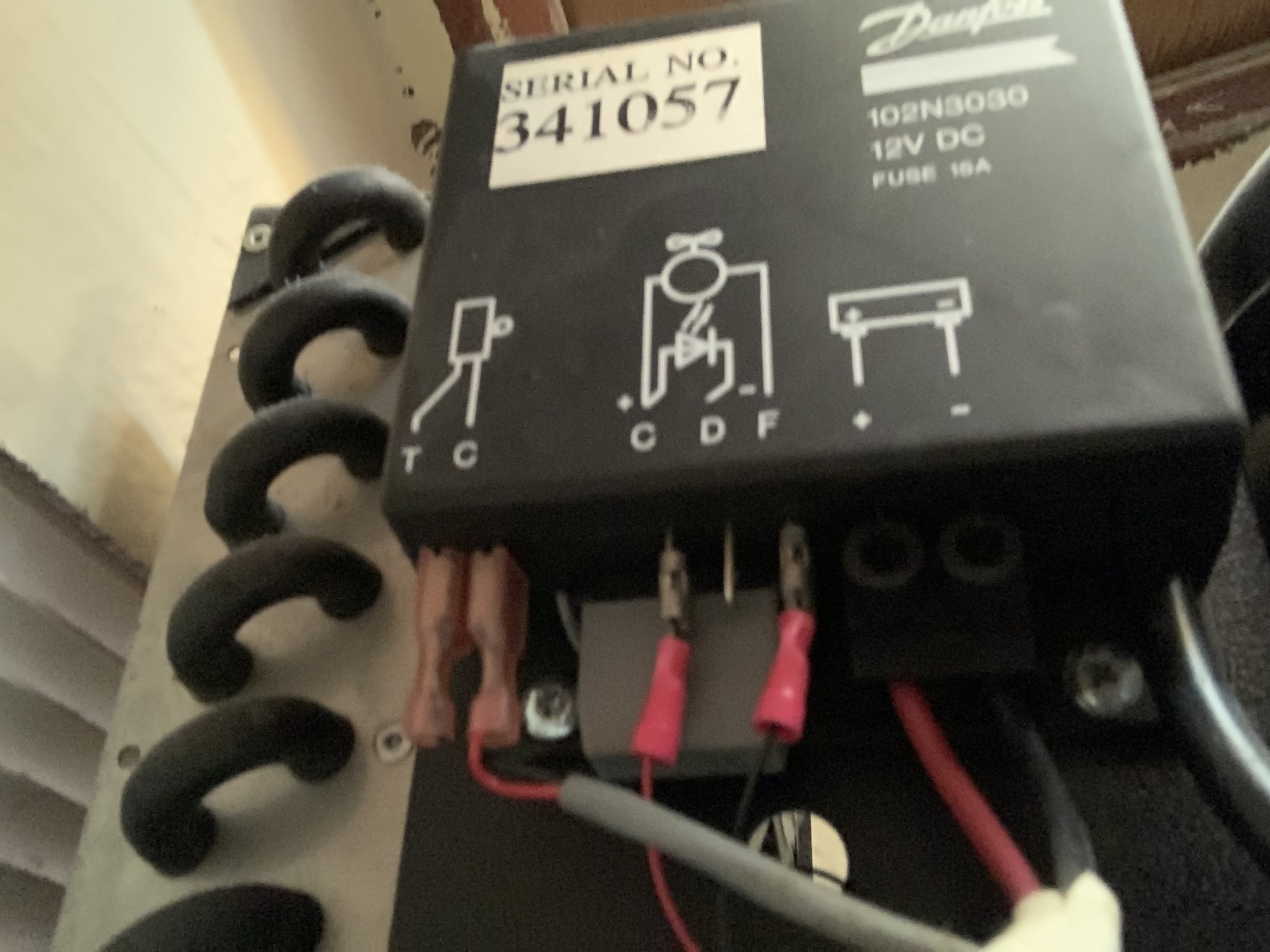

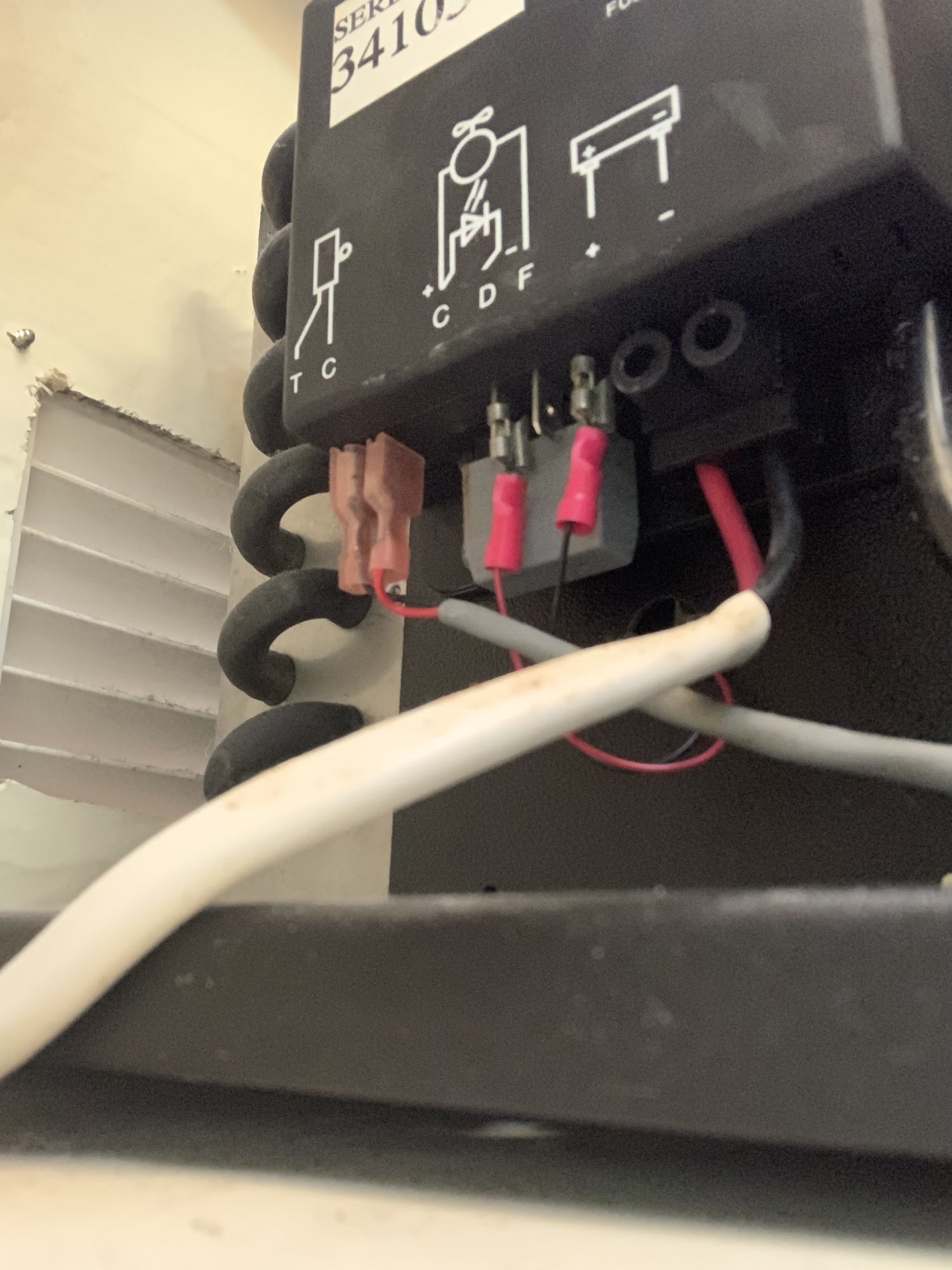

Thanks for timely advice, attached a couple of pics. Looking at these I don’t see what would be a 15 amp fuse unless it is the
salmon pink leads on the far lef

Perfect. You're off to a great start.
The first wires we want to look at are :
the red one and the black one. The small B&W picture above the wires is your battery showing the red wire as positive and the black one as negative.
Now comes the multi meter. Do you have one ? You need one to tell if the red wire has power to it.

Thanks. I have purchased a multi meter and am learning how to use it. I’m a bit intimidated around electrics as you may guessed. Do I have to pull these wires out to check?

I don't fully understand the lable but I am noticing the word "fuse" here... I can't quite make out the manufacturer but I'd suggest googling the name and see if you can find a description or users guide

If you can get the tip of the multimeter probe to touch bare metal, that is good enough. Poke the probe up in the slot where @Ralph Johnstone suggested in his earlier photo crop.

In this photo you sent at the far left is a symbol and the letters T and C. Would this be the 15 amp fuse?
your prompt response and advice are appreciated
What you are looking at is the control unit for the refrigerator. The "T-C" connections are for the thermostat, the middle connections are for the fan and pump, and the last one is the power.
Here's a link to a replacement that might help. Search for the model number, 102n3030 and the manufacturer Danfoss.

Dave just identified the control unit just as I did! I'll suggest that the reference to a 15 Amp fuse is simply the instruction to use a 15 Amp fuse for safety in direct connection to a 12v battery. There isn't a fuse built into the unit, I think. Since your wiring connects the unit to your breaker panel, your 15 amp breaker serves the purpose (you are not directly connected to the battery as the wiring diagram for the unit describes with a 15 amp fuse). Your power connection is clearly the larger pair of red and black wires. It should be very simple for you to determine with a multimeter if you have power to the unit. If you disconnect the wires and touch red to black, you will get sparks and possibly burnt insulation so don't remove and touch the wires together. You can shut your breaker off and then remove the wires to avoid the fireworks. Just don't touch them together with the breaker on. If these simple procedures make you uneasy, then get expert help.

The fuse (15Amps) should be between the power source and the control unit.
I suspect this unit has the manufacturer saying before the power source enters the control unit, to protect the control unit. This chafes on the electrical rules of AYBC. Fuses are designed for the wires not the hardware.
The attached manual has voltages of the various connections to help you identify if things are working.
