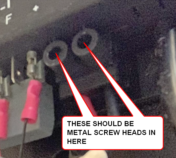

@capseaquel , if you stick your multimeter probes in the holes shown below, you should be able to get a reading as the metallic screws will conduct any voltage. What have you seen so far for voltage ? ? ? ? ?

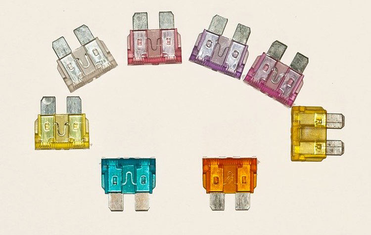

Looks to me the fuse might be in that small gray square box below the connections called C D F on the photo in reply 6.
I would try pulling that out and see if there is a fuse in there.
maybe one like these.
Thanks, I did locate the 15 amp fuse tested as a good fuse on the multi meter. I did the multi meter check even though my visual check had shown the curved wire was intact

Now that you've become proficient with the use of the new multimeter, what have you seen for voltage coming into the controller ?

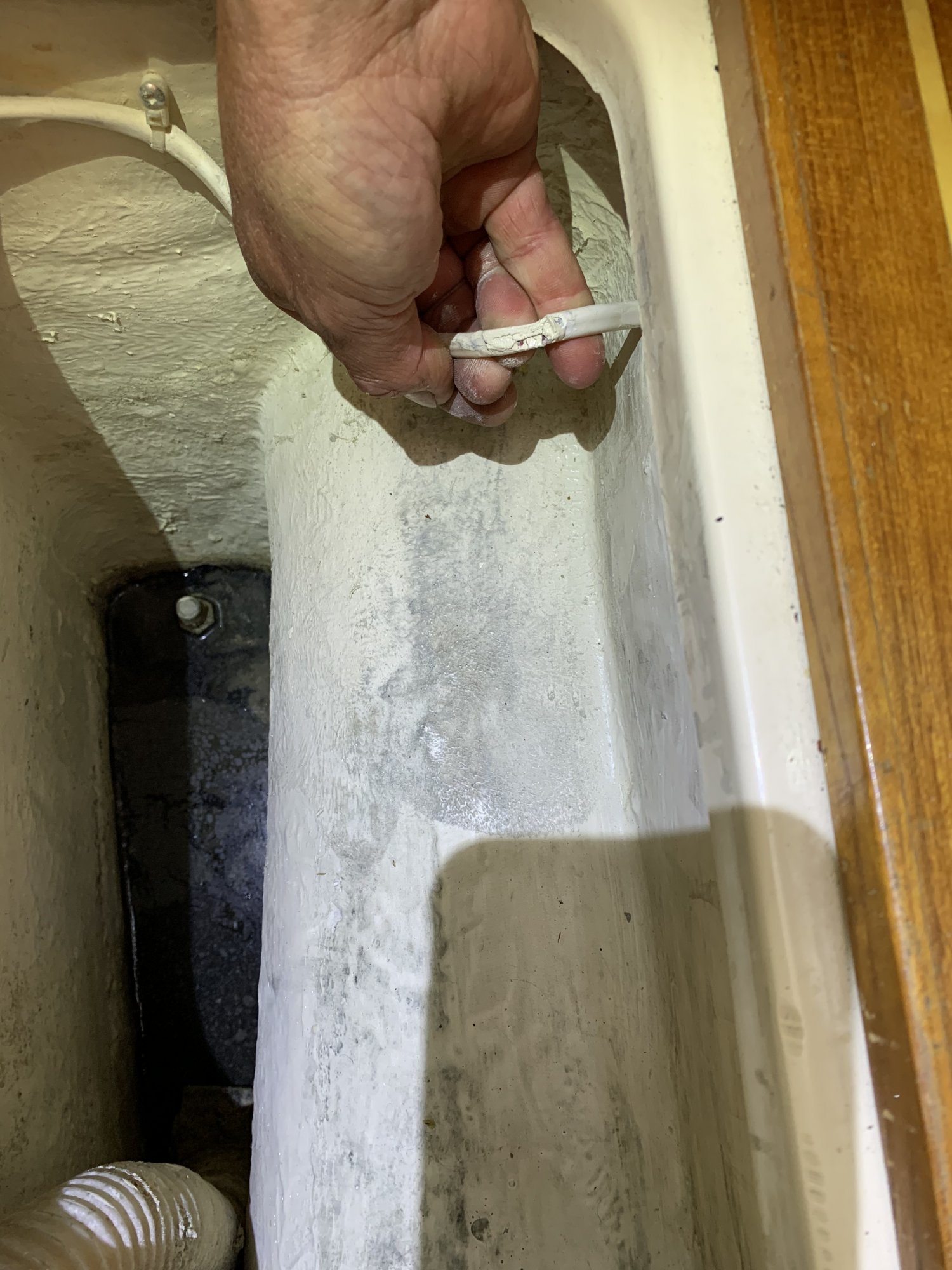

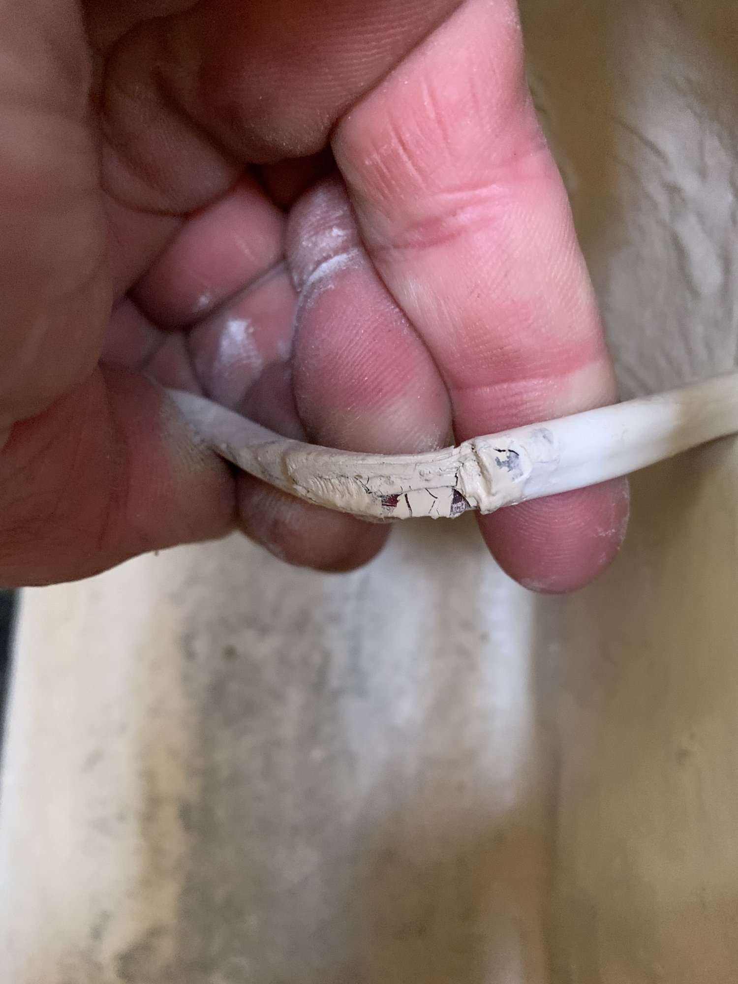

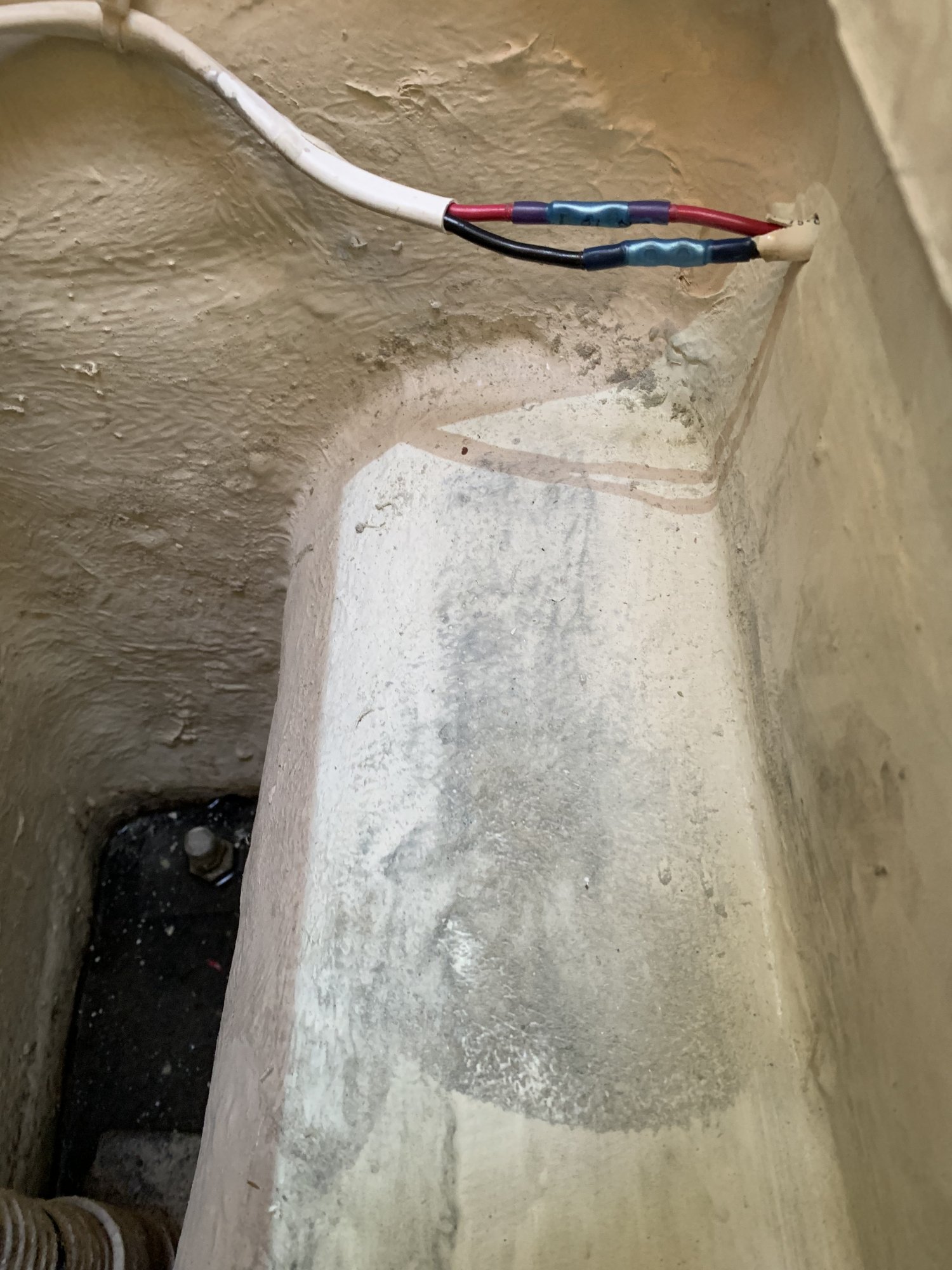

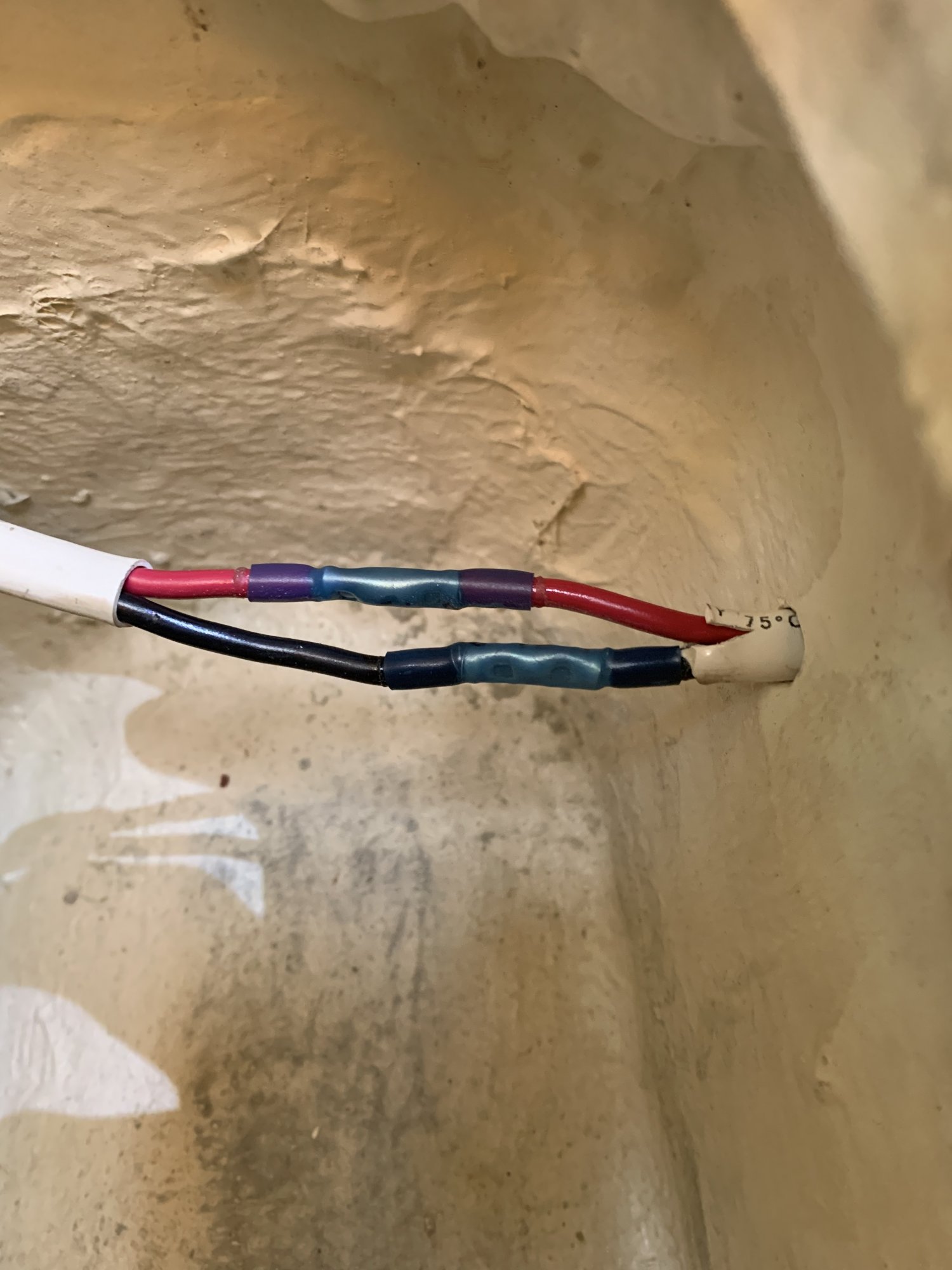

An update.

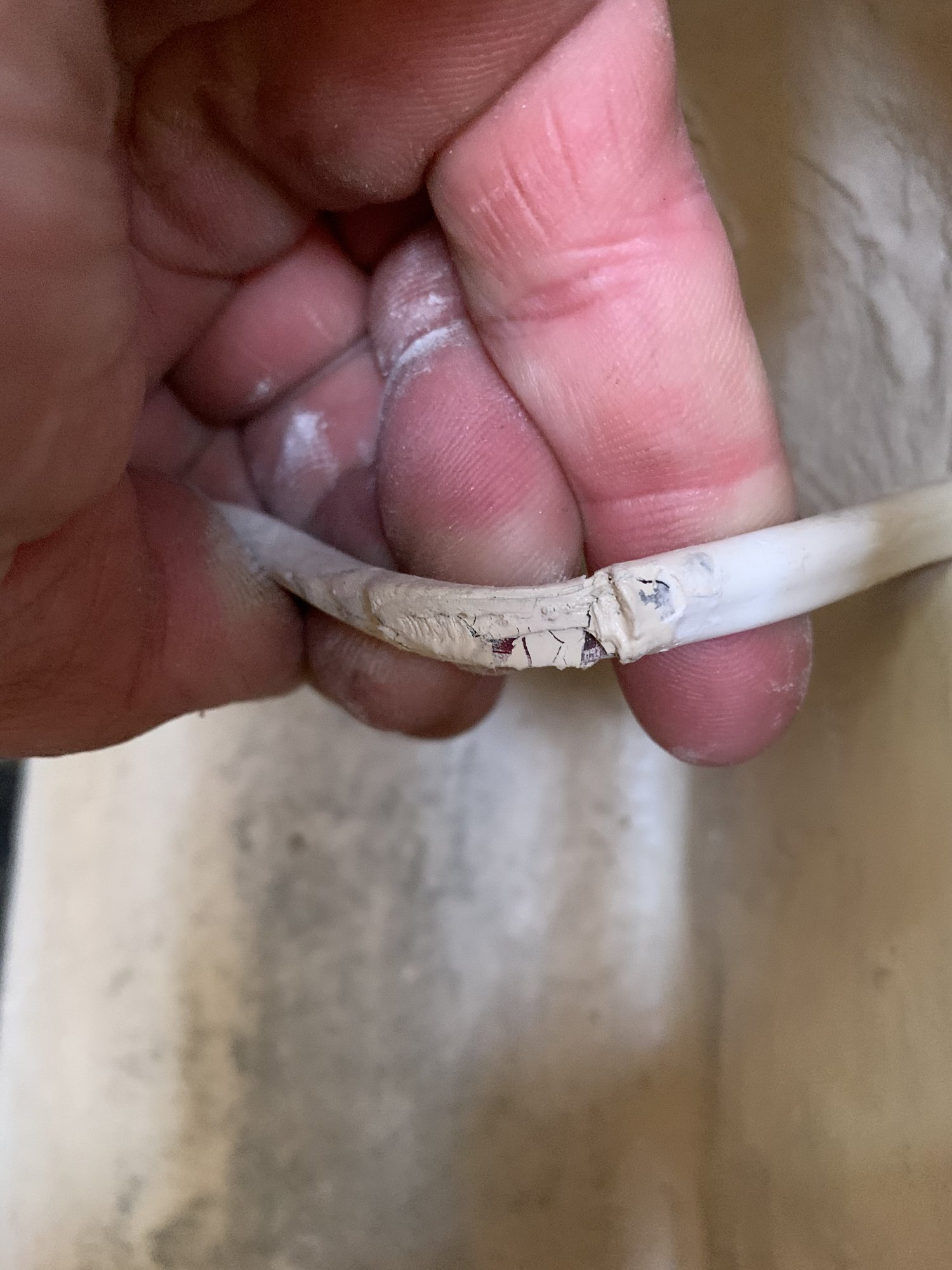

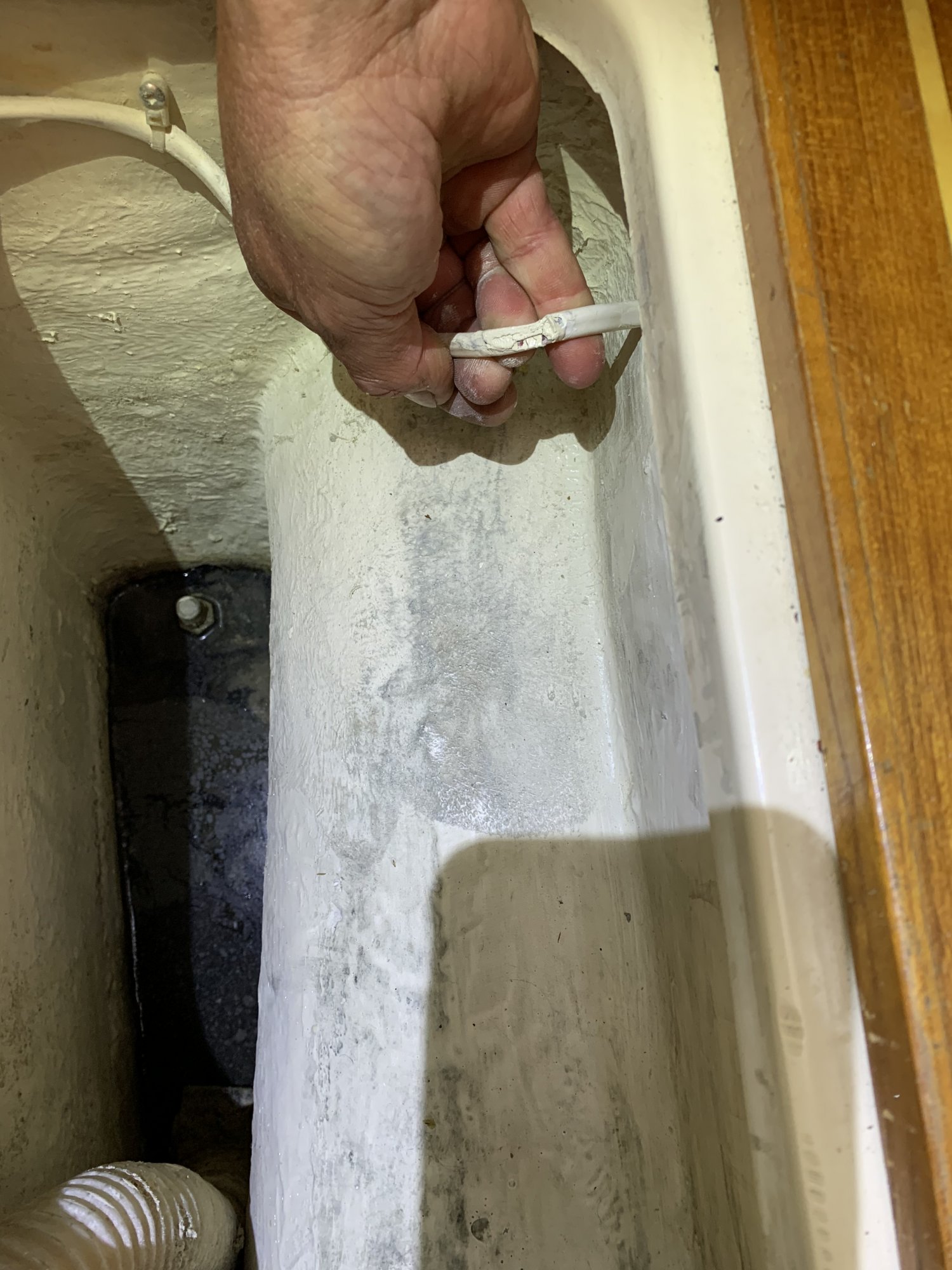

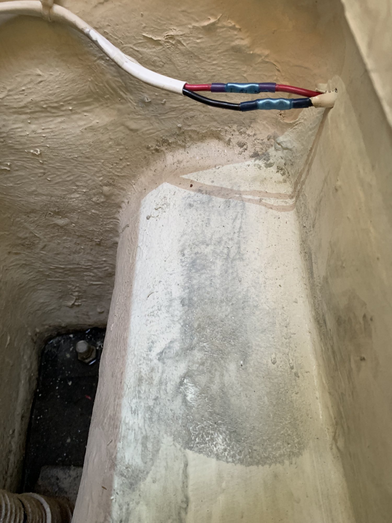

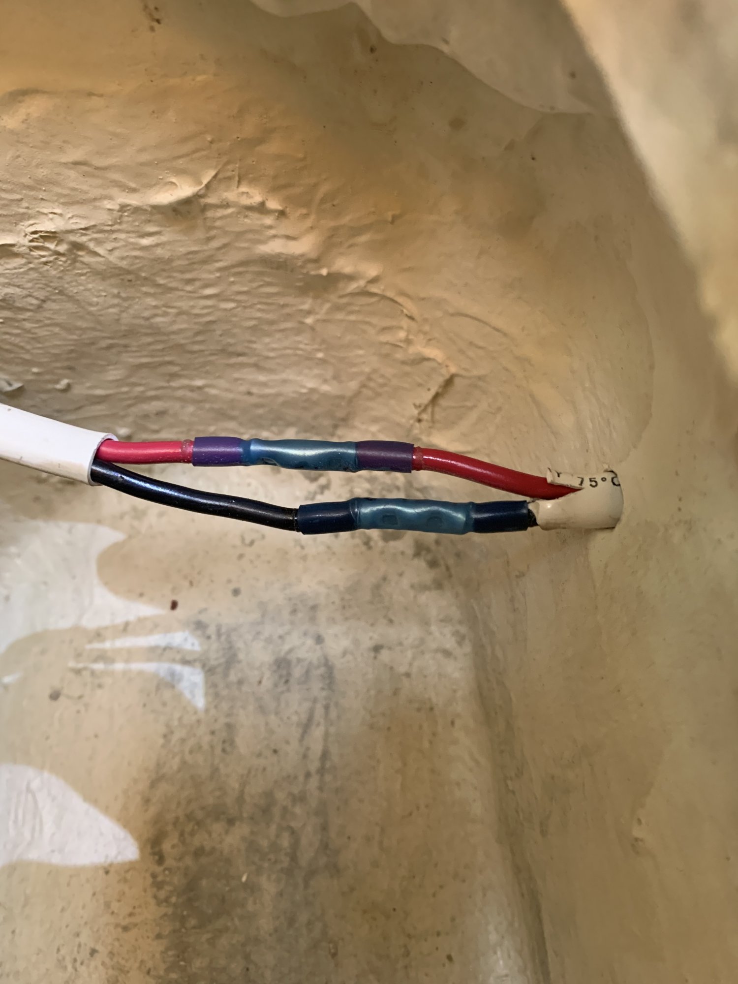

Thanks for all suggestions. I did discover that there was no power getting to the compressor. I’d had recent fibreglass repair work done under the floorboards in the bilge area. I did not initially link any of that repair to my refrigerator problem. Down to the bilge again to try and trace power wire to the compressor. I discovered that the repair had resulted in a skim of gel coat over a section of wire which had apparently come in contact with a workers grinder. In that dusty cramped environment I can hardly fault the worker for not noticing any damage. Fortunately there was enough slack in the wire to pull it to a place where it could be inspected and found not a break but enough abrasion to get through the wire coating and expose and fray the wires. Ultimately repair with splice was relatively easy.
l learned a lot and all your help was much appreciated.
24,616
It is always something...
Good thing there was enough slack wire that you could fix it without having to grind open the recent fiberglass work.

Apr 5, 2009
3,306
An update.
Having a basic understanding of how our electrical system works is a very important aspect of good seamanship. Glad you found it. Now the next electrical problem will be easier.
