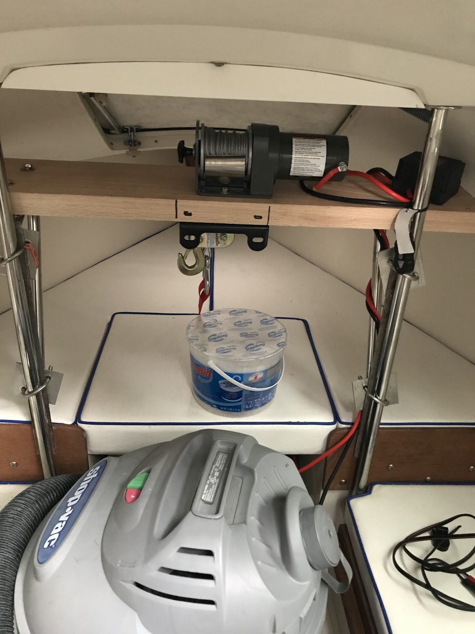

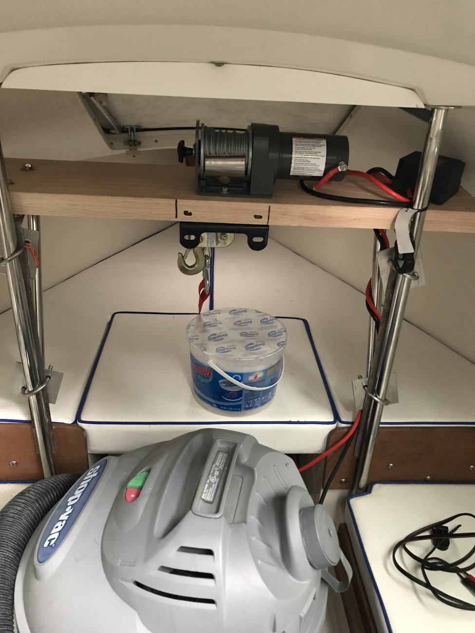

I love the Catalina 18 but getting a little old to manually Step the Mast. The Norther Freight 2500 winch did the trick. Mounted the winch inside the cabin and ran the cable to pulley attached to the front cleat. Really works well when stepping the mast for bridges and underway.
I attached the shelf using 2 swim platform braces attached to the cabin supports.
